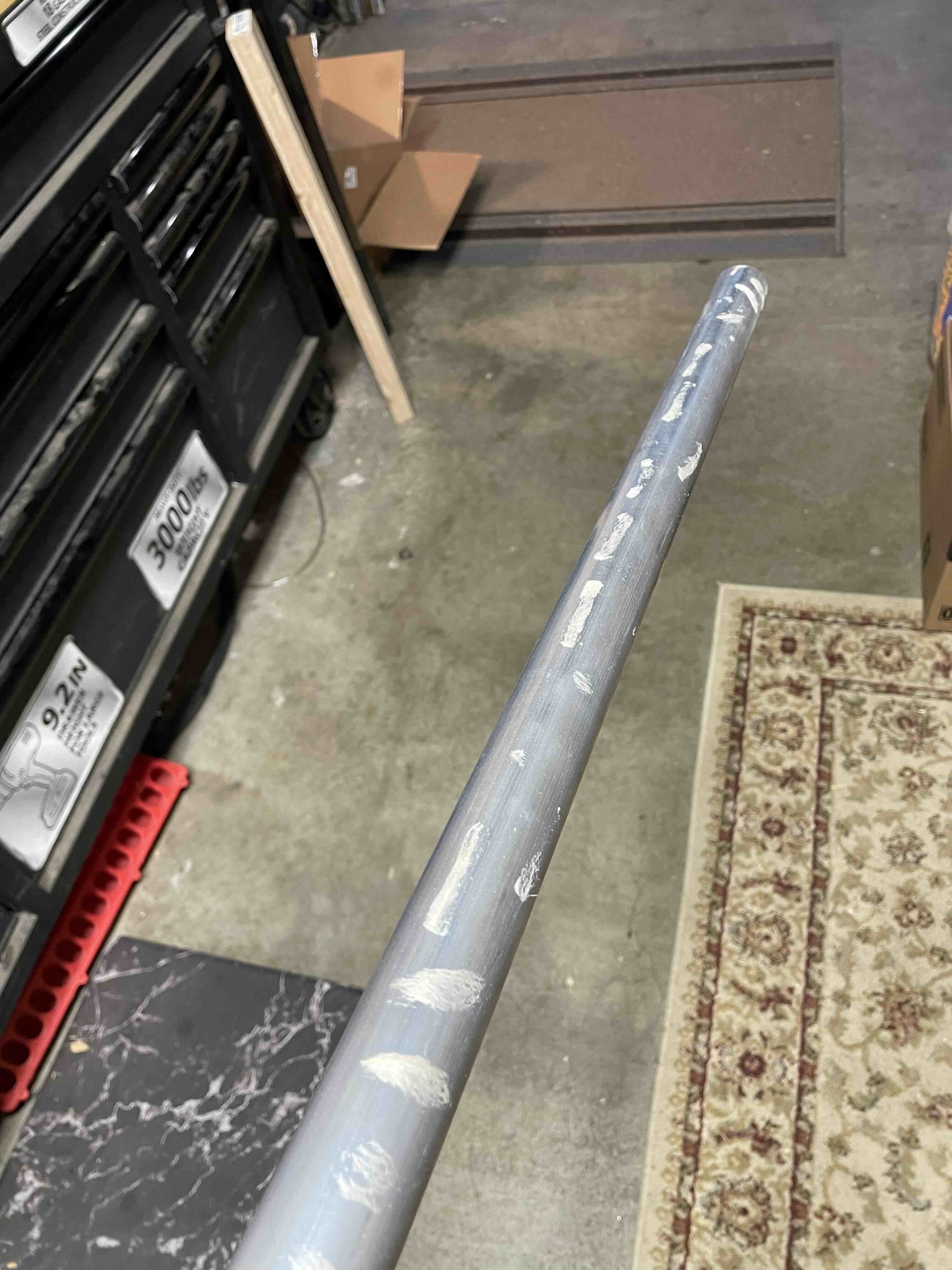

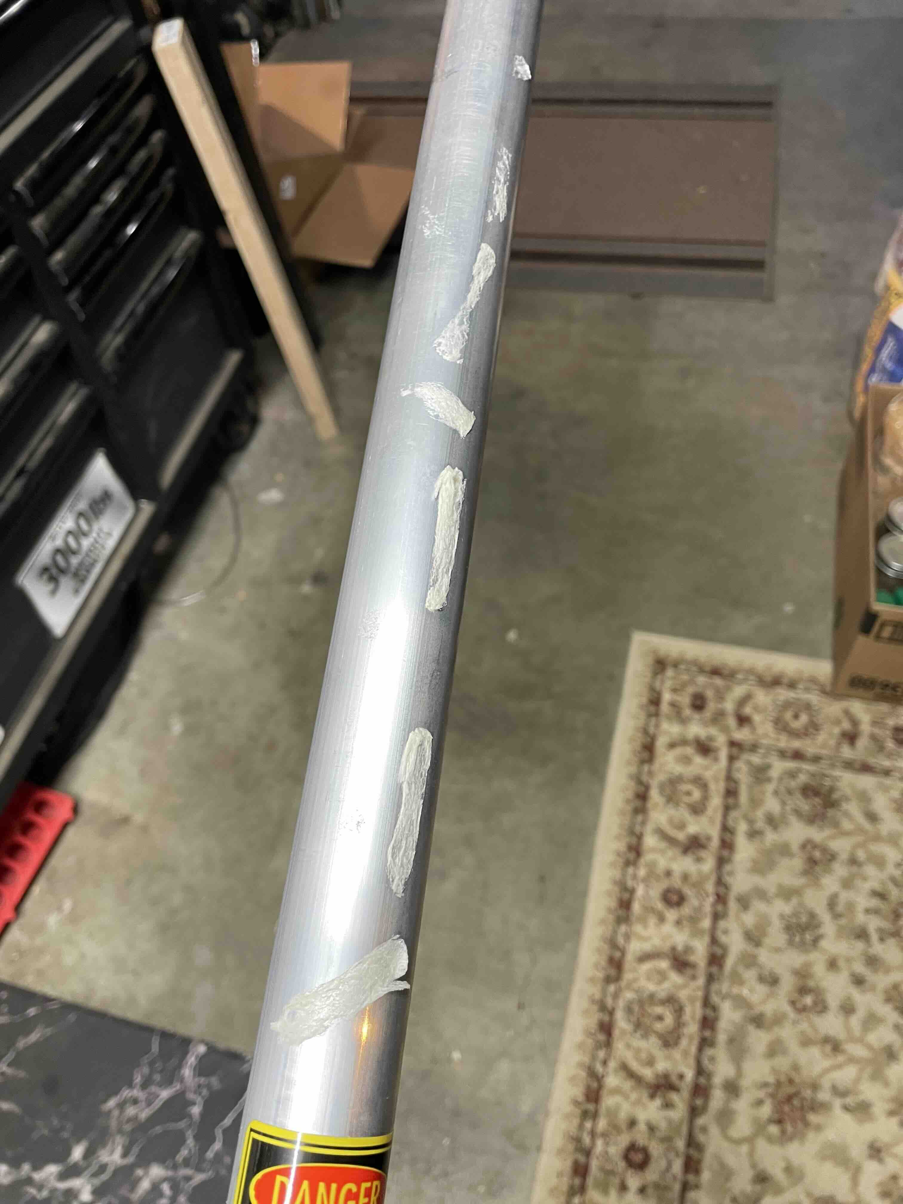

Trivial, yeah, perhaps.... But what torques me off is that somehow these peanuts weren't fully cured, and some were stuck all over the boom, and had to be peeled off. And they left some of their material on the boom where they were stuck, and I now can't I can't remove that stuff with the Acetone that I have here. Are they urethane perhaps ? What do I need to use to get this stuff off? Paint stripper maybe.
Anyways, when (if ??) I get this junk off of the boom (to where I can slide the element trunions on the boom, I too will try the (original) spacing in the manual, and post my findings analysis.

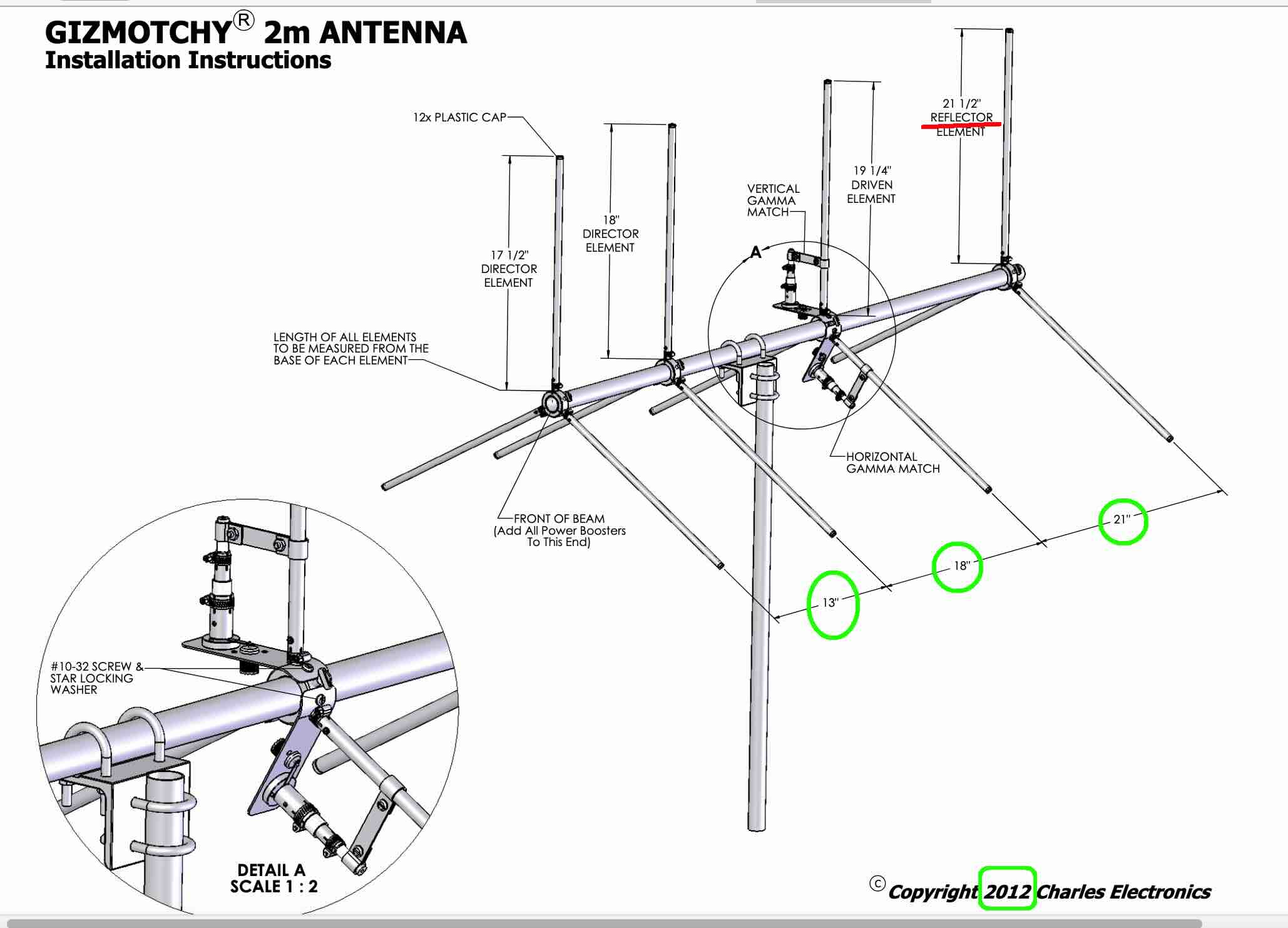

After standing back for a second and looking at the antenna it seems as if the spacings along the boom were backwards. Starting from the reflector out the spacings should be 13,18,21
Ok, after spending way-way-WAY too much time going down you guy's (Mole & DXER's) rabbit hole, and corresponding back and forth to Tom Charles who designed this antenna, the conclusion is that the above statement is dead wrong.
The correct spacings are in the current version on the manual Copyright 2012 as shown below, and from the reflector are: 0-21-18-13.
I will continue to assemble my new antenna with these proper spacings, and report back with my findings.
As far as the (urethane?) packing peanut residue stuck on the boom, no chemical(s) that I have in my shop would touch it, so I had to use steel wool and a LOT of elbow grease to get that off. There was a slight payoff in that it made the boom extremely bright and shinny (FWIW).
Did you use steel wool or stainless steel wool?
I used to work in food processing and have seen regular steel wool leave contamination behind that later showed crosion on both aluminum and stainless.
It's even worse on stainless, if you did use regular steel wool I would suggest you go over it with a Scotch Brite pad to remove any small particles of steel that may remain.
Jeff
Jeff
Wow!, - thanks, I did NOT know this!! I'll go over it real good with Scotch Brite + final clean with Brake Klean and a cotton cloth.

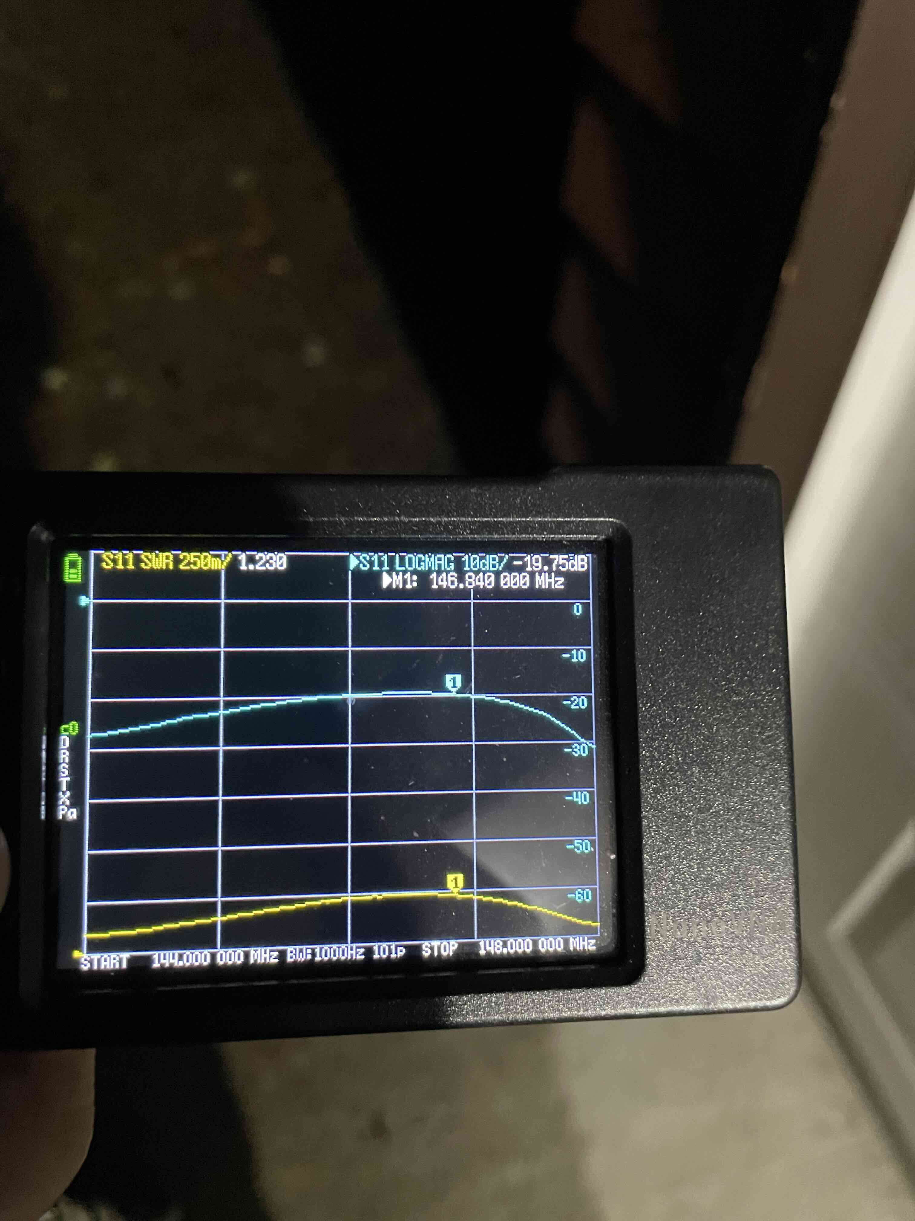

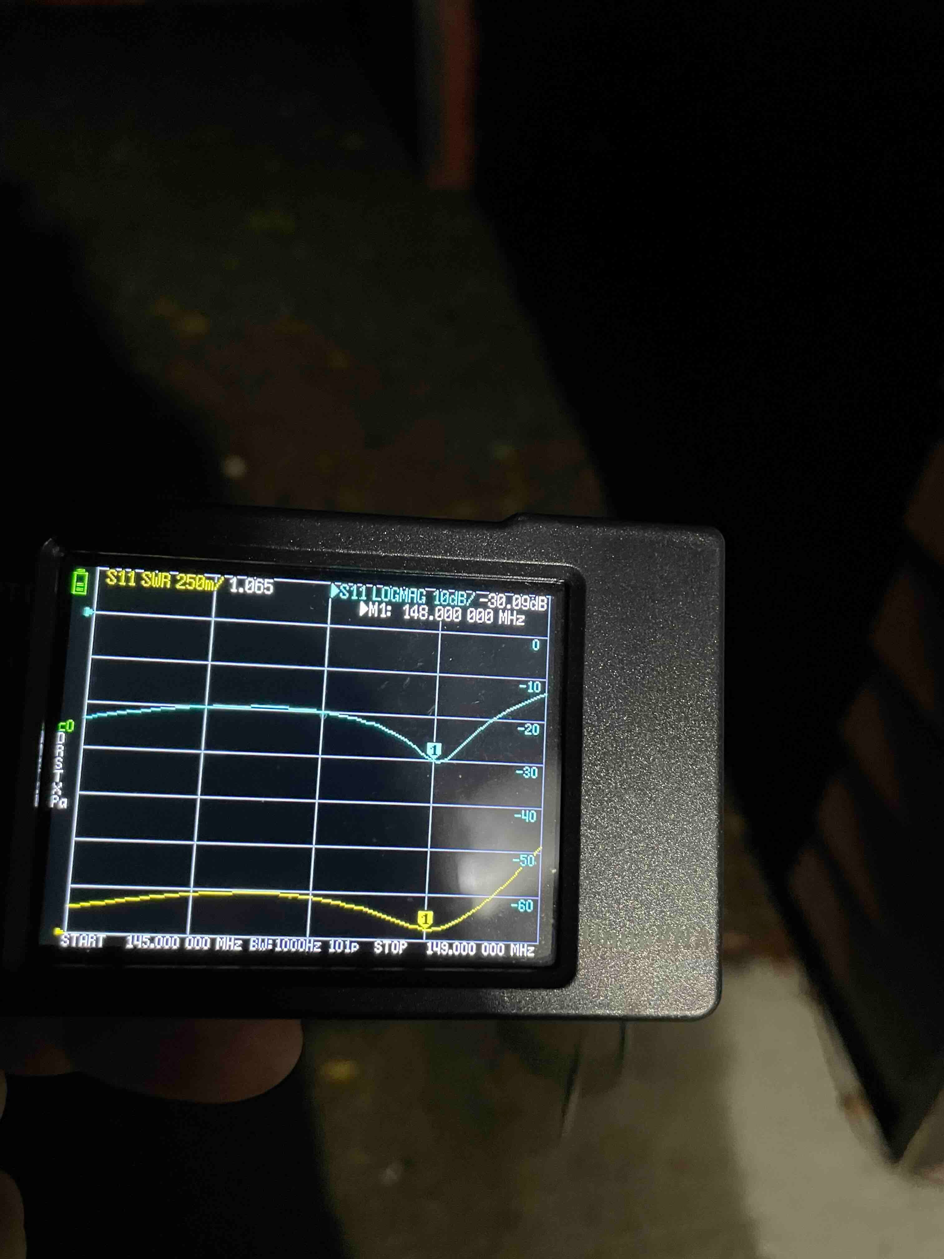

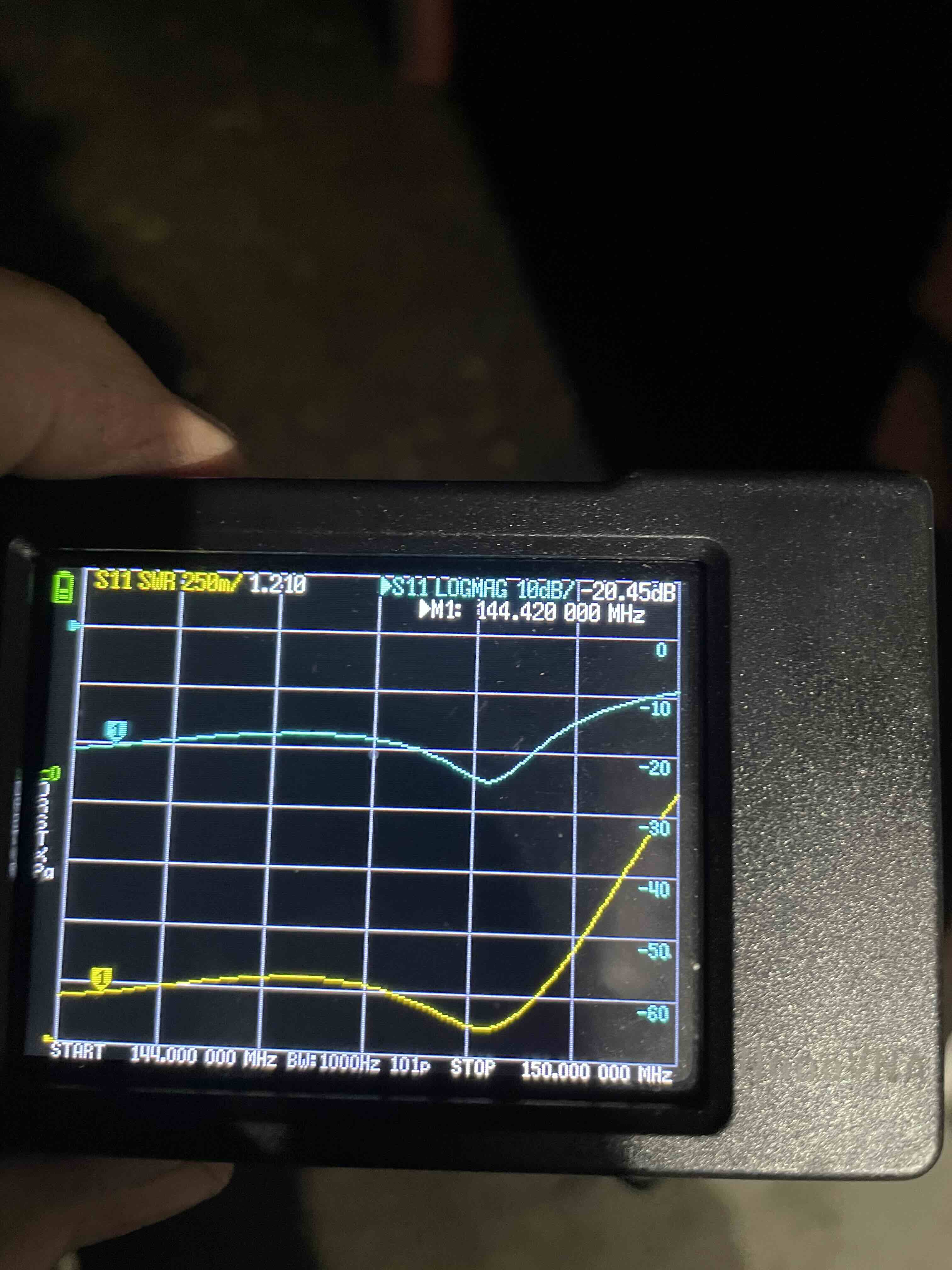

Update:

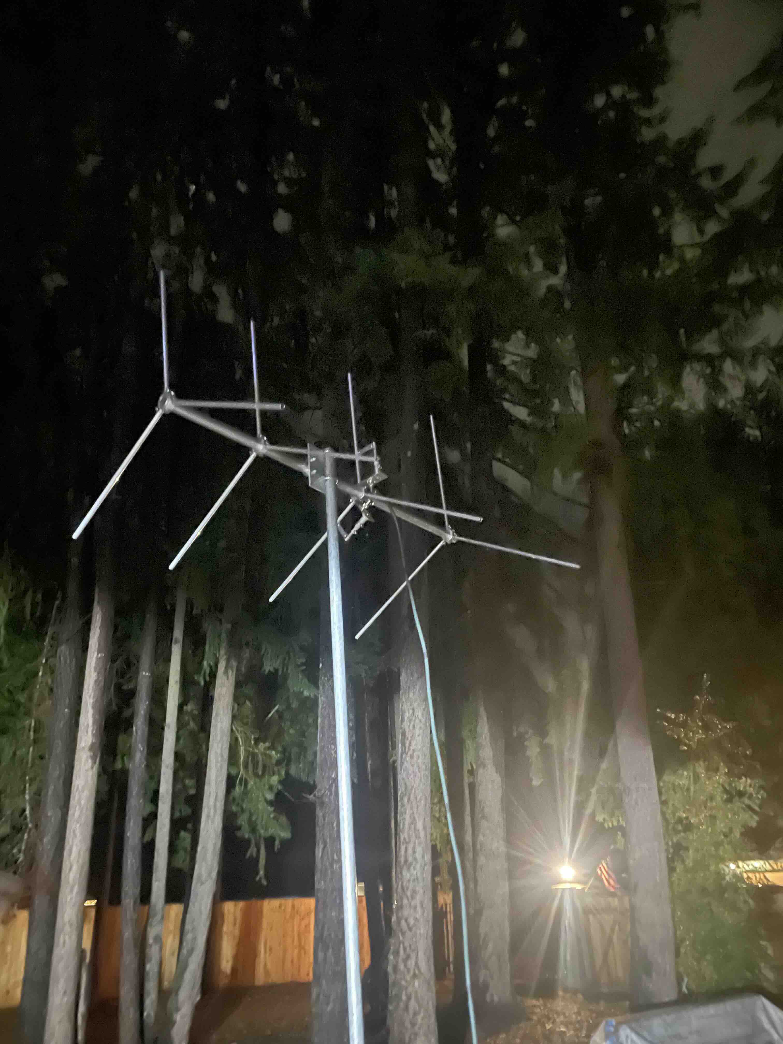

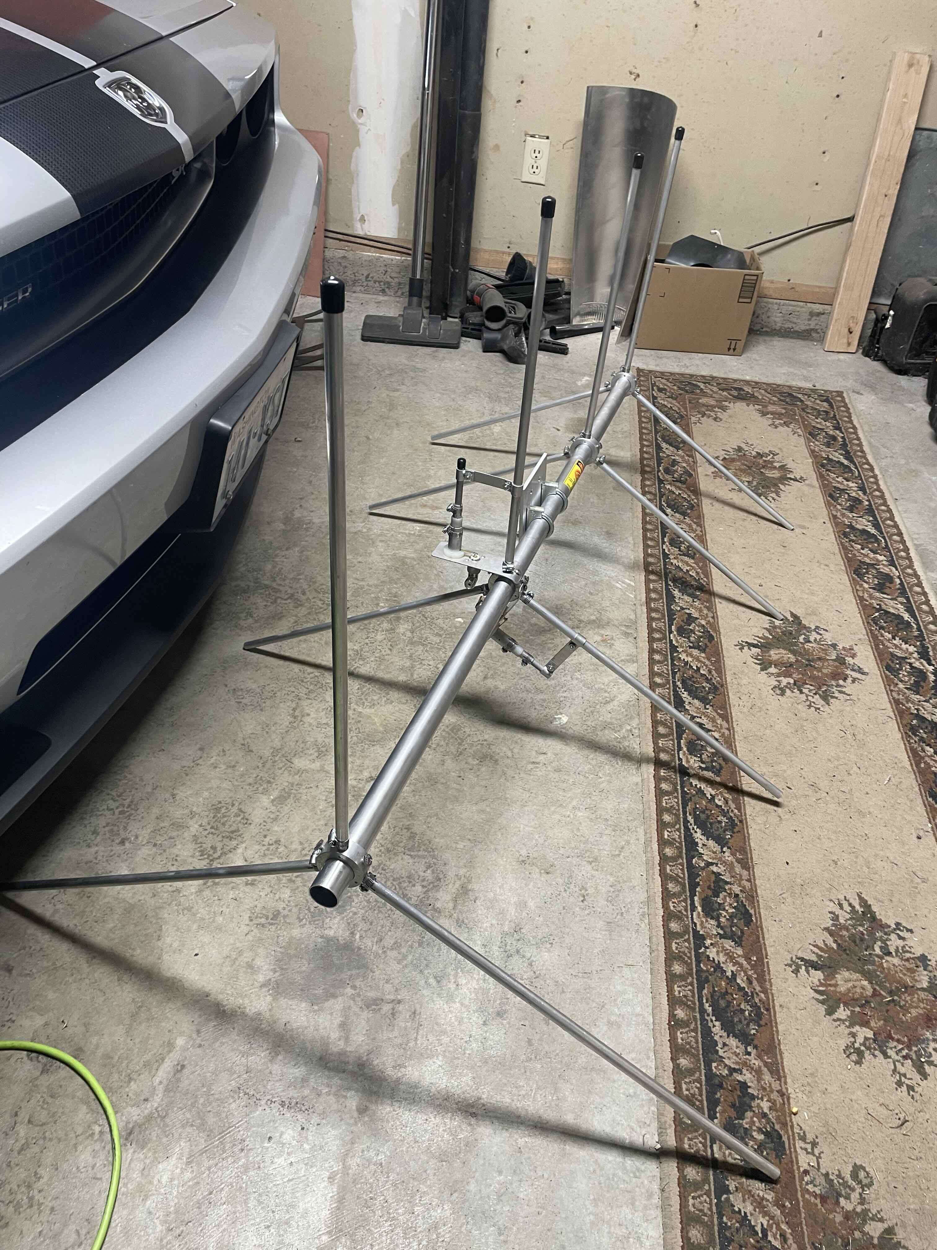

I finally assembled my Gizmotchy 2 meter beam, and I am impressed !

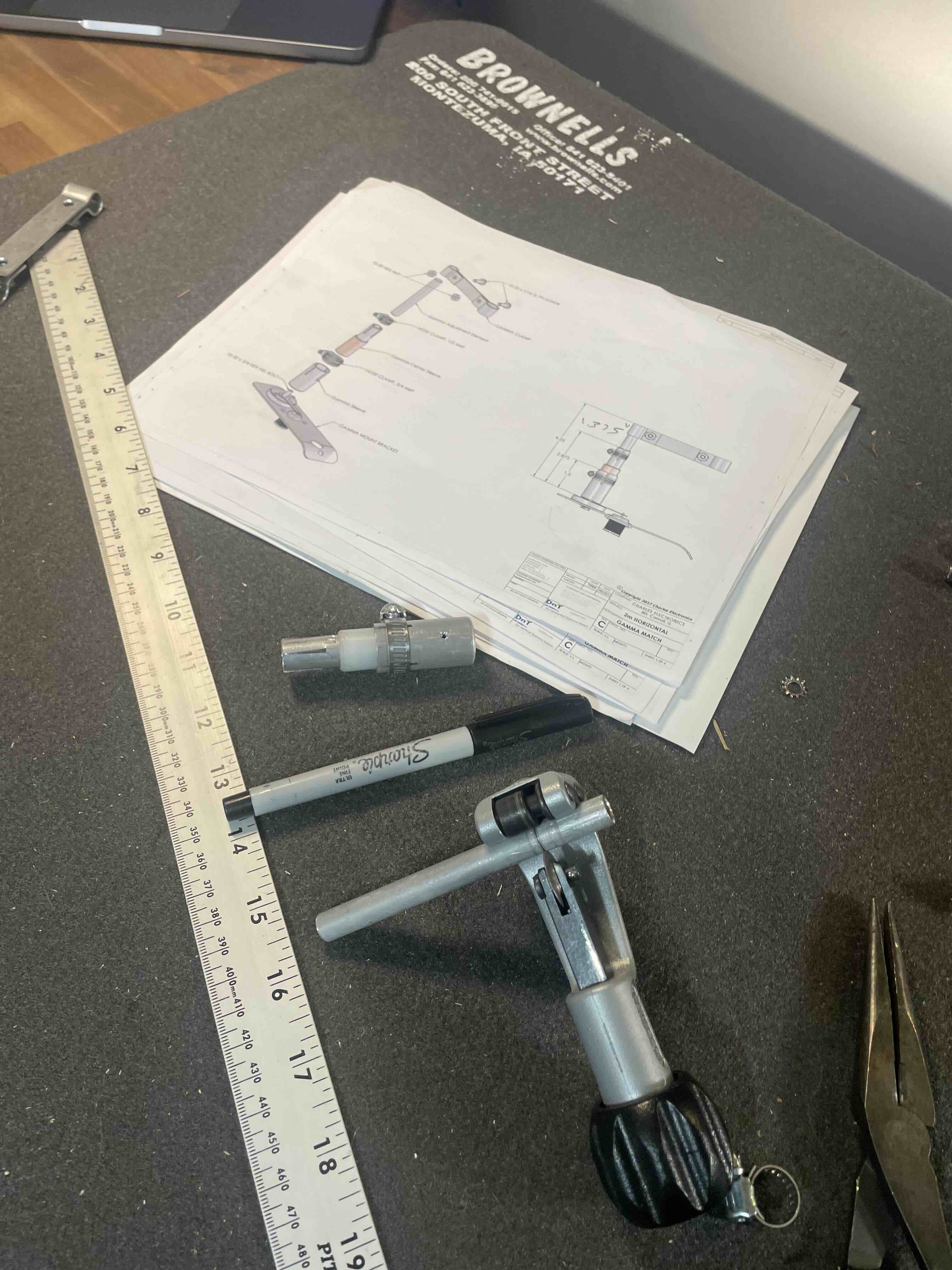

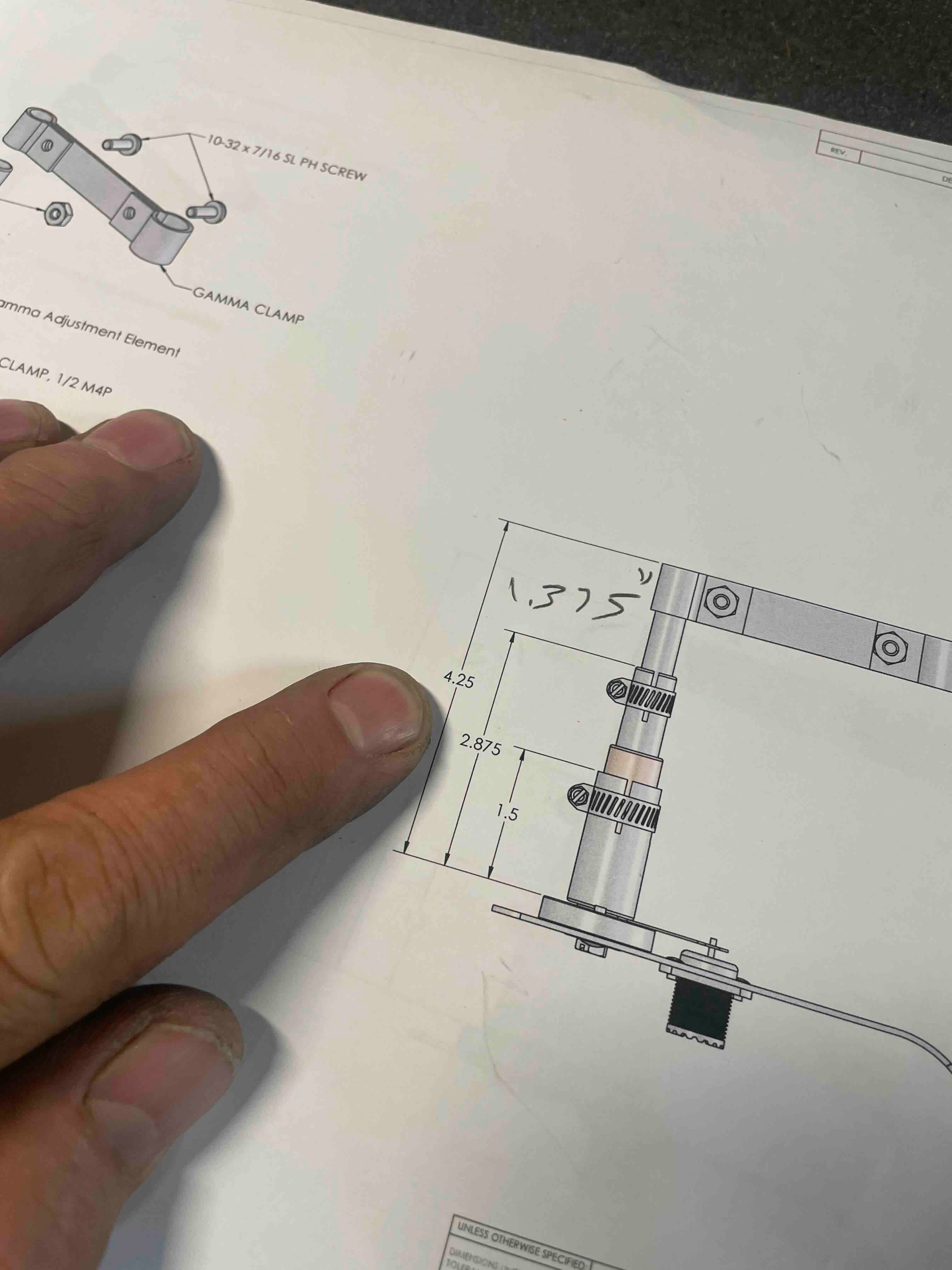

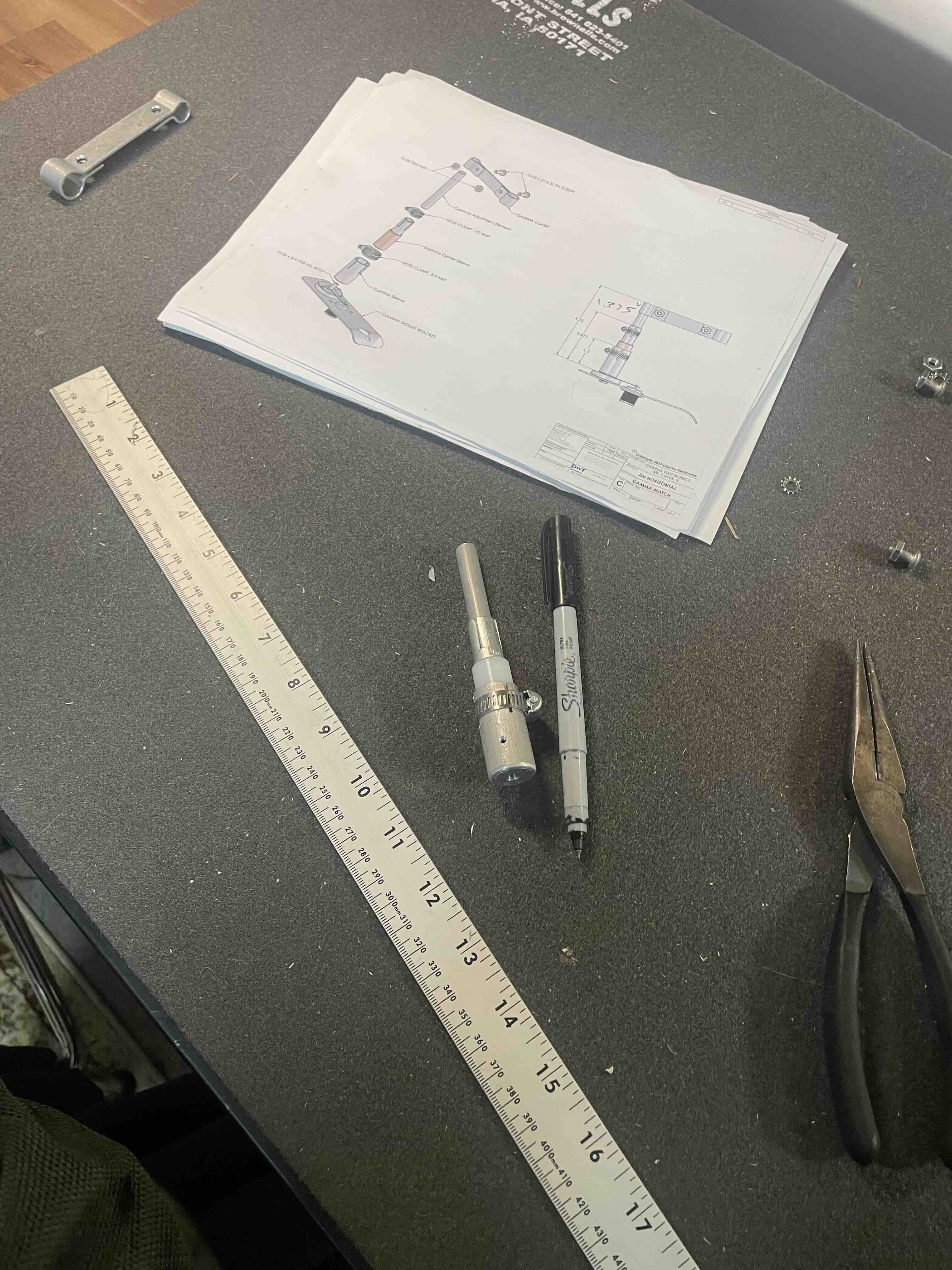

I have some minor complaints about the parts shipped, and Tom's e-mail followup on them, but I *think* I got them worked out. i.e. them shipping two 4-inch Gamma tubes instead of a 3-inch and a 4-inch tube.
Tom said not to cut them, but I ended up cutting the 4-inch one for the Horizontal down to 3 inches like the instructions show. If you try to use one of the supplied 4-inch gamma tubes for the Horiz Gama match, and try to set it up for the dimensions shown in the instructions, it will bottom out in the Gama sleeve, and it will short out !
But looking back on it, if the instructions were better designed, they could have mentioned to be careful not to bottom out the new, longer 4-inch gamma tube for the horizontal Gamma match, and just to let the excess length extend beyond the clamp strap for the driven element. So i'm unhappy about that part :(
What I *AM* happy about however, is the quality of the workmanship of the thing. It was a true joy to assemble. I was impressed the mechanical design of the Gamma match (even though I'm P.O.'d about that 4-inch tube shipped instead of the advertised 3-inch tube).

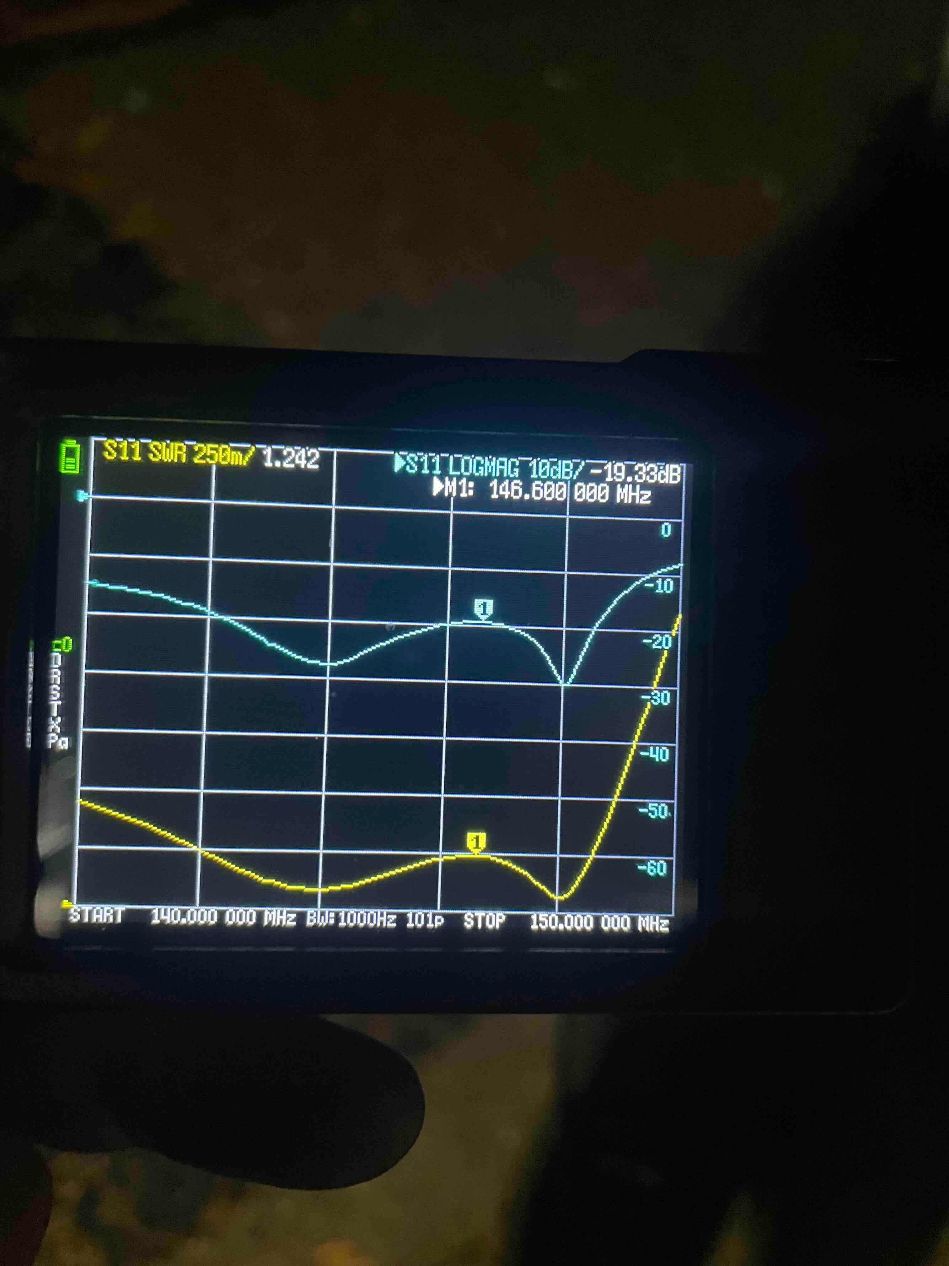

What I'm *ALSO* impressed with, is how lucky I was with the SWR's !!
With the measurements in the instructions for the Gamma match(s), my SWR's from 144 Mhz to 148 Mhz were lower than 1.3 : 1 (1.29 being the highest actually).
So I *might* tweak with it a bit, but it looks so good the way it is, I might just leave it alone.
Take a look at some pic's I took tonight !

Update:

The instructions with the strange spacing WILL result in a flat SWR. But as we showed when modelled, the gain and rear rejection leave a lot to be desired. As I noted earlier, if you respace it in a more traditional way, you will have to make some adjustments to the element lengths. But the modelling showed what the payoff is.
