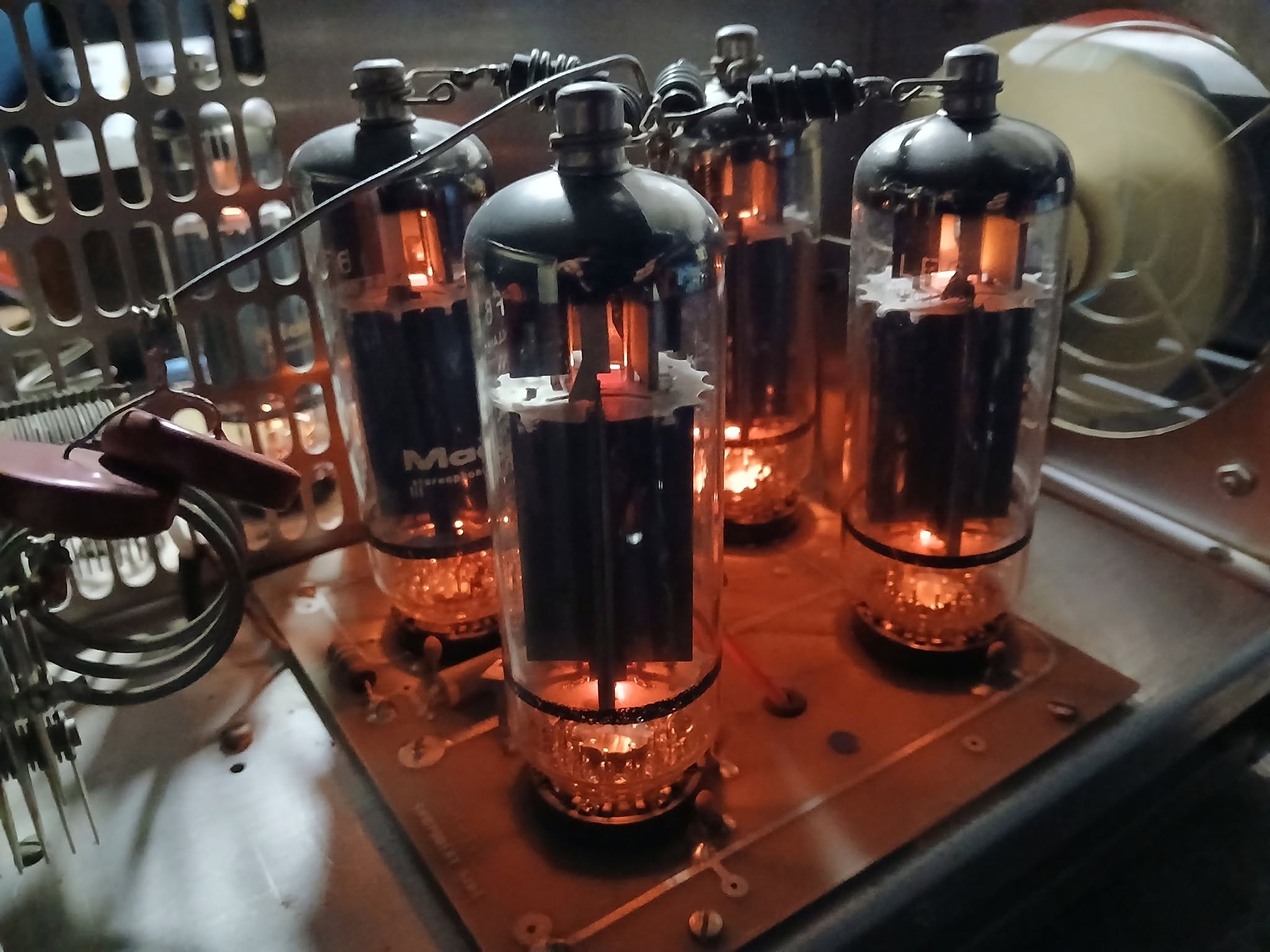

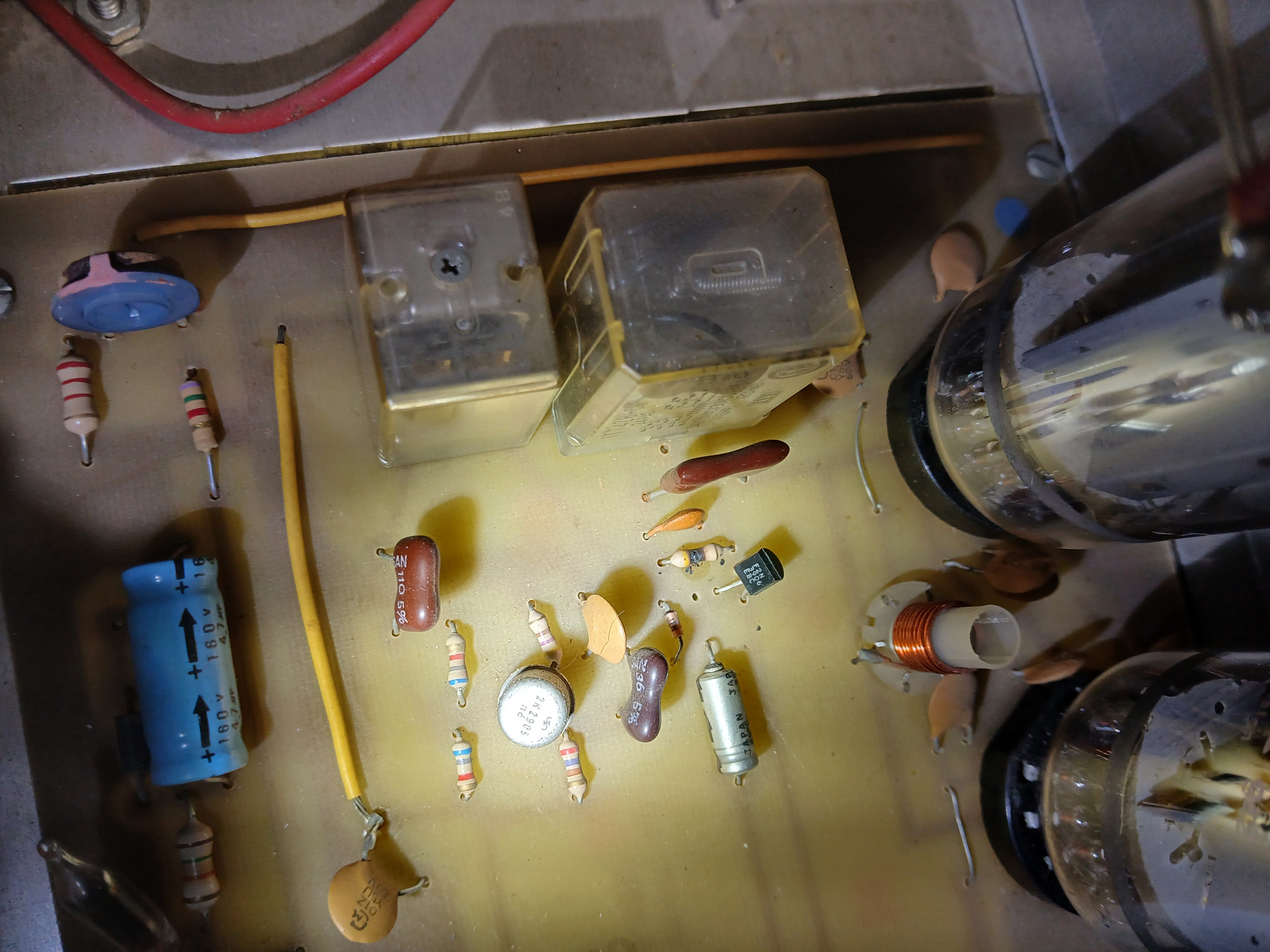

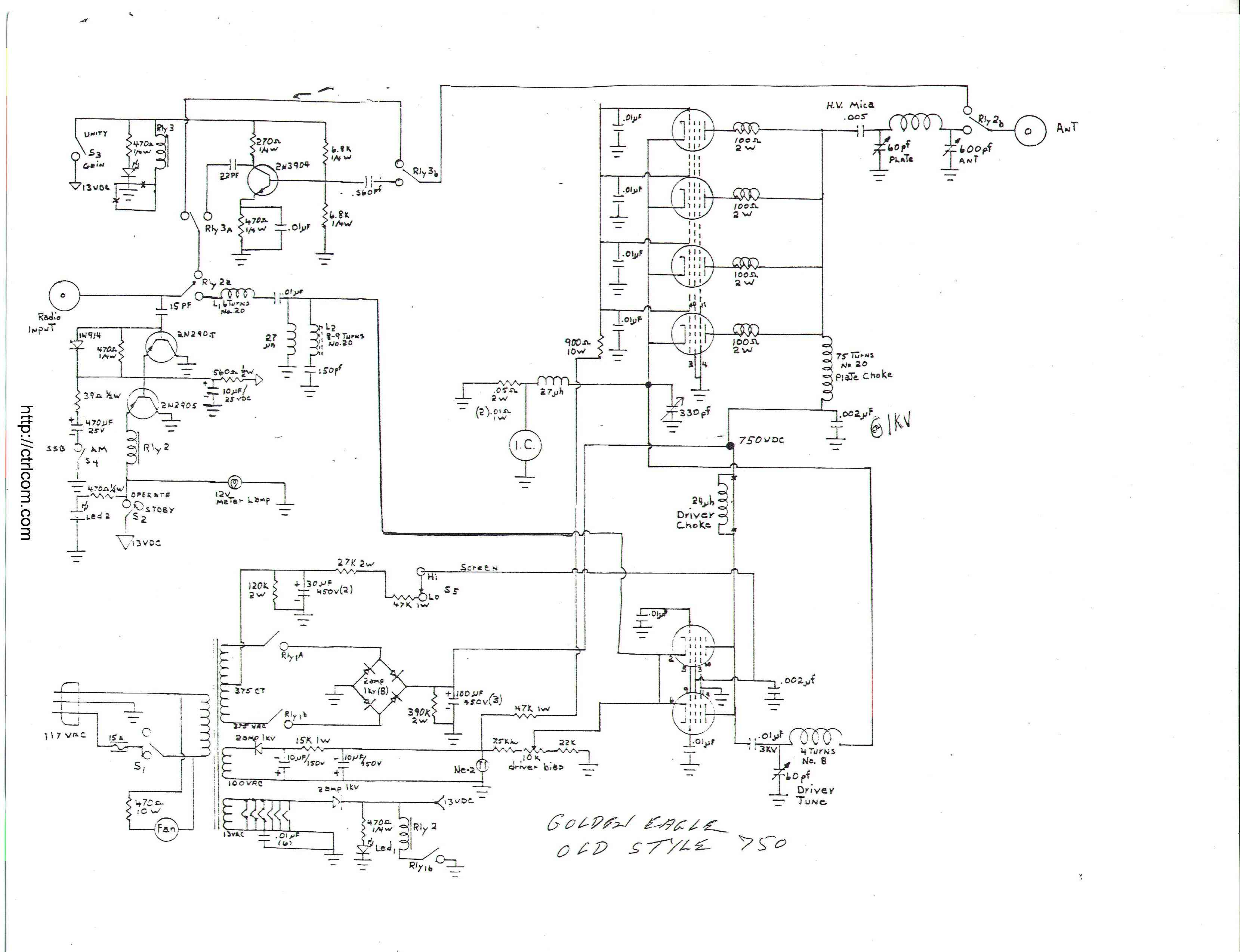

Trying to find out some info on this amp. It's a golden eagle 750 with 27LF6 final tubes. It was given to me. No RF out all 6 tubes light up. There is a burnt looks like a 47 Ohm resistor next to a black transistor but I need the schematic which I can not find online anywhere. Can someone help me out here? Thanks You

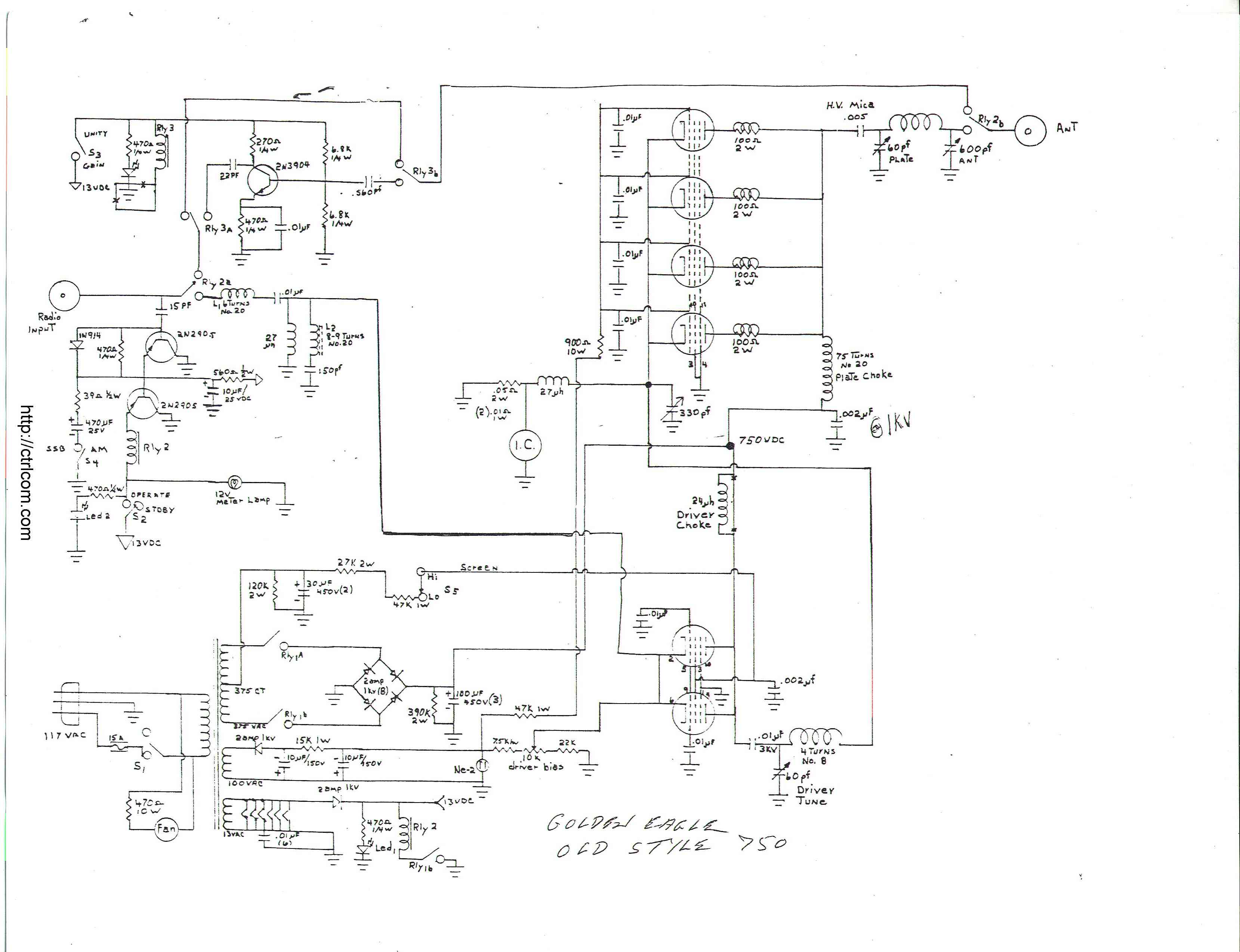

Here's the schemo for the "old" version, without the string of NightRider lights along the bottom. Should be similar.
thank you so much mr nomadradio. I have no RF out so I'm thinking the 470 ohm or 47 ohm 1/4 is burnt and the 2N3906 next to it might be bad. That schematic doesn't seem to match up to what I have. That transistor next to the burnt resistor is a 3906 and the schematic shows a 3904 there. Do you know the max input watts on this amp? It has no SSB delay and I talk on SSB most all of the time.
UPDATE, I replaced the 2N3906 and the 470 ohm resistor. Radio still has no RF output. I must have a bad tube. Maybe a bad driver tube.
