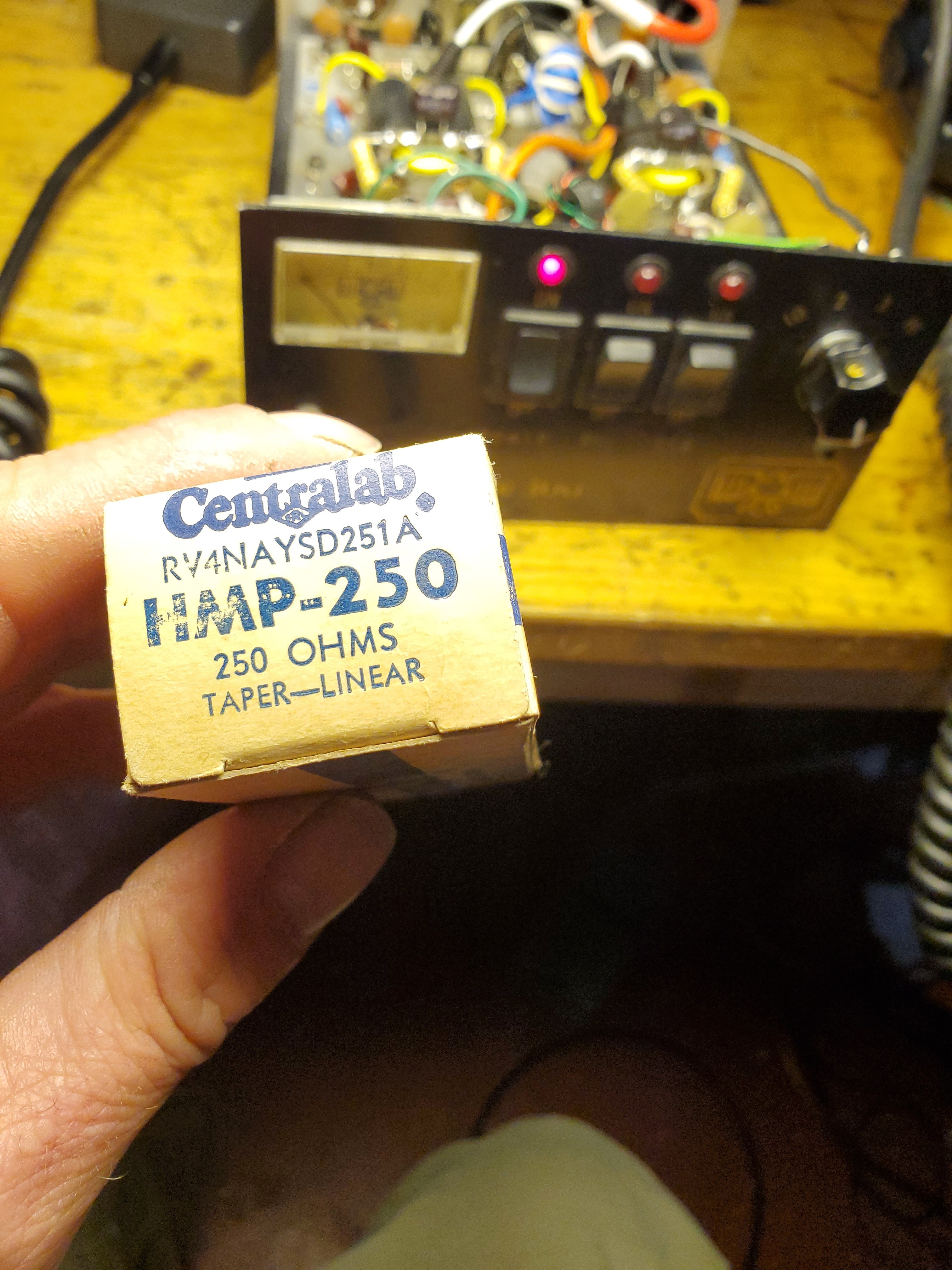

Hi all I have this Golden Eagle 300 that I would like to replace the variable potentiometer on, I feel the one that is in the amplifier feels gritty when turned all the way up and am pretty sure it has been replaced before and am not even sure it is a suitable one. I haven't been able to find a schematic for this amp so I am not sure what ohm rating of pot I should install. Also it looks as if the original was probably a 3 position rotary style pot and that would be nice too. Anyone have any suggestions on this ? Thanks
The old control should have some markings that reveal its resistance rating. Typically three digits in the same format as the three color bands on a fixed resistor. A 250 ohm part would be "251". A 100-ohm would be "101". The letter "B" either before or after the three digits indicates a linear-taper control.
RV4NAYSD251A is what was on the back of the control, I guess this is supposed to be a 250 ohm pot but when I put the multimeter on it read pretty crazy and there is a bad burnt spot on it so I ordered a new one and hope for the best I guess. I will try to get some photos of it on here soon. I took the metal cover off the back of the pot to get a closer look. Thanks fellas

The new pot came in and I installed it, the amplifier appears to be working good 20251112_182817.jpg
Rock on! Gotta love it when a plan comes together. I usually recommend turning the control to full power and setting the carrier with the radio's carrier control. The pot becomes vulnerable to burnout only when it's turned down, as a general rule.
Yeah, I tend to not move them either Nomad, especially on Texas star boxes. Thank you
