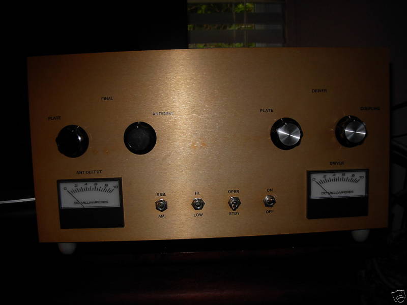

I have a Golden Falcon big base amp, with no tuning instructions.
A little history on the amp - first. It was made in the San Jose CA area -back in the day- by a man named Andy Anderson. Not sure if he's still around - but they were a great amp. Untill -I think- the FCC or "Uncle Charlie" (we use to call him) came a'knockin...
Anyway; does any techie know the proper tune method to tune this monster? It uses ten 8908 tubes. 1 drives 3; then the 3 drive 6 more. There's 4 tuning knobs - 2 for the driver section that say "plate" and "coupling". Then 2 for the final section that say "plate" and "antenna". I've tuned all for max output.
Has good output.
The amp puts out around 1400-1500 PEP/SSB on my LP-100A watt/SWR meter.
Very close to that on AM too.
So with that; who's the expert here?

Looks like it could use a little clean up - eh Jon?
I heard you talking with iit yesterday on 38/LSB - verrrry punchy...

yes its been sitting awhile but its output amazes me 1800+ watts after proper tune up i just wish i could hear you better thanks for the pics jon.
Well, I am running a barefoot station. I live in urban sprawl; which means I would get noticed if I ran any more power than I do now. The Magnum OmegaForce is good for 8-60 watts PEP, and makes the skipland trip well as it is.
You were making it out into the Santa Clara Valley 5/9 yesterday on this MONSTER/AMPZILLA!!!

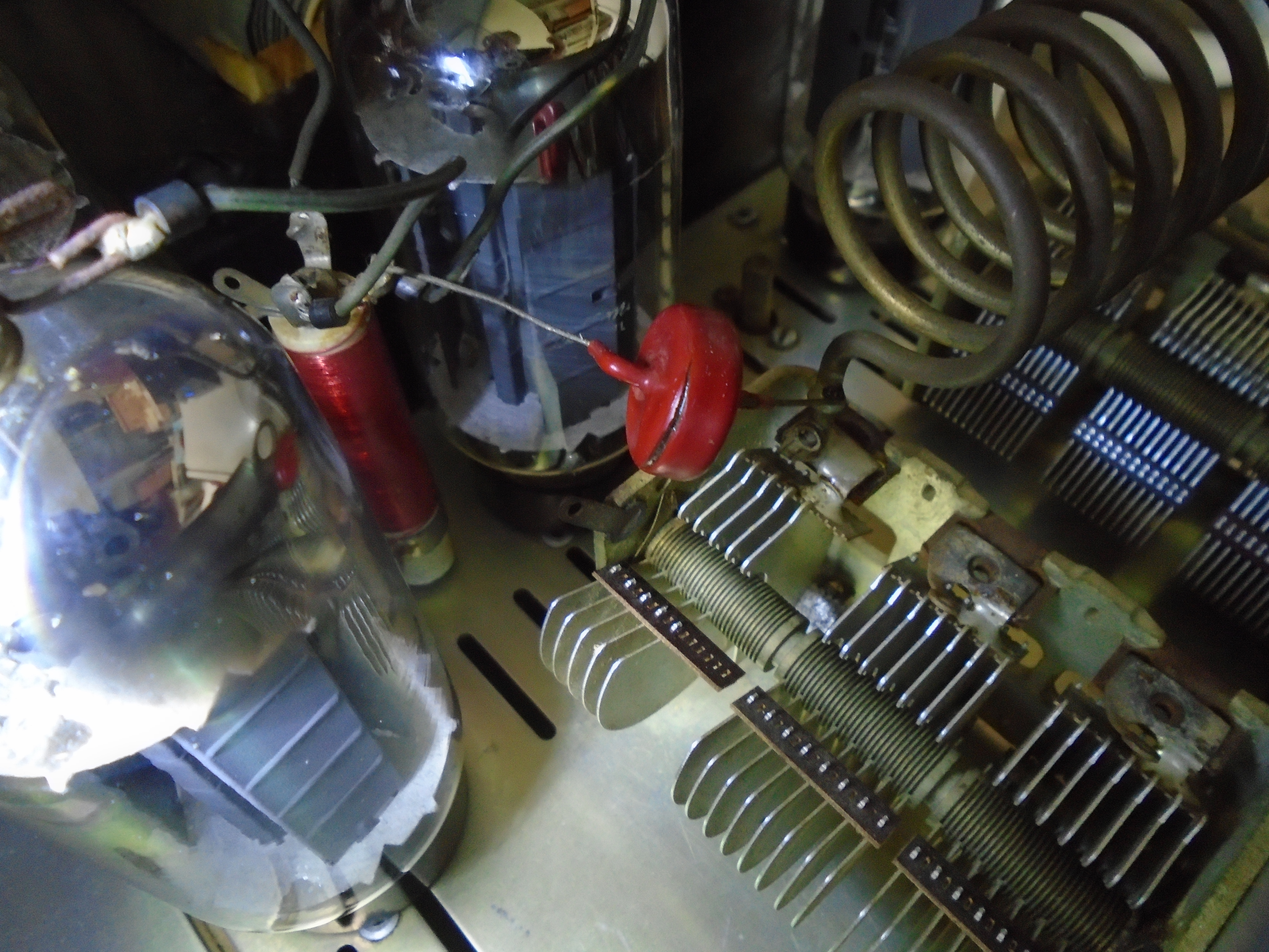

Hello everybody I have a question on this Golden Falcon 10 tube amp with 8908 tubes Is there a video some where that shows you how to load it up the right way? I have no tuning instructions also I am looking for this part for the amp .I think it is a blocking cap I have no paper work for this amp. I was told that this is a 000pf 5kv door knob. It's the hi volt blocking cap.and a .01 disk cap 3kv will work. anyways I need this part if anyone knows where I can get it thanks for any help
