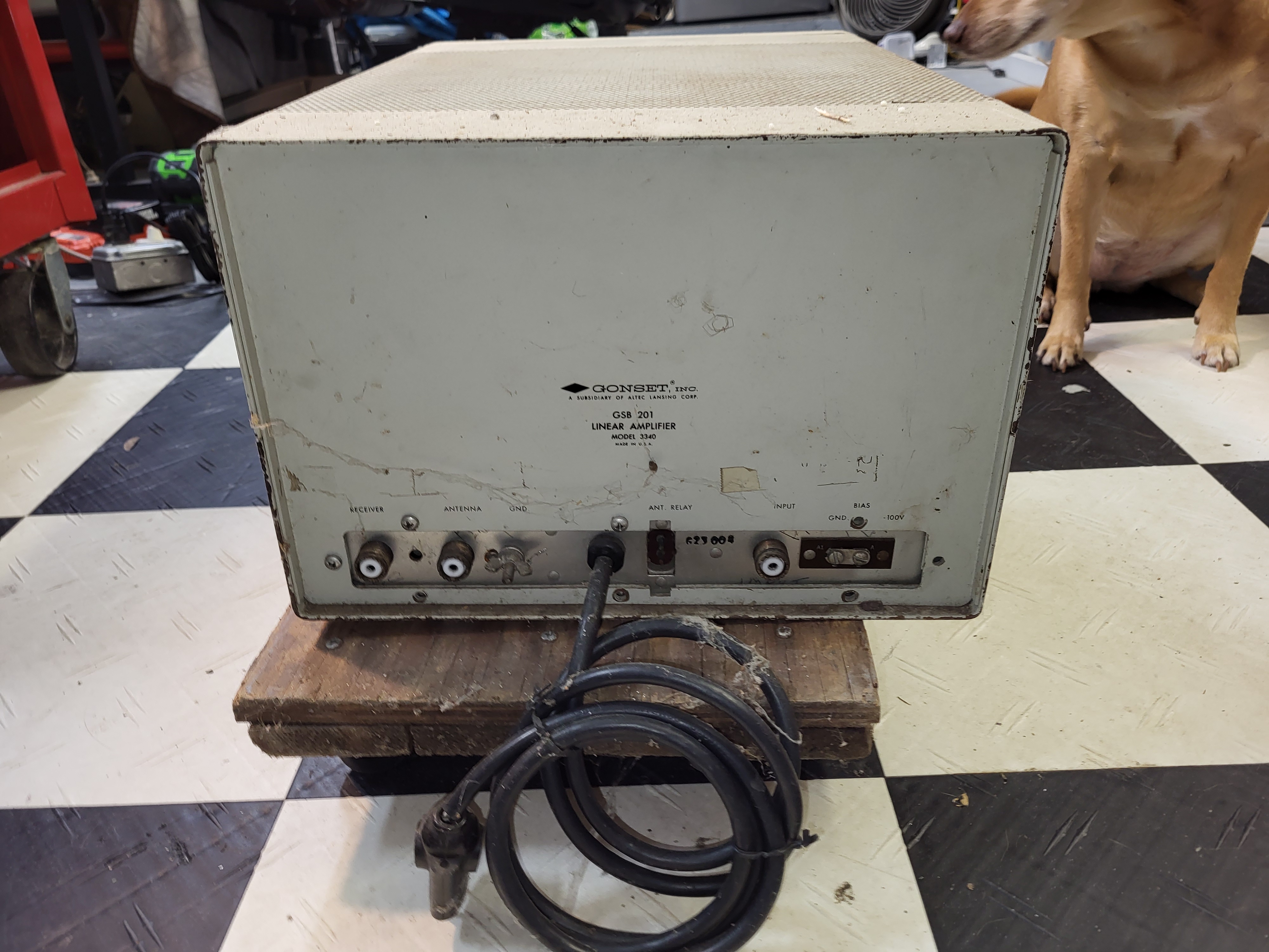

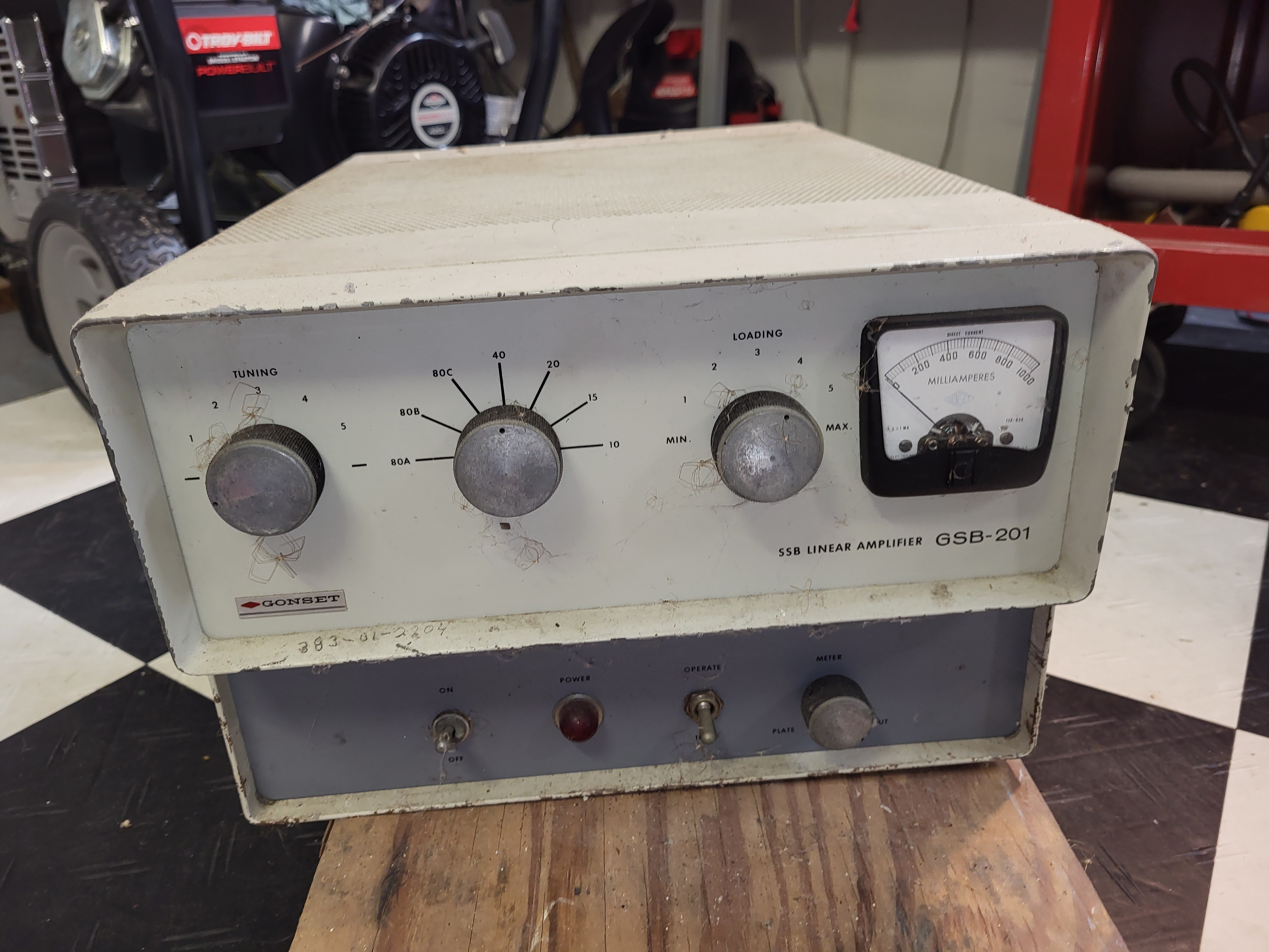

YEARS ago, (1995 I think), I picked this old girl up at a local tailgate, and it came with the original manual. I traded an old Kenwood TS-7500 2 meter rig for it. As you can see in the pics, this amp was very rough, but I'm just attracted to 'old iron'. And at 81Lbs, this sure fits that bill just fine. I brought her home, hoisted it up on my heaviest bench, and brought it up on the variac. I recall that I got around 400W full-drive from it before backing away from it. While staring certain death in the face the whole time, I didn't want to "push any envelopes"... I was SO afraid of it after a day's worth of tinkering with it, that I built a sturdy dolly for it, and wheeled it under the bench, never to see daylight again.... Until today.
I'm sorry, but this is truly going to be a "saga", y'all., to be updated as I make any progress on it. But it's a flat mess. I plan to not only get her chooching again, but I intend to modernize the circuit as best I can as I go. I'm documenting this process here because I'm sure that if I'M willing to do this, there are other radio heads with these sweet old boatanchors under their bench. So let's do this!
I just hope my skill level is up to the task!
Here it is, in all of it's present OEM glory. I know, it's fugly. Outside of a new paint job at some point during this project, it'll likely remain fairly fugly. But I see an 81 pound "diamond in a cesspool".

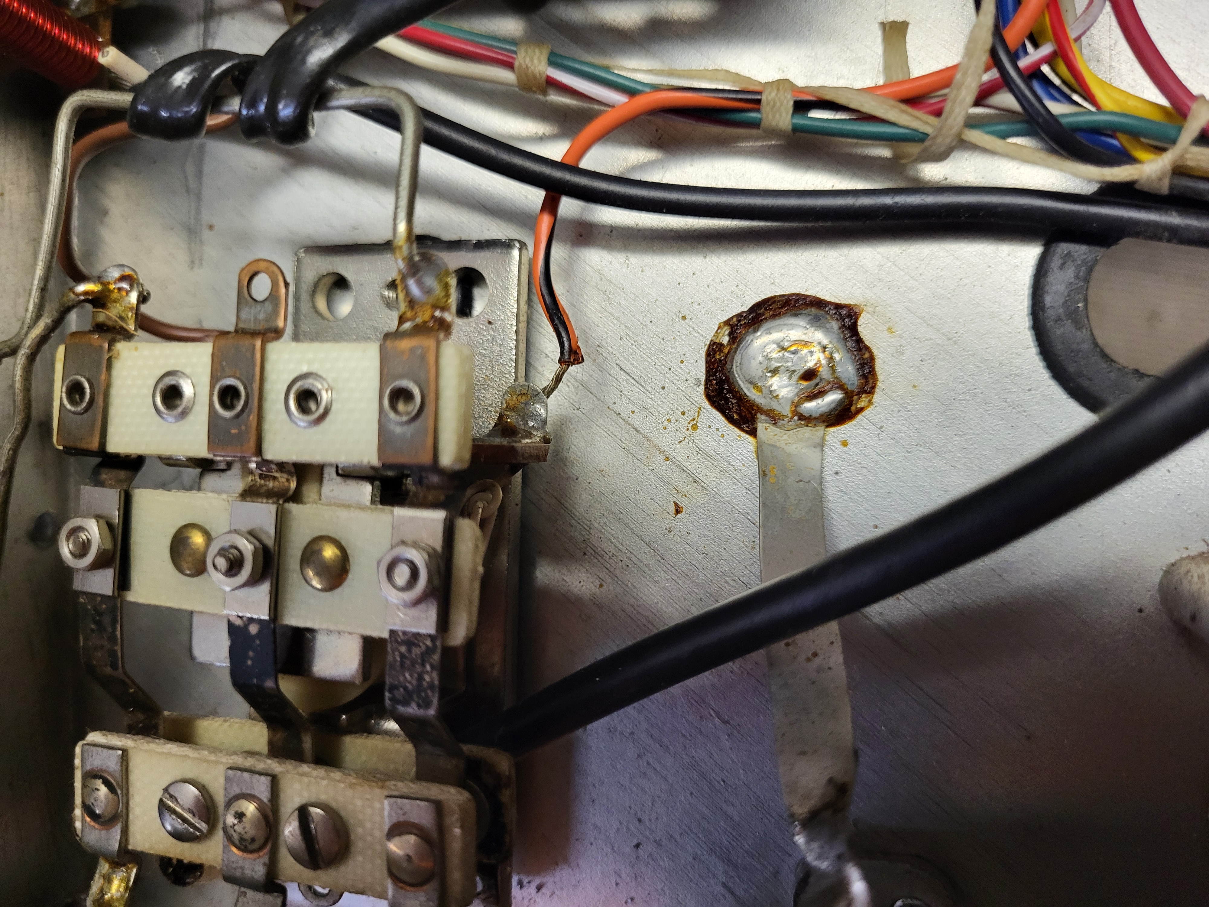

After removing the armor, I gave the innards a good visual, pulled the tubes, and checked for obvious issues. I found the relay contacts to be FUBARed, and a wire dangling at the main comp board (at least, I THINK that's where it came from). I think it's bias because it comes from the relay on a "keyed" contact. Although this amp is not supposed to have a bias circuit from the factory, I'll have to study that later... Let the games begin!

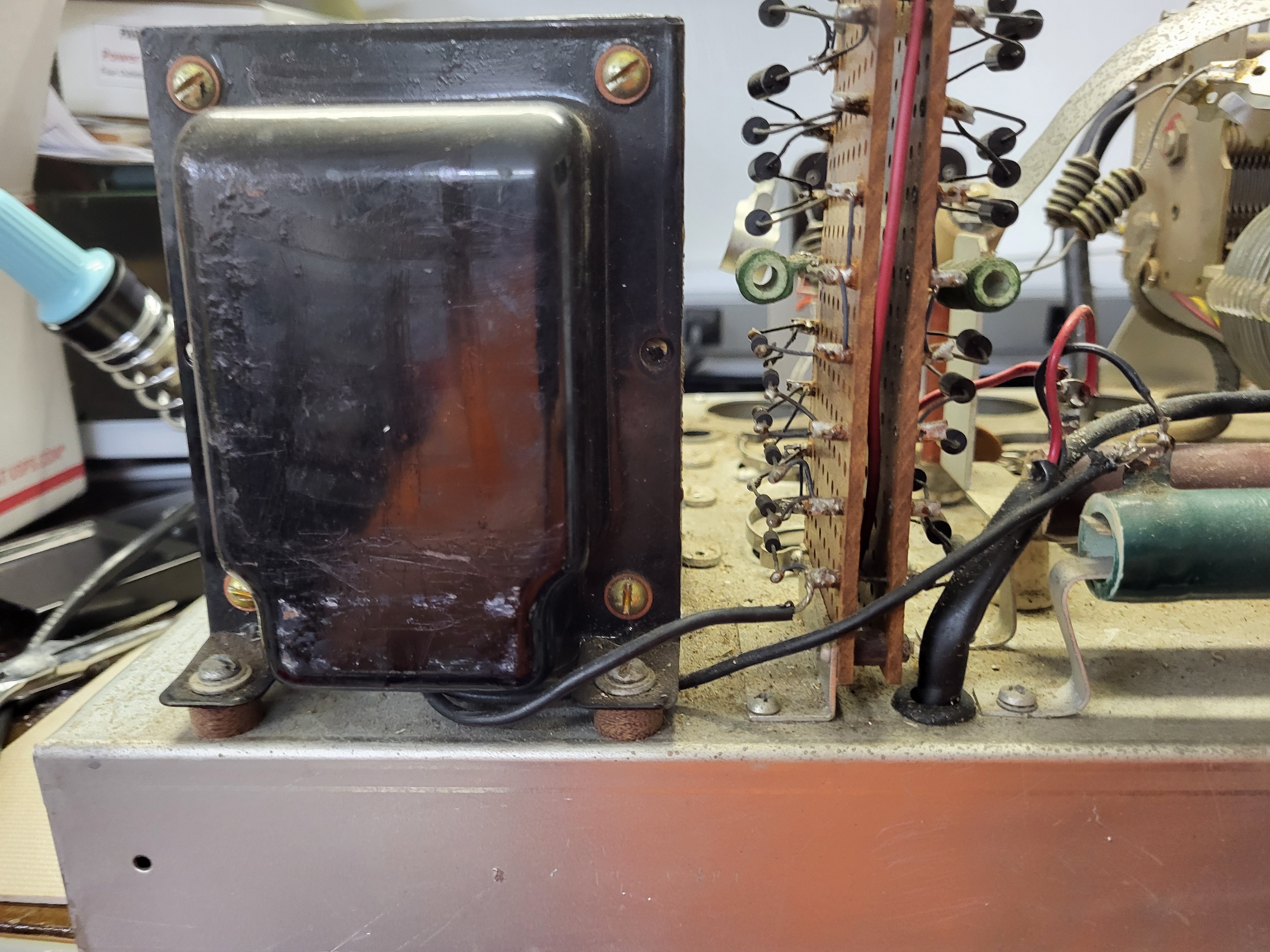

That was "big iron" 60 years ago. Here's hoping the transformer was treated well the last six decades.
If you could get them, a set of 572B tubes should last a long while, so long as you run it from 240 Volts.
Best guide to how stout your AC power source is will be to watch the color of the filaments. If the color changes when it's delivering power, this suggests that there is a voltage drop issue. This can weaken the tubes prematurely, running the cathodes below their rated temperature.
The transformers in these old Gonsets have no provision for 240V input. Strictly 120V. I have a set of Penta 811A's en-route, but I don't plan to keep this amp. I just wanted to turn it into a daily driver for someone. I kicked-around the thought of simply "mono-banding" it, but wanted to play around with these newfangled ATU-100 autotuner boards in place of an input tuning network. This is about as good a "test bed" as anything else, I guess.

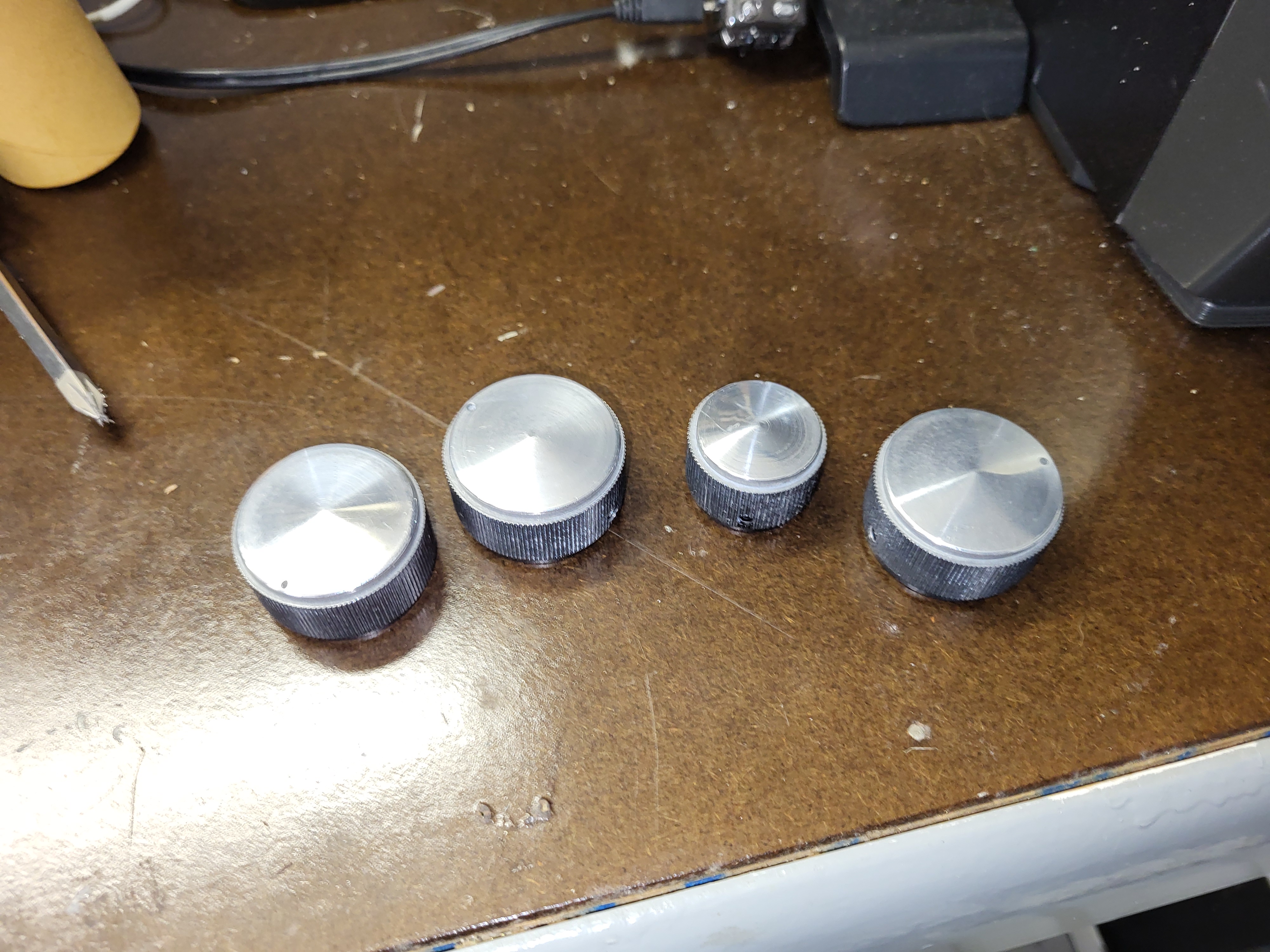

I polished up the knobs a couple weeks ago and they turned out like new.

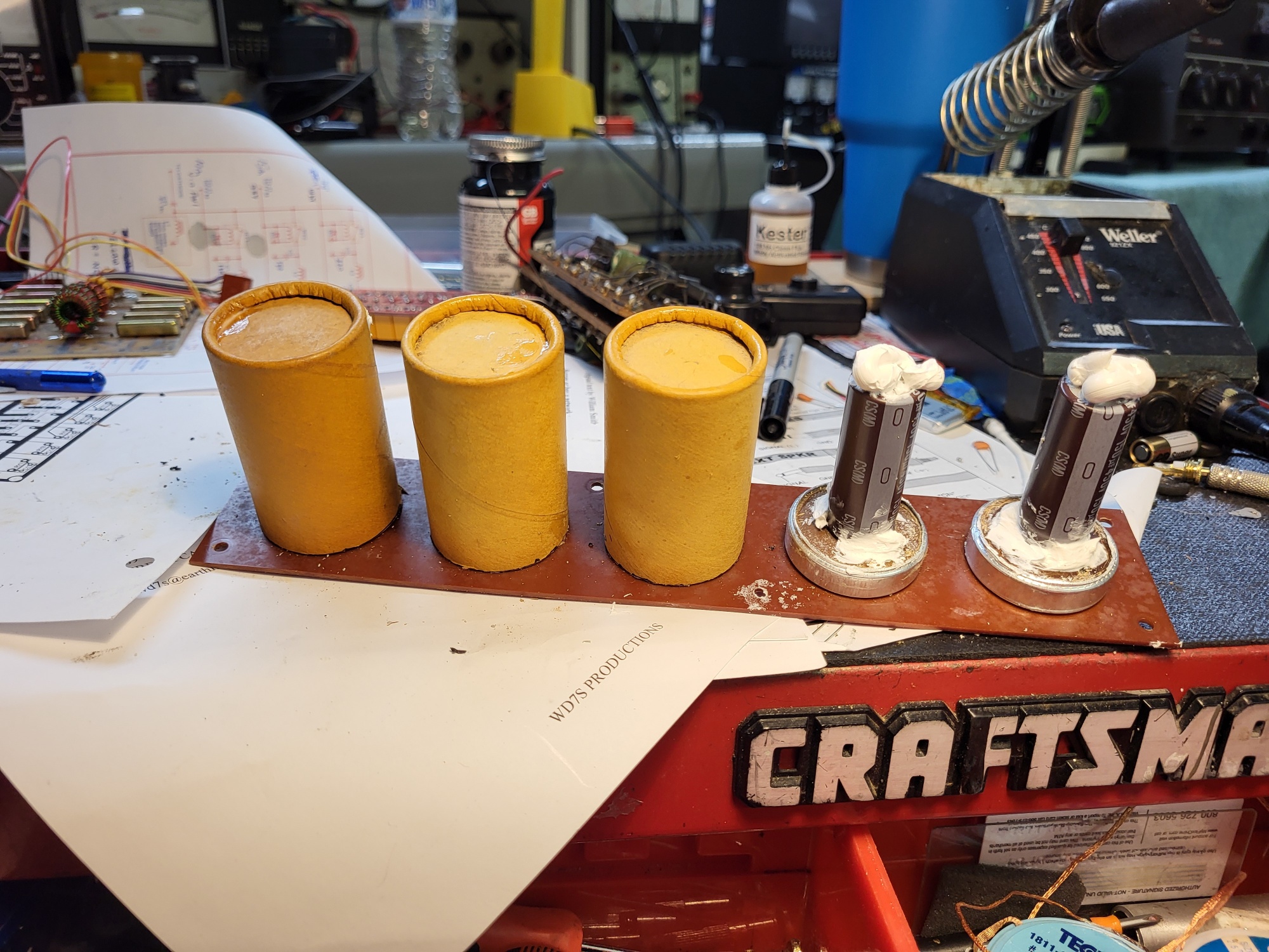

I pulled the power supply filter board and stripped it down. Two of the five 100K bleeders are out-of-spec. The caps all checked good --- believe it, or not! Mallory made reliable stuff back then! One did show some 'oozing' at the base.
I cut the cap cases at the base and cleaned the electrolyte out of them. I drilled two holes in them for the new cap leads and installed the new caps. The leads are soldered to the cap tabs on the back of the PCB.
I trimmed the cardboard covers to the length of the new caps plus old cap bases. and now, I'm waiting on new bleeders to arrive.

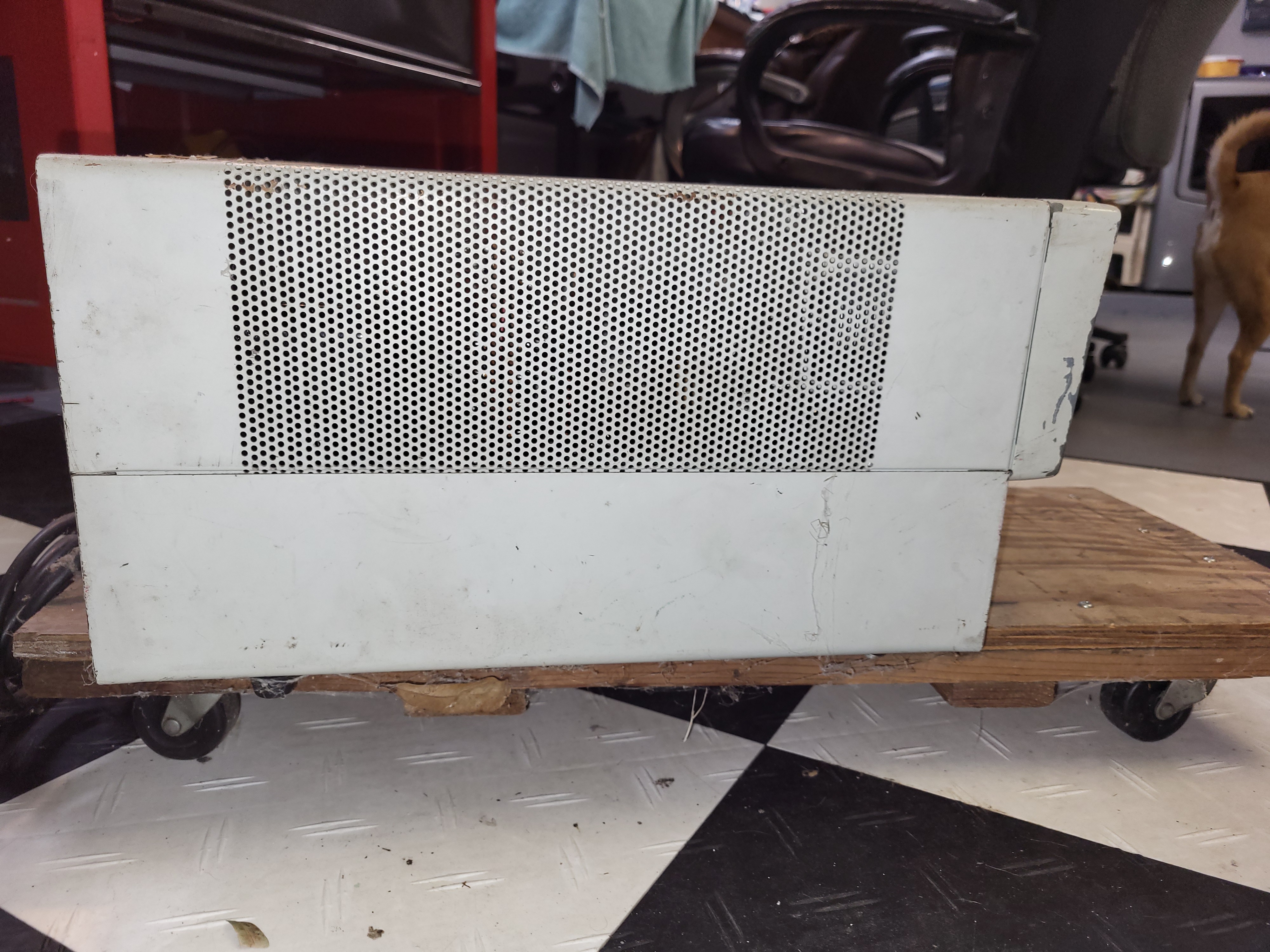

The armor ALONE on this Gonset is 2mm thick, and weighs about 11Lbs --- by itself! Overbuilt to the extreme. The chassis, of course, is heavy gauge steel also. Then, those two transformers.

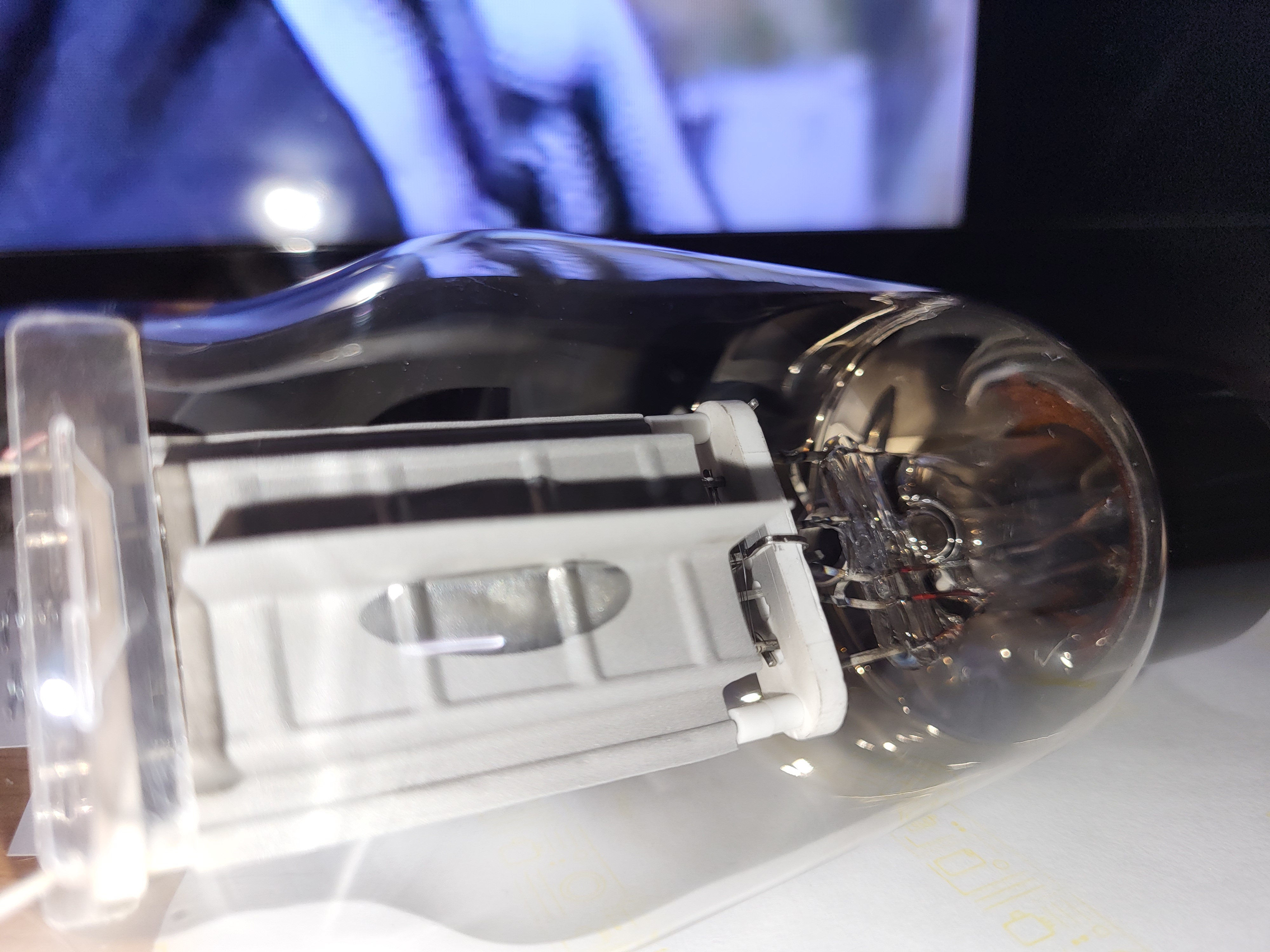

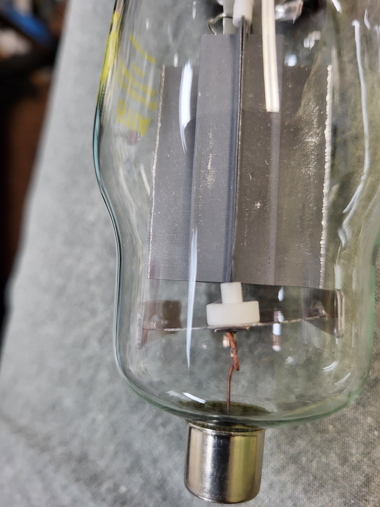

Progress has been good this week, but the quad set of tubes I ordered from Penta Labs need to be returned due to defects/damage.
Scott, Penta Labs' commerce manager, replied first thing Monday morning to address this. He is in-agreement with their engineer and me, that this one particular tube is not right. and a couple others might not be. Scott issued an RMA to return the entire set and cautioned me about even trying them out in the amp. This thing is in pieces anyhow, so that was never in the cards.
Look at the pic and notice the top filament spreader and the top of the anode plate........

Very true. He wasted no time getting back to me on this. But I'd be looking into their testing/matching dept to find out how this got past them, much less, why it didn't smoke their diagnostics gear when they plugged this puppy in. I'm sure Scott is "on it" now though hh.

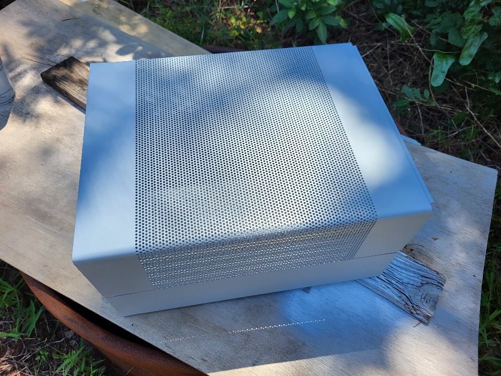

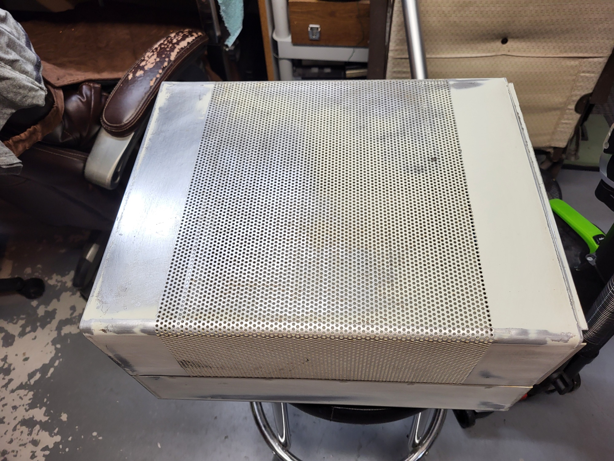

THE TRIP TO OUR 'PAINT & BODY' DEPT (my back porch);
I've put the armor on the 'back burner' until now because I had too many other 'honey-do's' to complete while it's still tolerable outside.... I do DOODLY outdoors in the summer due to the brutal heat n humidity, outside of driving a lawn tractor around the lawn once a week. I did want to get this knocked-out, so here goes.

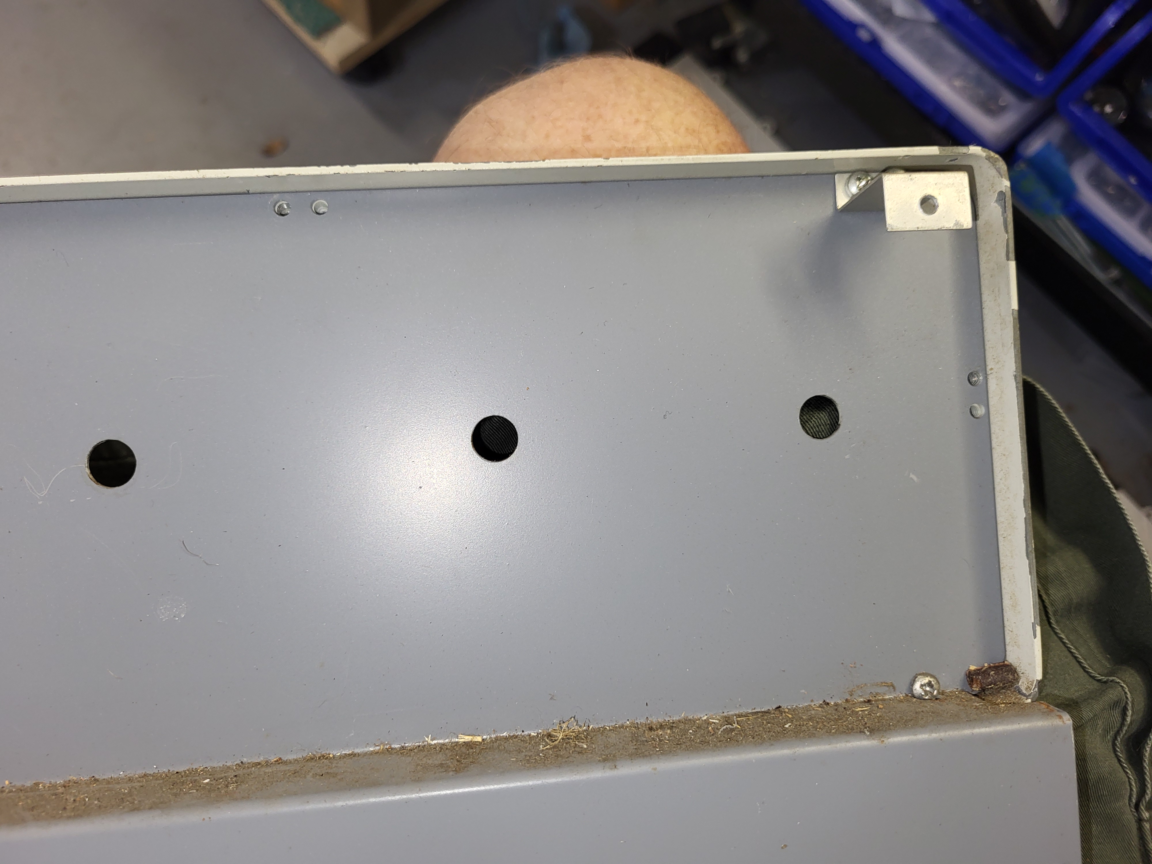

I think the OG paint is enamel, but not sure. Anyhow, I got the case sanded and third primer coat on it.
I'm going to wait a few days before wet-sanding and painting because the primer doesn't seem to be curing like it usually does. I probably laid the coats down too thick. But I want to avoid 'rolling' it up on the paper instead of leveling it.

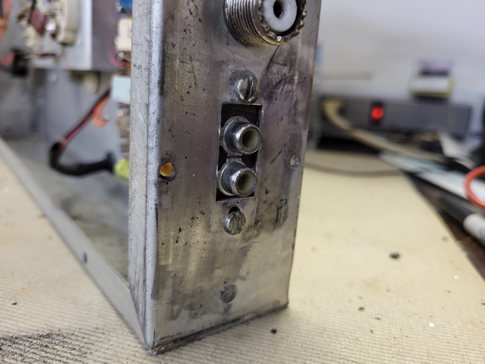

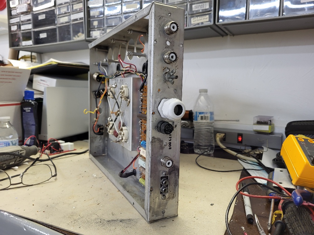

The chassis is back from the machine shop (my tool shed). I removed the old relay connector and replaced it with two RCA sockets, added a new power cord chassis grommet, and an AGC fuse holder.
I also directly-grounded the tube socket grid pins this week.

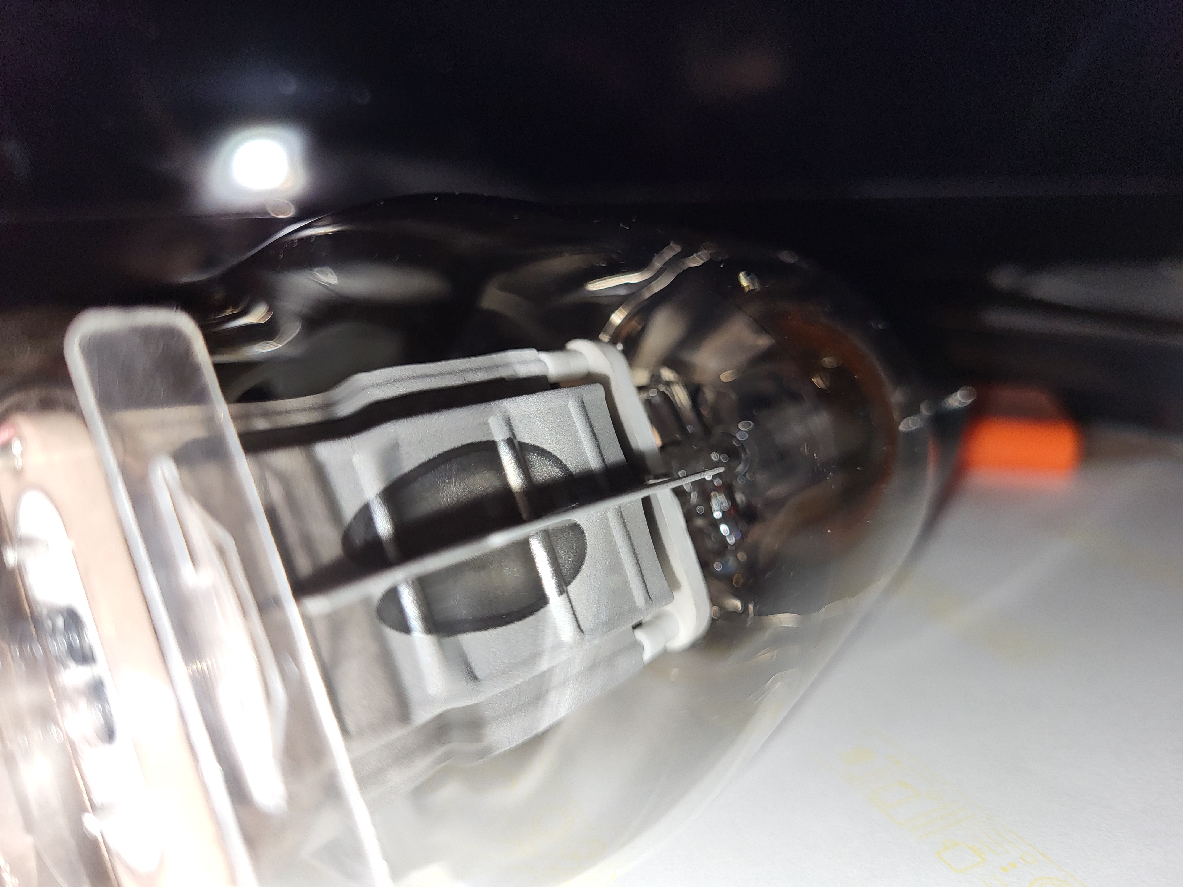

I got the tubes back from Penta Labs yesterday and they sure look better than the first set. Not too likely, but if I ever buy any more Penta tubes, they will be direct from the lab, rather than their ebay source. This way, I stand a better chance of getting a set of tubes that were really tested before they leave. The ebay store doesn't make the same claim that they're "Tested", and these clearly, could NOT have been.... Because that one in the pic a couple posts back would've smoked their hi pot tester ASA they threw the juice to it.
And it cost me an additional 3 weeks and $42 shipping just to get them them to/from Ca for the exchange --- so the set of tubes cost more than $243. I realize that RF Parts' 811's are from the same source, but I'll probably just go back to RF Parts in the future.

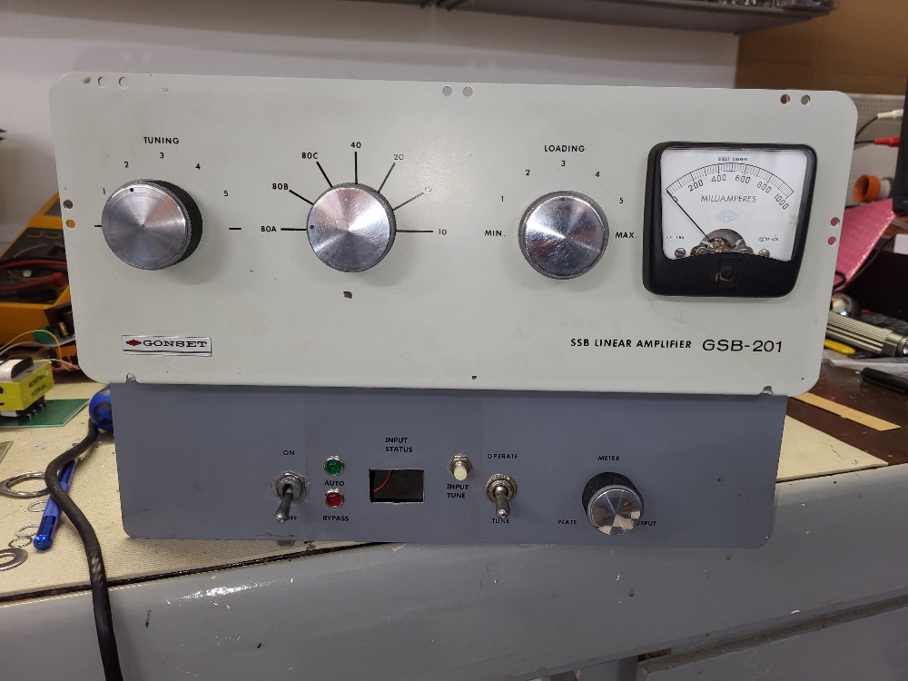

I'm not really as far-along as this might look, but the faceplate is done, and mounted so I can lay-up the chassis standoffs for the three PCB's I still have to mount and wire-in.
Once those are mounted, I should be able to proceed with the transformers, diode board and wire-up. At least, you can see where the input status and tuning are set up on the panel. It's a good thing I bought two of those ATU100 tuners and from two different people... ONE of them is a real dog, while the other works great.
I'll likely toss the dog in the trash after scrounging the relays out of it.

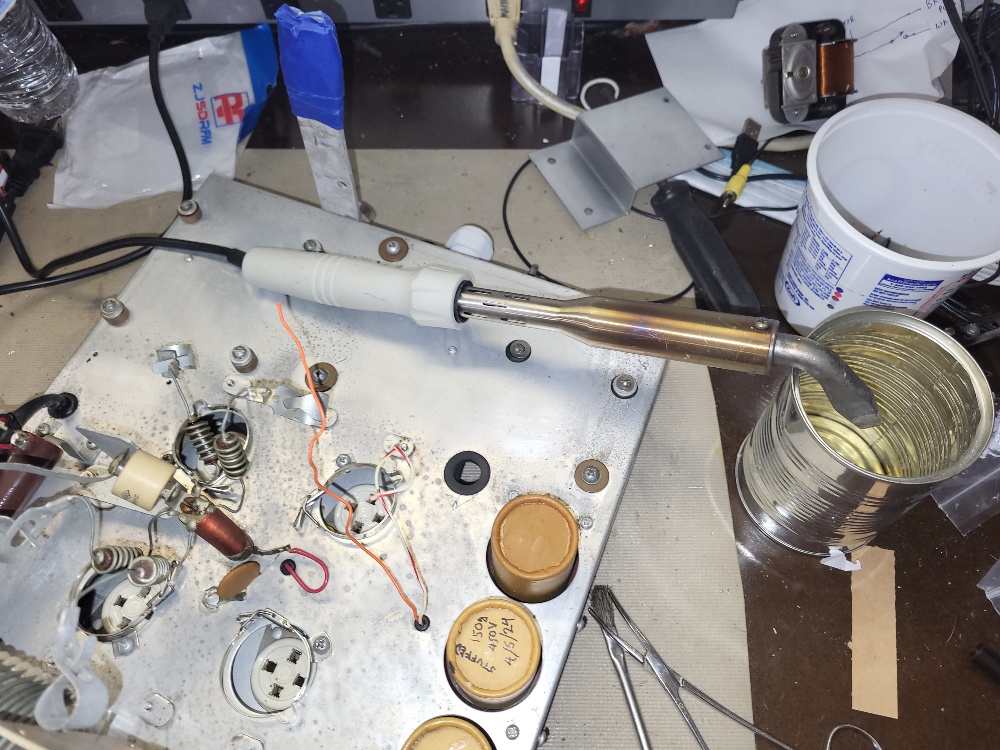

I had to pull out the 'heavy artillery' to move a tank ground strap out of the way of one of the tuner mounting standoff holes.
"That isn't a soldering iron, mate"......

".....The ebay store doesn't make the same claim that they're "Tested", and these clearly, could NOT have been...."
Their 3-500ZG I got from their ebay source scared the you know what out of me when I turned it on the 1st time.... crazy arc and spark internally for the first few key attempts ... I was about to fire off a panicked email....oh there was swearing... but then it just settled down tuned up and right as rain after. Still kinda the same feeling as you. If it was tested... they would have seen that...but works great now. That beast is coming along! Looks good but my back hurts just looking at it.
