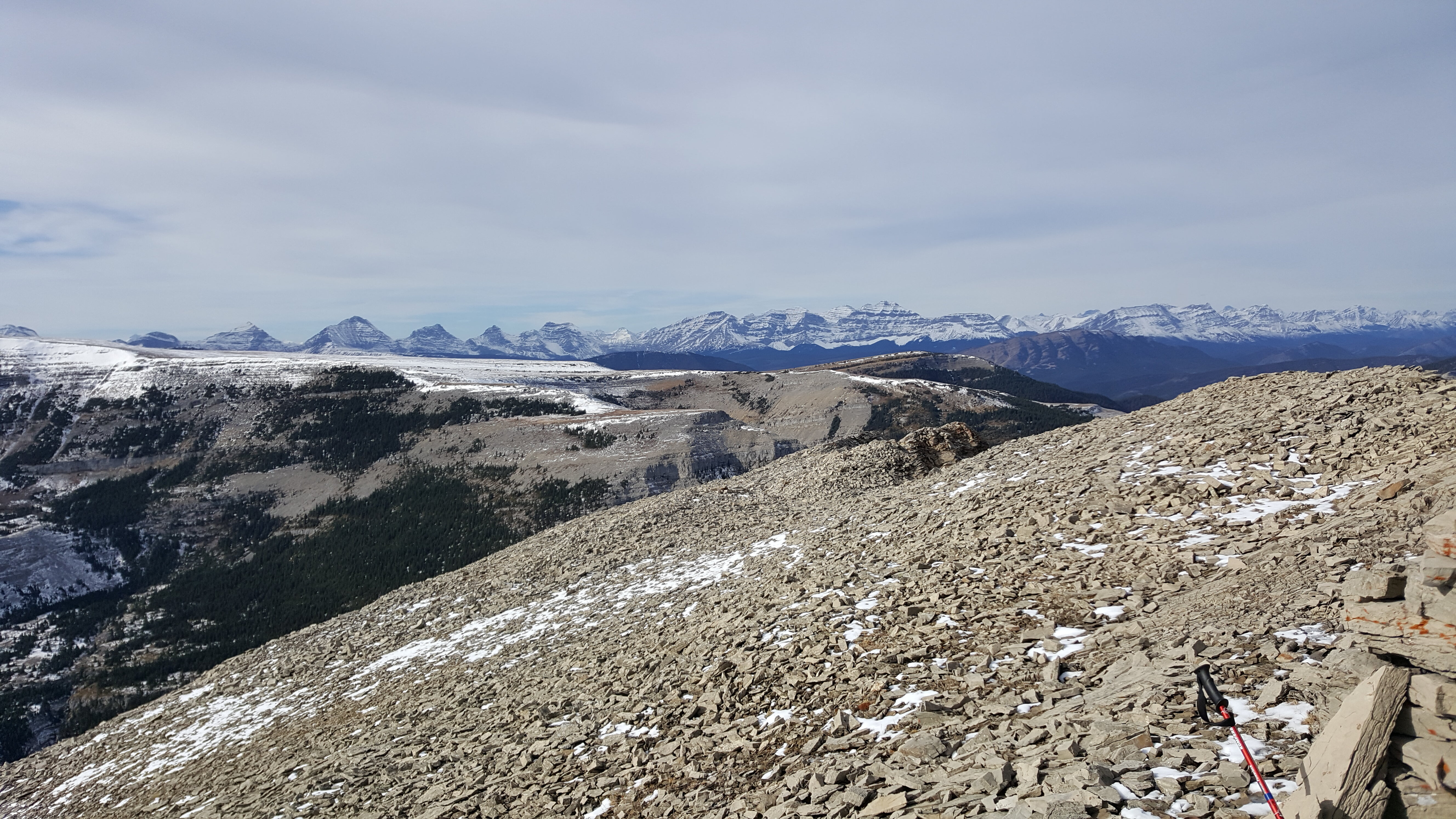

That seems to go against the premise that soil is "better" ground than rock. Rock being more like desert (i.e. the worst ground) ?
Blaster,
Attached is a picture of my idea of rock.
Very different idea compared to many may envision
. For true soil I would have to agree with CK.
Reactions: TheBlaster
Pretty much like desert just by looking. I suspect the "I am up a mountain" part is somewhat mitigating the "I have poor soil" part : ) The height gain will be very, very significant. At great altitude the ground losses will pale into insignificance at a guess.
Also if land slopes away from you your lower angles of radiation in the direction land that slopes away are fortified by default. i.e. at the top of a ridge. This is because the ground reflections that recombine with your main radiated signal (their phase relationship) combine constructively at a lower angle than on flat land.
http://on5au.be/Cebik-2/ThePseudo-brewsterAngleRevisited.pdf
