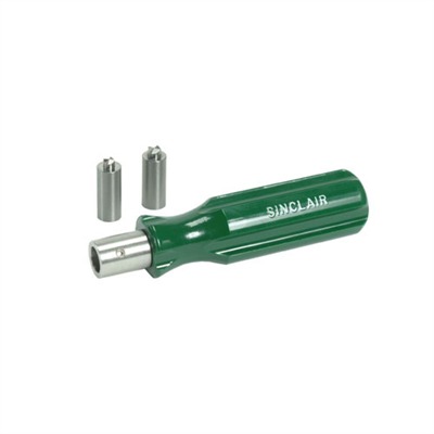

This tool is what I use for them primer pockets, it really helps to make them clean easier, you probably have used this yourself if you load for competiton or precision reloading.

very good, I agree, too much brass in the tumbler does not clean the brass well, that is a nice pocket tool and does a terrific job. I use the Lyman case prep for all my Boxer Brass. and use the RCBS deprimer for all my Berdan Brass
