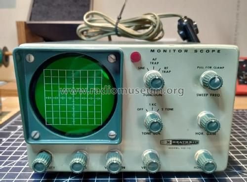

Got this from eBay a weeks or 2 ago. Ordered new caps and some select resistors. Input adjustable rear panel from 1/2w to 1kw (SSB I presume) just a jumper with a signal tap to scope inputs.
It's old but limited features so it's not so complicated I'd avoid using it. Will it have "use value" or just a pretty green light? IDK but I'll get it set per the manual and see.
Inside was in good shape all stock w/ some evidence of smoking environment. Orig Builder did a fine job with the solid PTP wiring, purposefully bent leads. Reluctant about replacing everything. Vertical gain pot (1MO) somehow destroyed, shaft would not turn, inside wiper broken/bent somehow. My 1st project since getting new LCR meter so it’s an opportunity learn using it. HO-10 Monitor Scope pic.jpg

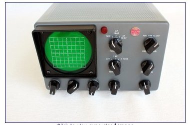

I've also enclosed a picture of an HO-10 with different knobs, they are what I use on mine.

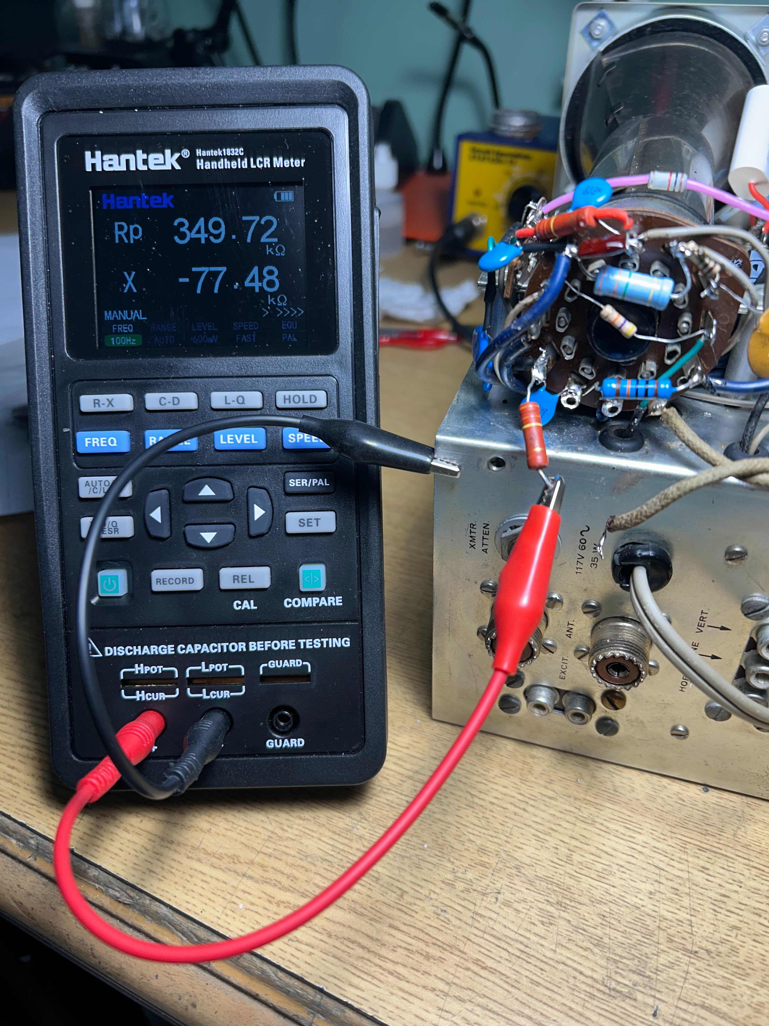

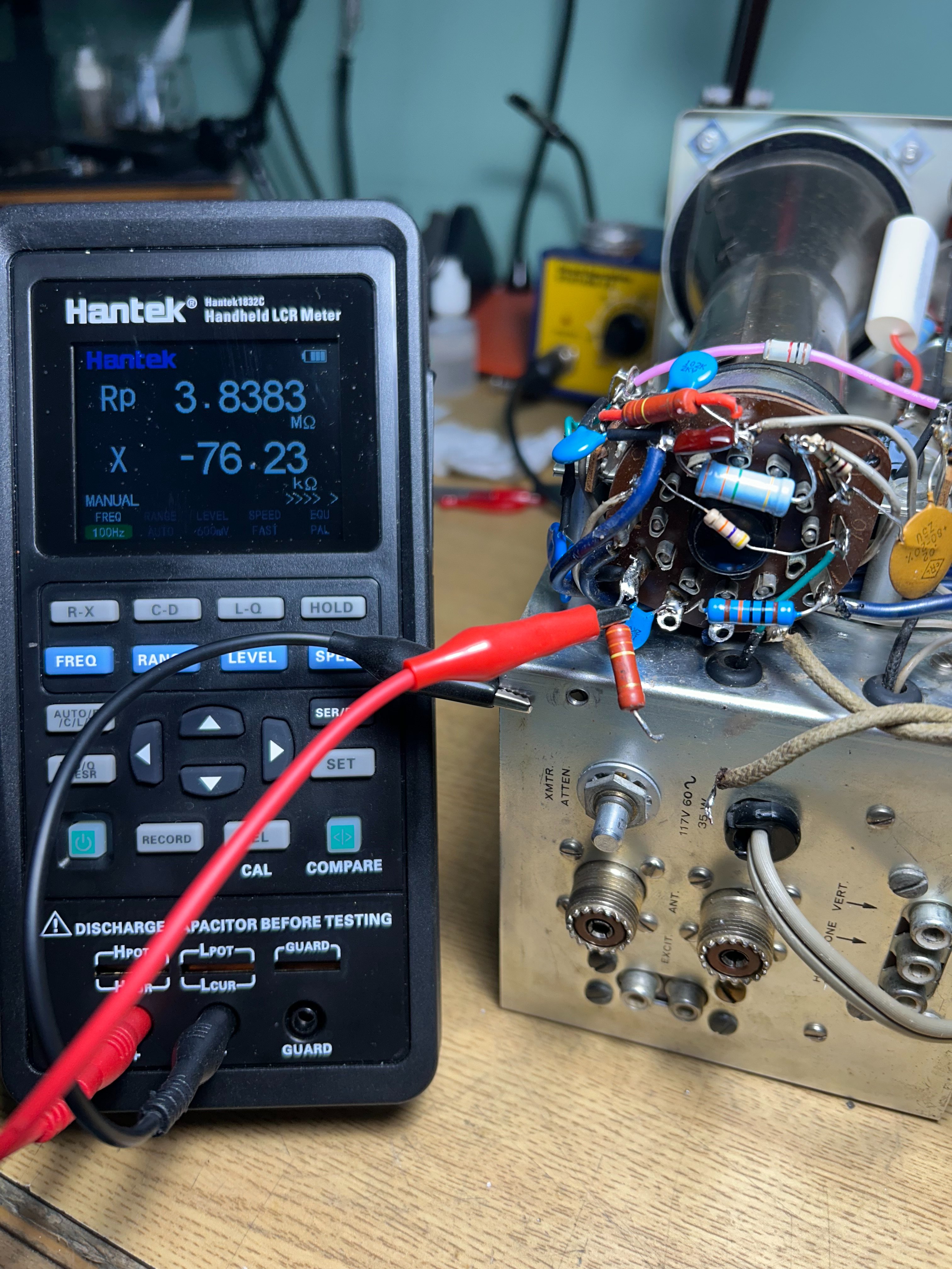

I think I made a mistake via my misunderstanding of Metering. I may have figured it out but I’m looking for corroboration. The Heathkit build instructions have 3 measurements of Resistance that should be attained prior to applying power for the first time.
My first measurement was far too low by a magnitude of a few MO’s. I used an LCR meter that uses an AC signal. After a day of chasing my tail I now suspect the LCR meter's AC sampling included all the bypass caps which gave me such a low reading. Is this logical and reasonable?
So I need another VOM in addition to the LCR?
Is my thinking correct here?

The meter that was used to obtain the numbers in the Heath manual would have been one of their VTVM models, most likely. Used a 1.5-Volt flashlight cell to power the Ohms scale. You need a meter that uses DC to measure resistance when comparing to the manual's numbers. Worn-out front-panel potentiometers are the bane of old analog 'scope maintenance. The high voltages tend to wear them out.
