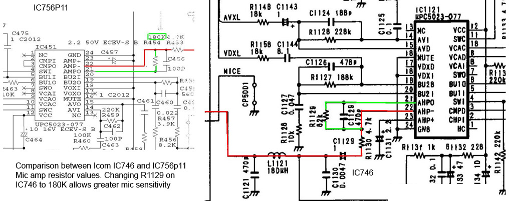

I subsequently discovered that most Icom radios, 746. IC756 and the pro's share very similar TX mic amp topography. It became obvious that Icom had increased the value of a resistor in the feedback network of UPC5023 on the MAIN unit in the later radios, presumably to allow after market microphones to work.
changing R1129 to 180KR brings the Icom 746 mic sensitivity up to that of the IC756Pro series.
here is an except from both diagrams, the resistor is surface mount but even if you havent got one, with care there is room to fit a 1/4W resistor.
N.B. IC706 and IC735 etc are the same. Icom Mic amp
