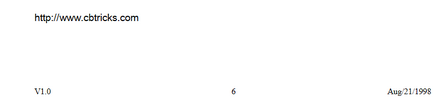

Go to this link...it's at Alldatasheet
Scroll to Page 6 - go all the way down...bottom of the page - you'll see the origin sourcing of this data...
Wild!
