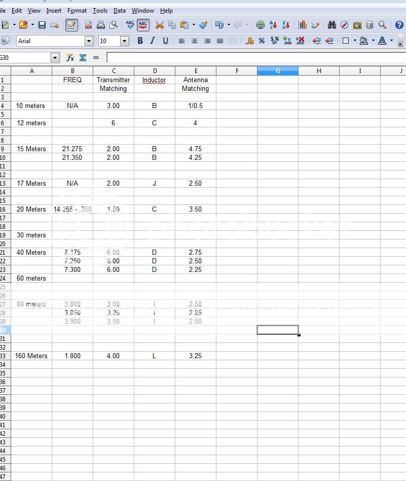

I use my road maps all the time. One for my tuner, one for my amp. VERY helpful!
Glad it's not broke. :)
