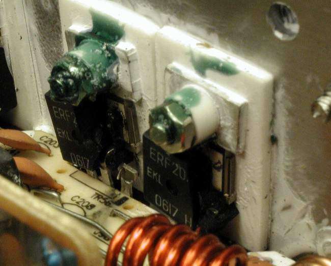

The calibrated eyeball is your best first tool to see what the problem may be. Along the aluminum plate heat sink at the rear of the main circuit board you'll see the RF driver transistor at the far left, and the two "final", or main power amp transistors side-by-side to its right. With any luck yours don't look quite this bad.
The "pop" you heard is no doubt connected to your "no transmit" problem. The noise suggests that one part or another will appear physically damaged.
If you do find this kind of failure, there will also be other faults that are not so readily visible. What tools do you have for finding "hidden" failures in parts that look as if they are okay? A multimeter, wattmeter, dummy load are a big help. An oscilloscope is an unfair advantage.
