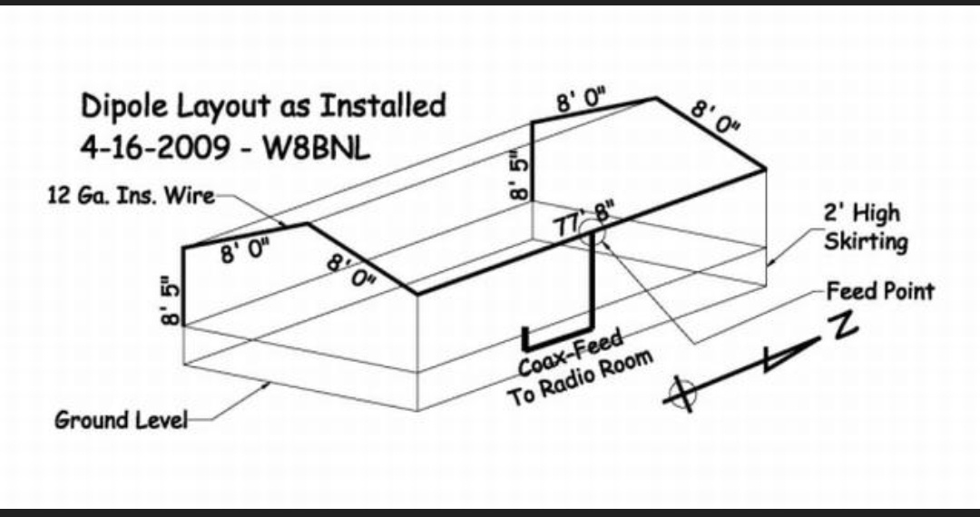

About the large loop. . . Have you considered running it outside all around the perimeter of your roof tucked under the edge of the shingles?
Image shows a dipole, but it could be a loop, too.
Reactions: RT431
I don't know, personally.
Those with antenna restrictions look for ways to get on the air. This has been an option for a stealthy approach. I intend to try one just for the fun of it when I get some time.
