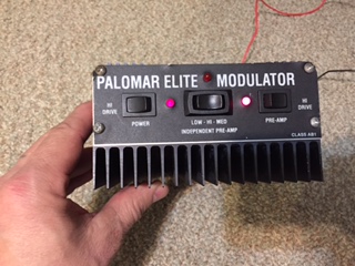

There is no number on it not sure of exact size does say hi dive looked inside two pill I don't know anything about trouble shooting it . But when I put the pre-amp on light comes on but amp power light is partially light also and the rf meter drops a hair with no increase rf . When I put power to amp and transmit light comes on and I can hear relay click put not seem to have increase wattage output. I got this amp new and had it for years always worked fine is it at the end of it's life or is there something I can do with it?

ok before with per amp on I didn't get power led half lit per amp is working but amp isn't 4 watts on or 4 watts off I am getting a hum from relay when keyed up not sure if I did before or not

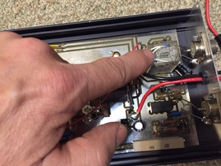

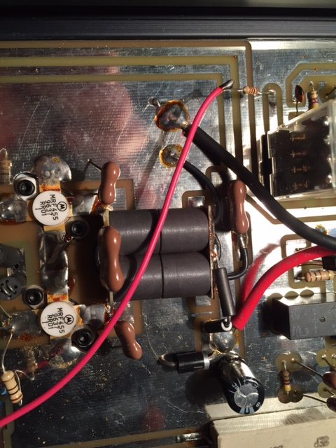

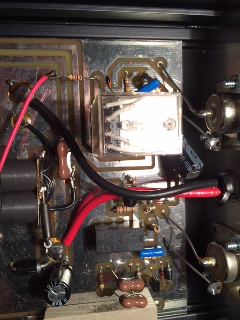

Turn the pre-amp off when testing it since it serves no transmit purpose. Assuming you have the coax in the correct input/output locations on the back of the amp, I would say the keying relay might be acting up. I hope in that third pic that's not the actual power leads showing in the top right. Way too dinky gage wire.
The relay should click in and out when you key and un key the amp. The relay may have gone bad. Also you should really get the input wattage down some as far as the dead key from the radio. 4 watts dead key is too much for that amp IMO. 1-2 watts is all that should be needed with a max of 12-15 watts pep. And yes that is the size wire that comes with those amps as far as the power leads are concerned. I have one of those amps as well. I use either a cobra 25 or uniden 980 with mine, I keep my dead key power to about 2 watts max And 12-15 watts pep, any more and the amp gets hot fast. I have to agree with 9c1driver though, sounds like the relay or key up circuit is not working correctly, I know my amp whether on am or SSB the relay clicks in/out when I key/unkey the amp. May be time to send it off to a tech to have it looked at further. JMHO.
I looked at the relay and can hear it when it is enclosed it has a strong click I can see it open and close I can hear a fine hum when the key is held down. I am thinking I put to much power to it now with the info given I tried a new mobile with it in my home as I only use the amp on my base now. It was only a short time I may have ruined transistors ? Galaxy 939Peaked/Tuned Radio For Export Resale

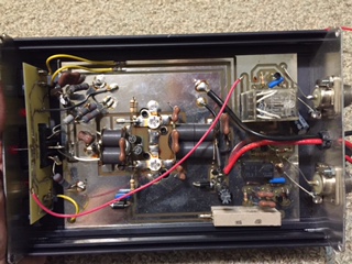

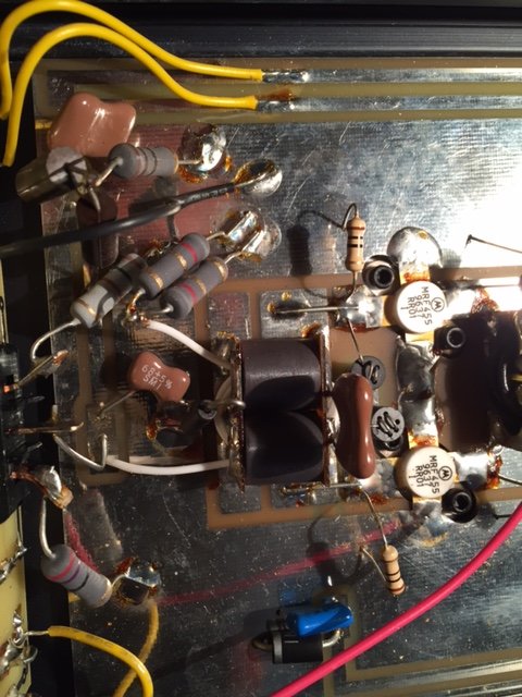

There may be more damage than just the transistors. The amp itself will only produce 140-180 watts max on high. You put more watts into it than the amp is probably made to do cleanly. For an amp like that one a stock cobra 29 or uniden 980 would work fine. I have used a stock 980 with mine and it gets good reports even on SSB. For just AM use an older side mic cobra 29 would do well with that amp. Even a new one would do good. Just keep the dead key down and the pep wattage under 15-18 watts. Most single final rsdios will fit this category, whether export or not. But having it repaired may cost more than the amp is worth. Take some good close up pics from the front to back, there may be some visible damage. The trsnsistors need to be tested, but there are other components that some here may be able to point out to you with some good photos. Look on eBay for a similar one to get an idea of what a used one runs. Not sure what a new or newer one would cost but I would think about 150-250. Maybe cheaper if you get lucky. Good luck wih whatever you decide.
