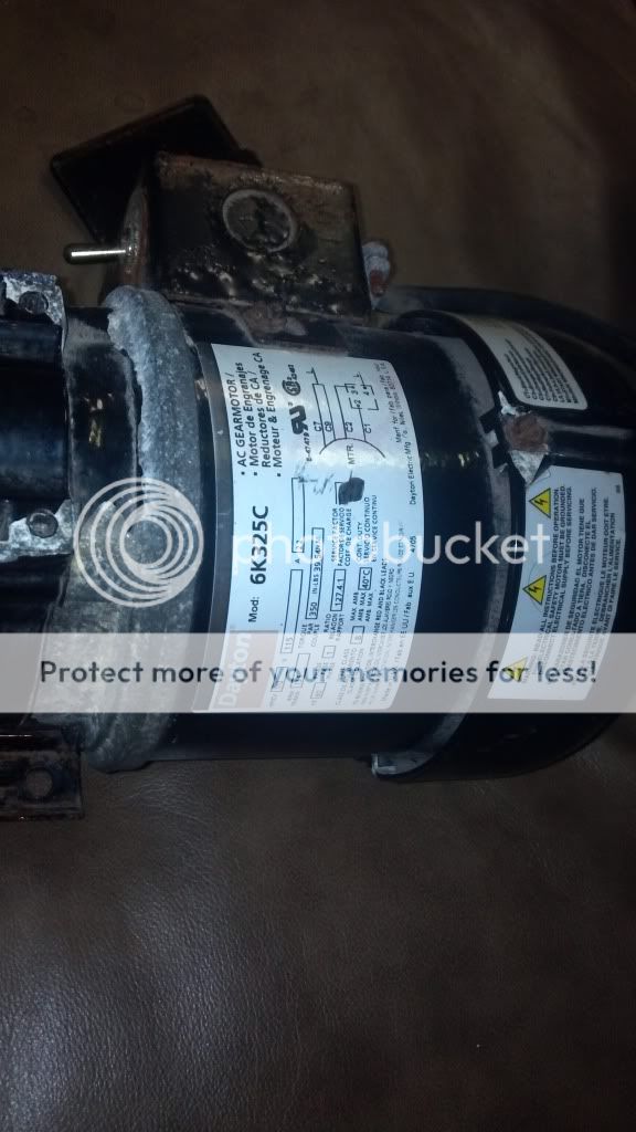

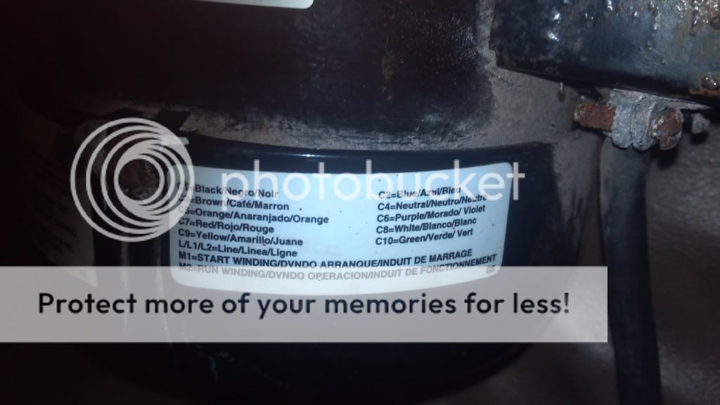

The lable on the say's to revers rotation interchange red -black. I will do my best to give you the what the lable is reading's HP/CV1/12-V 115 A-22-------------------------RPM13.5-TORQUE PAR COUPLE -350 IN LBS 39.54 N M----------------------------HZ 60-PHASE-FASE-PHASE-1-ROTATION- 127.41------------------------------------INSUL CLASS B-MAX AMB 4o C. Wires are C1= BLACK-C3=BROWN C5=ORANGE C7=RED C9=YELLOW C2= BLUE C4=NEUTRAL C6 =PURPLE C9= WHITE C10 =GREEN . There also is a relay inside the switch box that some of the wires go to. I not sure this will help or not but if not when the wife gets home i will see if we can post photo's. Thanks so much.

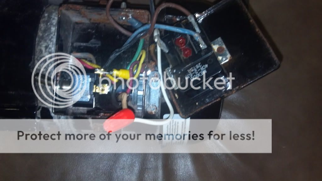

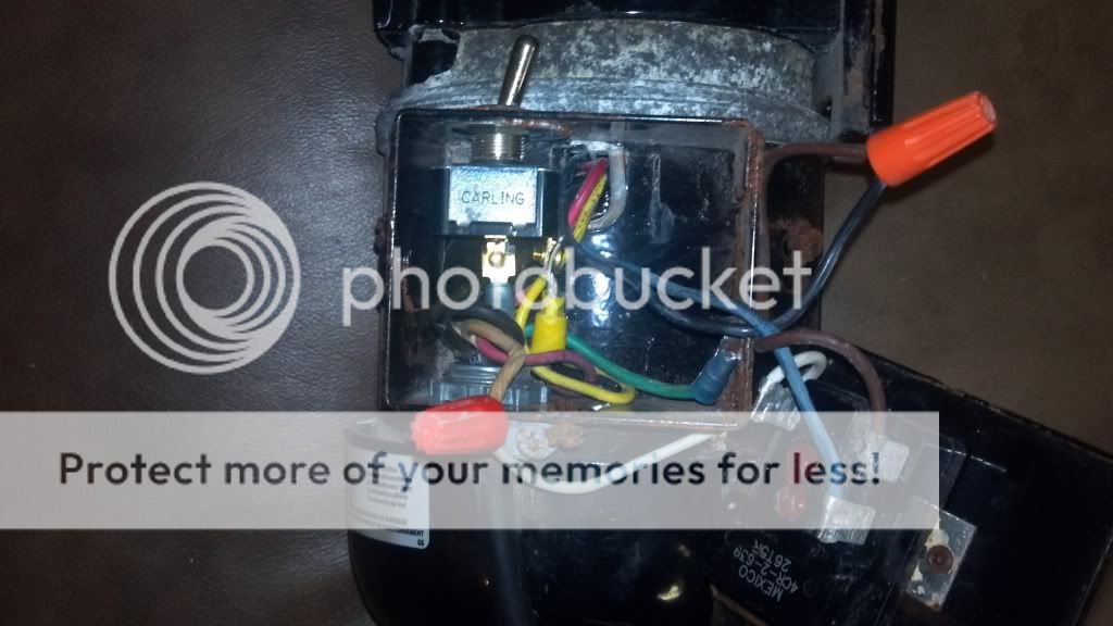

Hi all here is a wiring diagram sent to me by Granger for this motor. Plese take a look at the photo's and the Attachment and if you will tell me whitch wire gos to witch pole. My switch is on off on with 6 pole's. My power cord has 3 wires RED BLACK GREEN the motor wires RED YELLOW BLUE BLACK and the limmit switch wires are BLUE BROWN WHITE the photos show where the wires run. I can wire up cars and some in home thing's but never done anything like this. I undertsand some of it but not well enough to do it.
You should be able to use a dpdt switch, take the lead from the motor and connect to the center pole and a jumper from there across to the other center pole and connect your control wires to opposite ends of the switch.
Hopefully the picture will post... Drew it out quickly on my youngest's homework, lol. Since rotation is reversed with the connections of red and black to yellow and terminal 2, I think this is how I would wire up a DPDT switch. Not sure you have room for it in that box, you may need to mount another.
