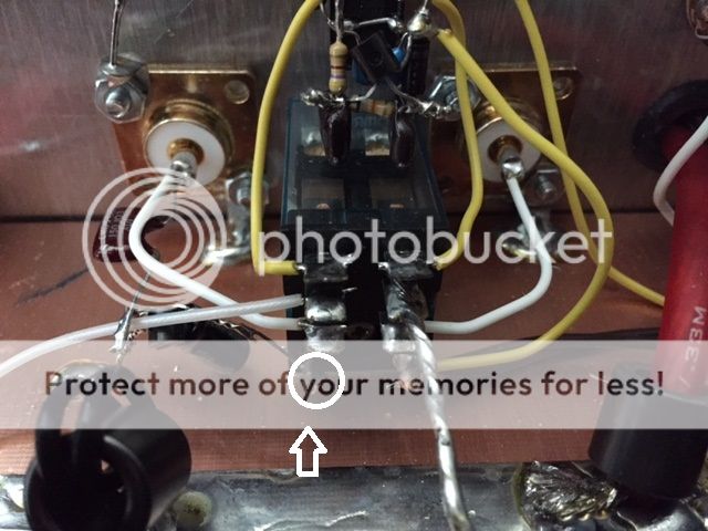

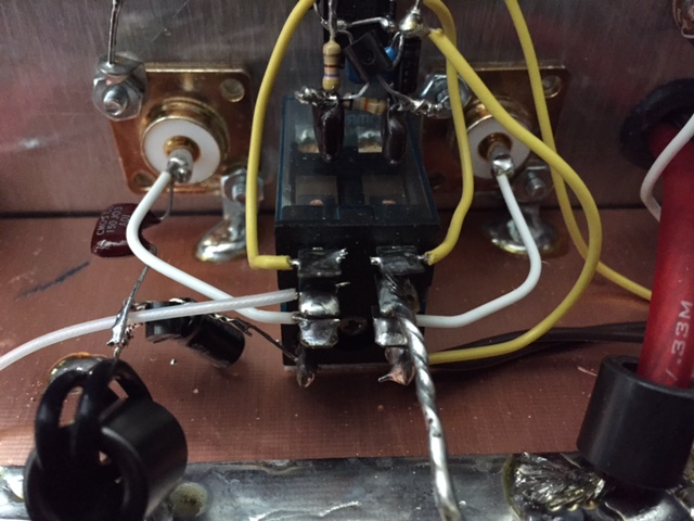

Hi all, I have an XFORCE XM400 amplifier that does not have the SSB delay so I plan to add a 1000uf capacitor and switch so it will but I am not 100% sure where to connect the capacitor to the relay, can someone look at the picture attached of the relay in my amp and tell me which post is positive and which is negative (ground) so I can connect the capacitor to it? I have e-mailed and texted XFORCE but can not seem to get an answer. Thanks for any help. Adam

Hi, thanks very much for the post. I understand all that but was hoping that someone could tell me which lead on the relay in the picture is the positive post. Thanks, Adam
Hi, thanks for the post. I understand all that but was hoping someone could tell me which lead is the positive post according to the picture I posted of the relay. Thanks, Adam

The positive post of the relay is the left bottom post in the picture you provided, the post that has the transistor and small capacitor soldered to it.
