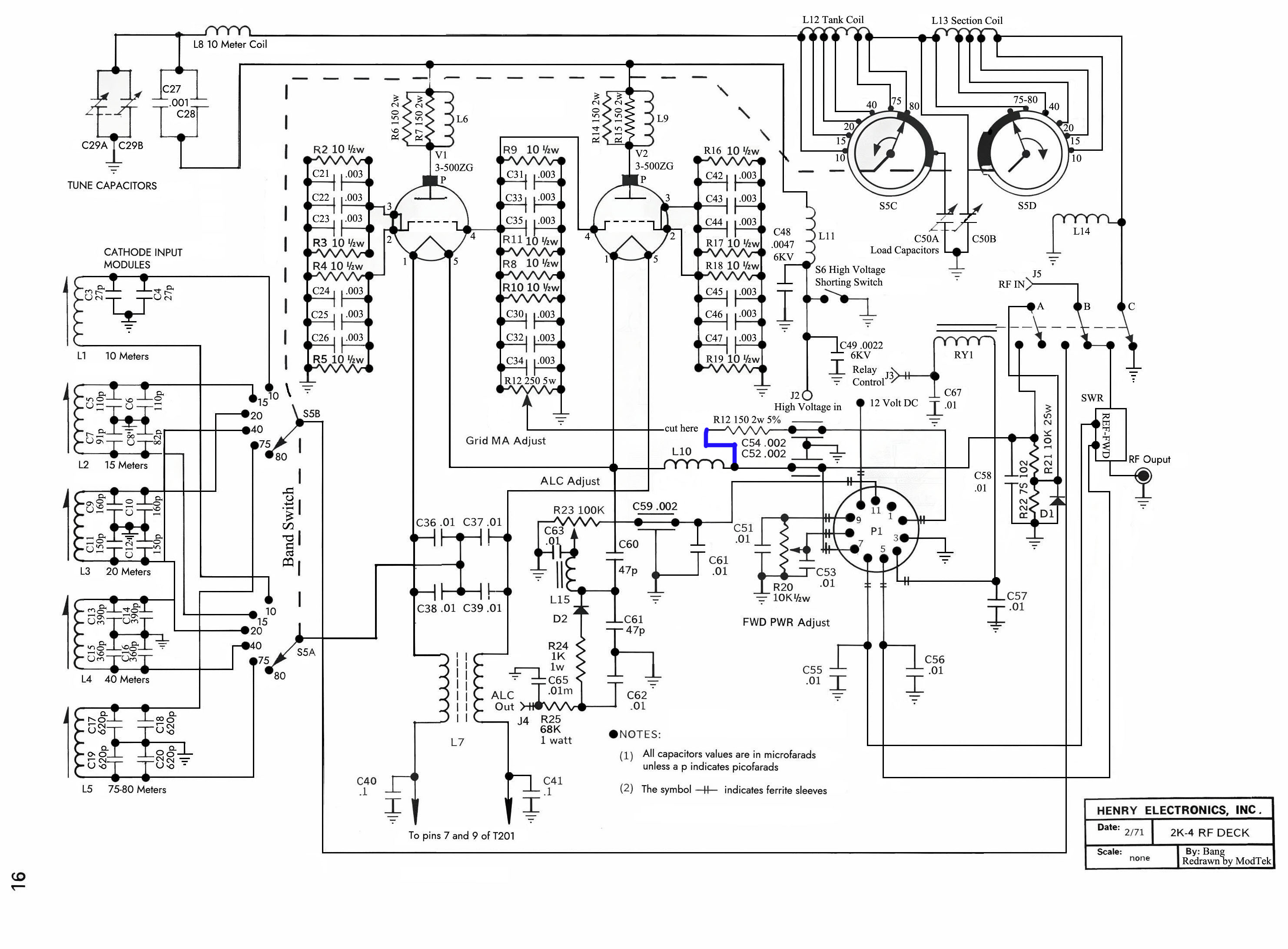

Has anyone ever strap grounded the grids on one of these amps and modified the the tap point for the grid current meter? I am thinking that grabbing the return on the filament center tap between R10 anb C52 shown by the blue line would get it to work again after the grid grounding.

Traditional shunt resistor for a grid-current meter is connected from B-minus to ground. But that assumes that the B-minus "floats" and connects to the filament center-tap, maybe through the relay and a zener diode. This model connects the B-minus to ground, more or less. At least the power-supply diagram shows the positive pole of the plate-current meter is grounded. Traditional designs "float" the B-minus, connecting it to the cathode transformer center tap, maybe via the relay and a maybe zener diode. Only the grids connect to ground, and the grid meter reads voltage drop across a shunt resistor from B-minus to ground. Don't see a way to bodge this into that power supply. Looks to me like you're stuck with the grid-resistor array unless you redesign the power supply. The overload relay is a part of this picture, and it would have to get rewired as well.
Looks like a can of worms to me. Not attractive unless you're going fishing.
What if i do this:
Instead of connecting the ground straps directly to the chassis, connect them to a single common point like adding a resistor say 1 ohm 10 watt from grids to ground reconnect the meter to that point on the ungrounded side of that resistor to use as a sampling resistor for voltage drop?
That power supply circuit calls for resistance between the grids and ground to serve as the shunt so you can read grid current. The exact form it takes probably isn't all that important, but you're stuck with that power supply unless you redesign it to "float" the B-minus above ground. That would permit a direct ground on the grids. The grid-current shunt resistor would then move and be found between the B-minus and chassis ground. A glance at either the Heath SB220 or Drake L4 schematic is a good example of that layout.
