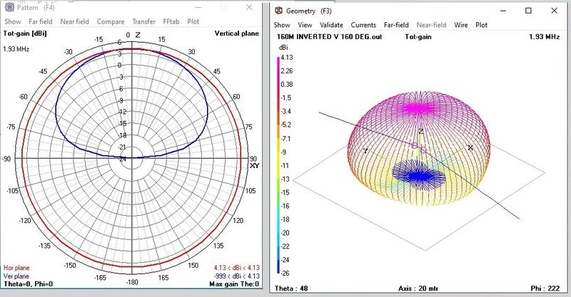

The best (multi band) HF antenna I've had is a basic inverted V, cut to λ/2 (λ = lowest frequency of interest) with a 600 ohm feedline cut to λ/4. The feedline (if you do not have a balanced-line tuner) is brought into the shack to a 1:1 current balun close to the tuner. You will need lightning protection (spark gaps / polyphasers) at the service entrance. You're "lowest frequency of interest" will of course depend on your available real-estate. My experience is that true inverted V's are pretty much "uni-directional" (see EZNEC simulations below). Interesting article by L. B. Cebik, W4RNL (SK) here.
