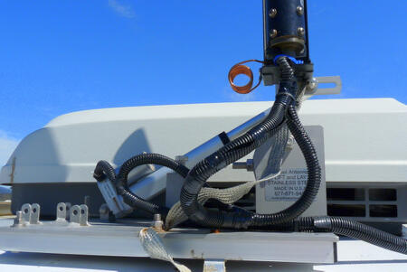

Below is shown a TARHEEL Lift & Lay on a competitor trailer with a screwdriver. That’d be a second antenna for this rig. Dedicated CB is the road I’m on right now (and didn’t state that).
Thanks for your pics: I don’t have a built-on roof access ladder, but I see plenty of such arrangements as yours on-road; few look as good from an engineering standpoint.
