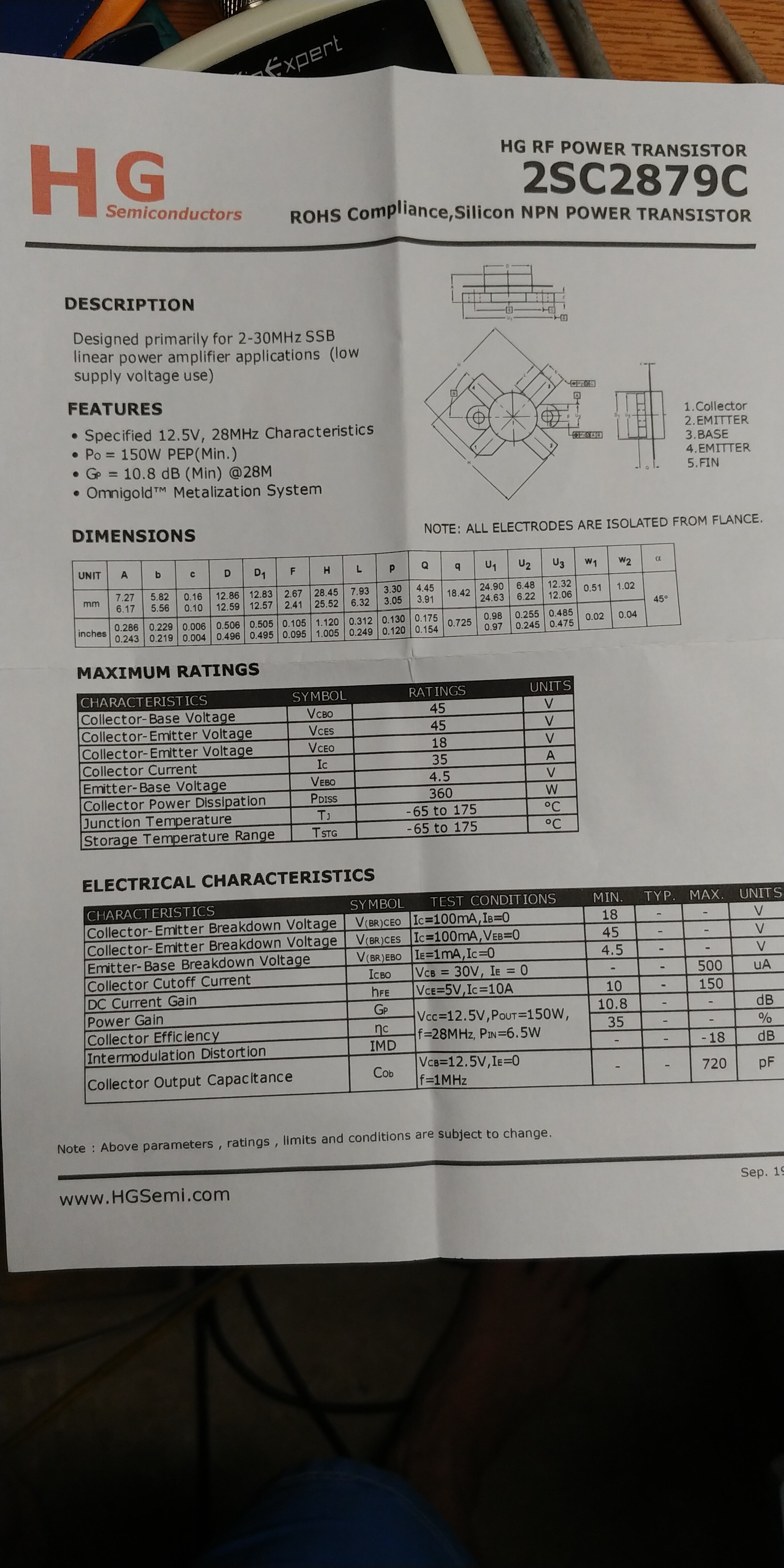

I'm sharing the info that was included with my recent order from HG
I hate to be skeptical but that datasheet appears to be a complete fabrication. So HG managed to get an additional 10 amps of collector current supported, along with another 110 watts of collector dissipation? I won't even begin to believe this until I can see 35 amps of collector current being supported through a single device. Someone please do this test so we can confirm the datasheet as bogus! If this is true, the Chinese have just developed the most powerful RF bipolar transistor ever made by a long shot. Not something we would expect from HG.
PS: Also notice the IMD is 6db worse and that's a factor of 200% worse. The gain is also well under half of the original part requiring twice as much drive.
I'm betting on you...

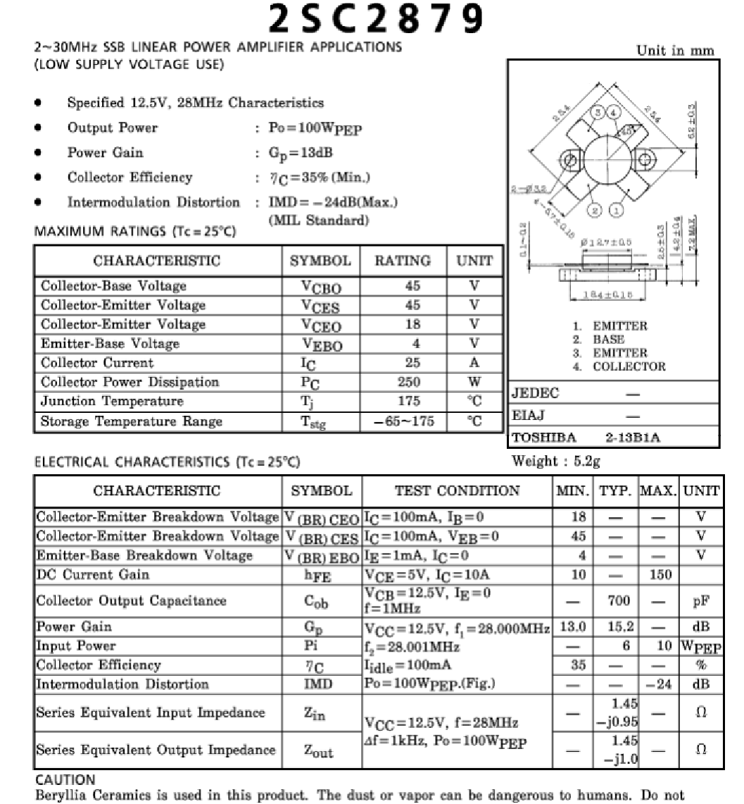

2879 "header" of the Datasheet...my archive
To be honest, it looks like they "cut and pasted" a data sheet and called it their own...

I'm literally shocked and totally have to assume it as false. In order to reach 35 amps at 360 watts of dissipation, the silicon wafer needs to be about a third larger and the gold wires at two of its three terminals have to be a third larger in diameter or more in number... I'd like to see the inside of the first one that blows up trying please?
When I first saw this datasheet, I said to myself "did they think to change the collector capacitance on this datasheet in proportion to the other increases in output capabilities, as we see in all other transistors? What I see is someone must have pointed that out, but possibly didn't have a clue how much to increase that number by. It only went up from 700 to 720 and well within the tolerance of a real 2879.
Guess what? Chances are that number is actually revealing more of the truth in proportion to the others. If not, these other specifications automatically require that the circuit output impedance used with the real 2879 would need to be reduced by nearly one third in order to match the new impedance that must result when 35 amps is drawn at 12.5 volts... I'll bet the darn thing can't handle 35 amps at DC with a pulsed 50% duty cycle, never mind at the top end of the HF spectrum or impedance matching.
If HG really has a new device that can meet their unbelievable published specifications, this is definitely a case where they should have followed NXP's lead and made a simple online video just showing the transistor sustaining 35 amps of collector current in a test that could be repeated by others.
Well, that 360 watts and the IMD THD spec was not military -18 dB? Oh geez, no wonder it's 360 watts - it's pumping out 2nd, 3rd - 4th - ad infinitum...all totaled together?
