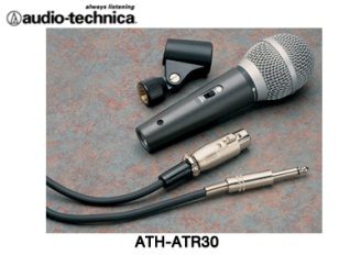

Joemeek 3Q with a cheap dynamic microphone like Audio Technica ATR-30 and a Rolls Db25B isolation box = $200.00 on ebay if you know how to shop :D
You need to hook up the audio from the isobox into the acc input in the back of your radio,you need to find the audio and ground pins to bypass the internal preamplifier
