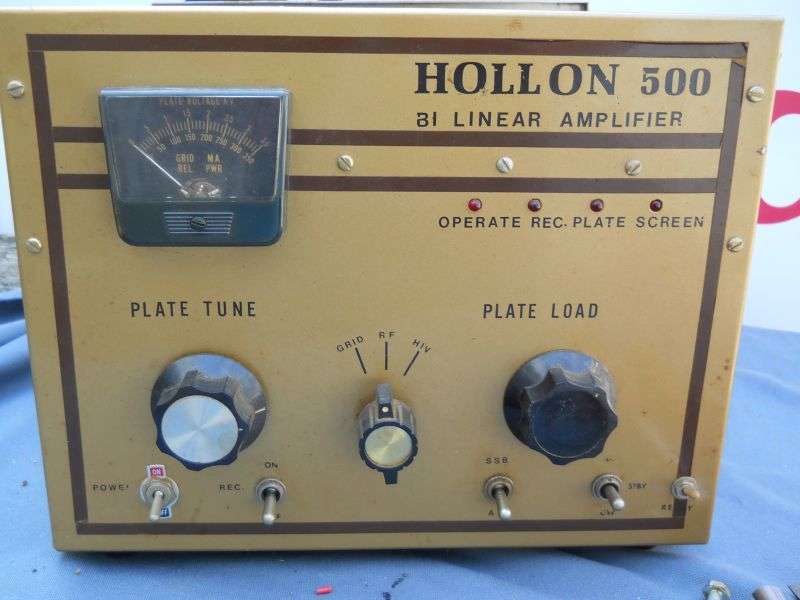

Here is an amplifier made by a guy named "Hollon" some time in the 80s or maybe 90s? Can't remember his first name. Credit where credit is due, he made the outside look really sharp. A hard automotive-grade finish with properly-applied lettering and pin stripes.
But he made up for it by screwing up the inside of the amplifier.
If someone offers you an amplifier with that name and the automotive-grade gold finish on the face, run don't walk the other way. It's not so much an amplifier as a build-it-yourself partial kit. This one is meant to be a clone of the Pride DX300 amplifier.

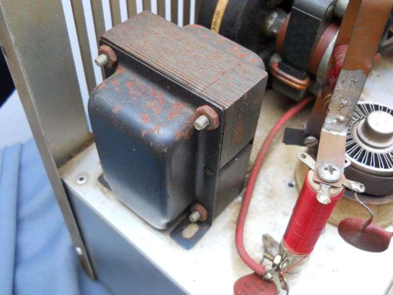

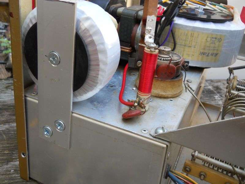

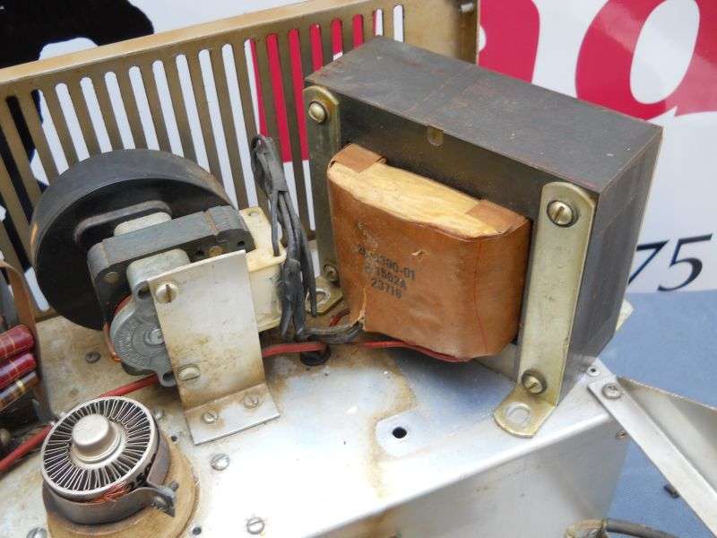

In this case, I can't blame Hollon for the 30-Amp fuse that caused the big high-voltage transformer to roach itself. Our replacement is a toroid type that just barely fits, but does the job. The factory-original transformer was sold by RF Parts until they ran out forever a few years back.
The small transformer provides power to the tube's heater, screen and control grids, relays and LEDs.

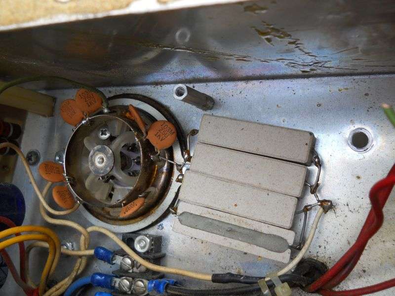

Just one problem. It's the wrong one. These resistors are just a hint.
So this amplifier will get both transformers replaced. DIY for sure. RF Parts ran out of the small one permanently around ten years ago.
Fortunately we also have a substitute for the small transformer that performs like it should. Definite DIY territory now.

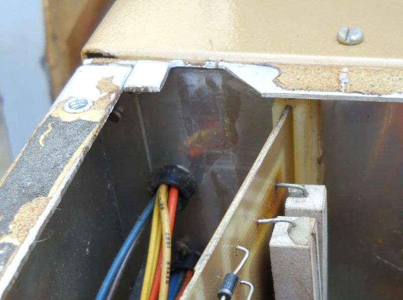

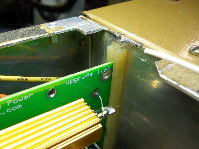

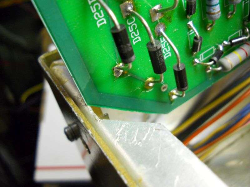

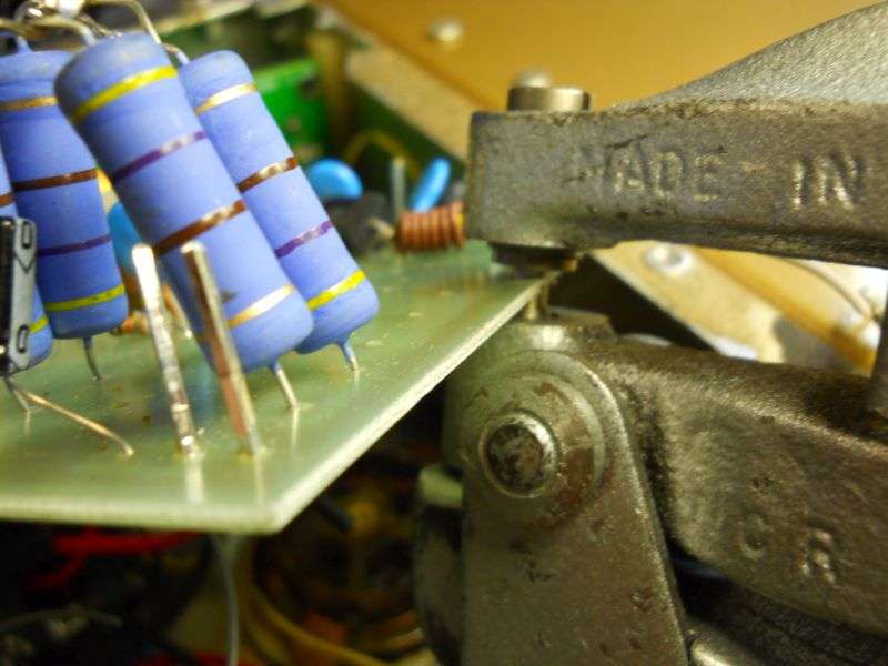

But wait, there's more.! The depth of the chassis front-to-back is a little shorter than the Pride. A standard circuit board is too wide, and won't slide into the guide slots.
The fix is blessedly simple.

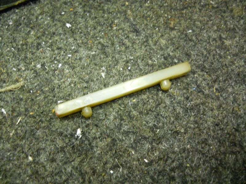

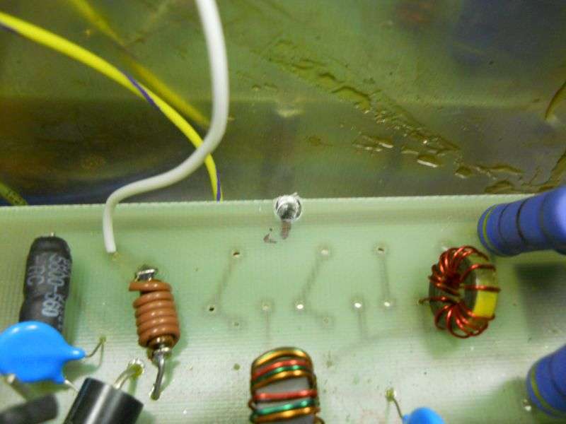

The power-supply printed circuit boards under the deck are supposed to be held in place by the bottom cover. Just one problem. The underside of the chassis is almost an inch deeper than the Pride was. Gotta restrain the circuit boards from flopping about.
The guide slots were held in place by some long-dead glue that just let go.

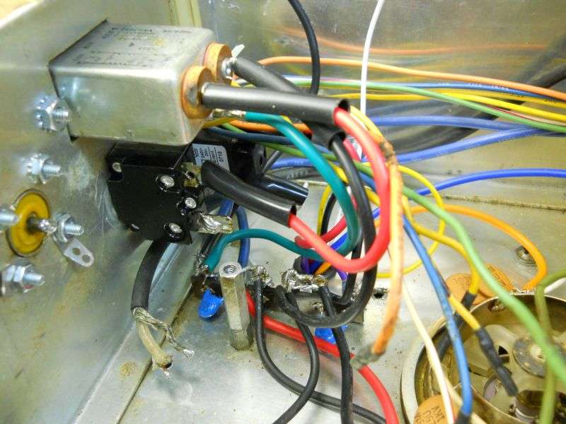

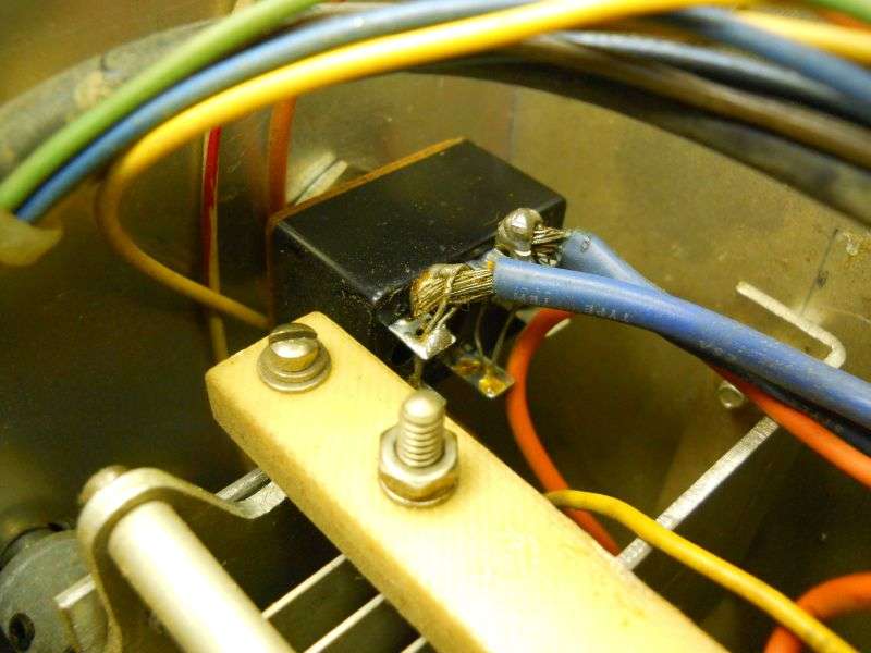

But wait, there's more! How about the power switch? Makes me wonder how it lasted this long.
Holl500_pwr_sw

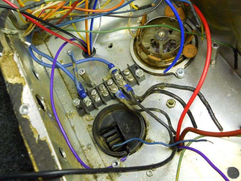

One other "feature" I don't care for is his habit of using a barrier strip to organize the 120-Volt primary circuit.
I just prefer to have all that stuff soldered securely.

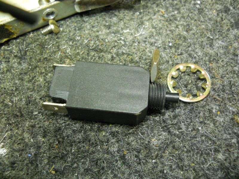

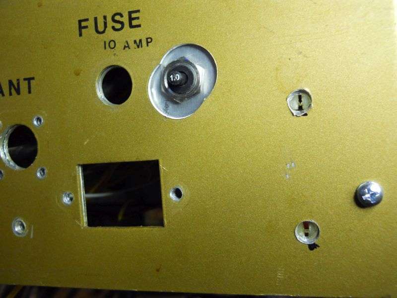

And yes, it has a circuit breaker where the fuse holder used to be. No more "No-Blow Fuse" follies for this amplifier.
The original DX300 had a 1/16" thick rear panel. This thing has a sandwich of the chassis box and a separate rear panel.
Just one problem. The small circuit breaker's threaded bushing is not deep enough for a panel that thick, plus a lockwasher.
Had to remove the rear panel and punch a clearance hole so the breaker's nut can be tightened. Shoulda been more careful getting the hole in the chassis line up with the clearance hole in the back panel. You can't simply drill into two layers of sheet metal at once. Just doesn't work like you think it should.
