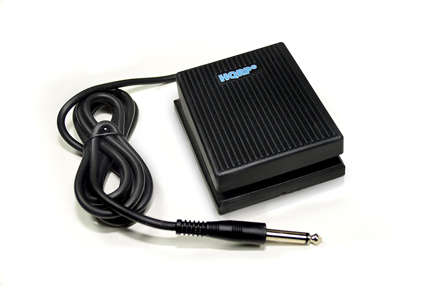

Here's another cheap suggestion, use a digital piano sustain pedal. The cheap ones are square and small in size. These are just the right size to sit on the desktop or you can try it as a footswitch to see if you like using it in that manner.
These switches are spring loaded non latching momentary on and have a 1/4 in. plug ready to go if you have a Heil mic cable with PTT pigtail, or rig one up yourself of course.
You can buy these pedals locally at music stores and online for $15 or less.

That's great ! I will have to look for one thanks !
