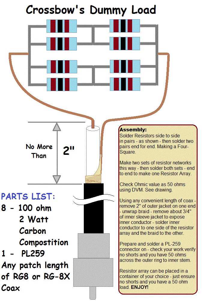

Hi, I made one years ago, just like in the description and diagram above, but I constructed the dummy load with carbon resistors, not wirewound higher power types.
You cannot use wirewound types as they are very inductive at RF frequencies. Even the so-called non-inductive wire wound types still have enough inductance to be useless.

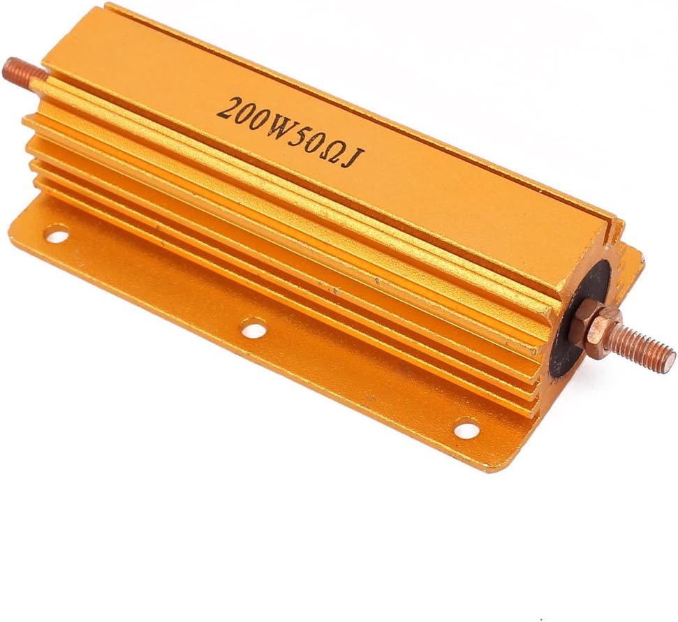

Oh dear, this is bad news. Here's the spec of the one I ordered:
uxcell 5% 200W 50 Ohm Wirewound Aluminum Housed Clad Resistor Gold Tone 12cm Long
by uxcell
Product Name: Aluminum Resistor; Type: RX24; Resistance Value: 50 Ohm
Power Rating: 200W; Resistance Tolerance: +/- 5% (J); Lead Thread Dia: 4.5mm/0.18"
Total Length: 12.8cm/5"; Body Size: 10 x 5.1 x 2.8cm/3.9" x 2" x 1.1"(L*W*T)
External Material: Aluminum; Color: Gold Tone
Net Weight: 188g; Package Content: 1 x Aluminum Resistor

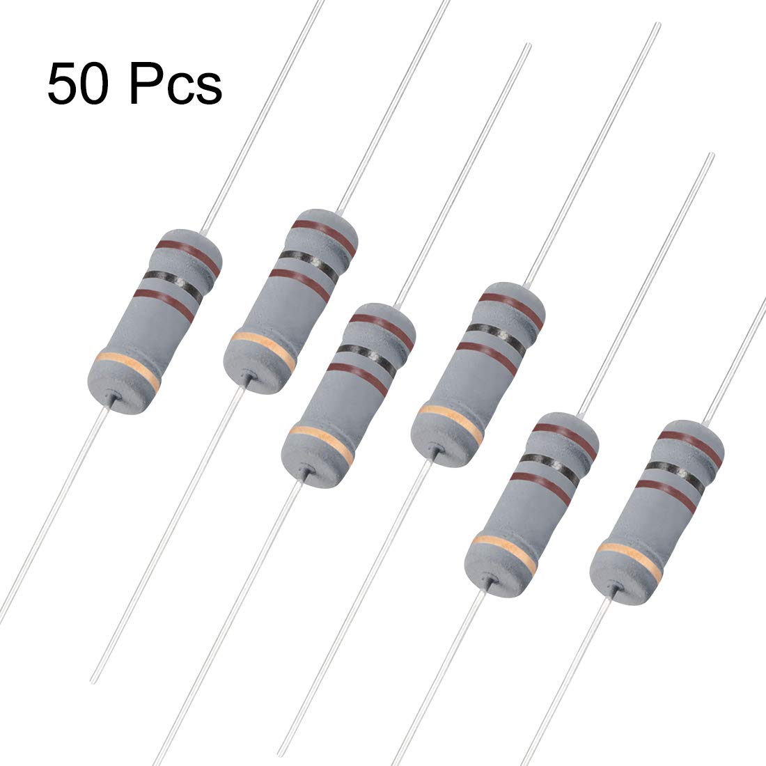

So back to the drawing board in terms of resistor choice, glad I asked before using wire wound :) . I was thinking about this:
50 pcs 100 Ohm Carbon Film Resistor, 2W 5% Tolerance Carbon Film Resistors, Axial Lead
They come in a pack of 50, so I was thinking groups of 10 in parallel is 10 ohms, and if I put 5 groups in series then I'll have 50 ohms.
I'm not sure exactly how evenly the power is disappated across them, maybe that arrangement it would handle short bursts of 100W dry? Then once in a can with mineral oil it could handle a couple of minutes of 200W? Thoughts?
Thanks

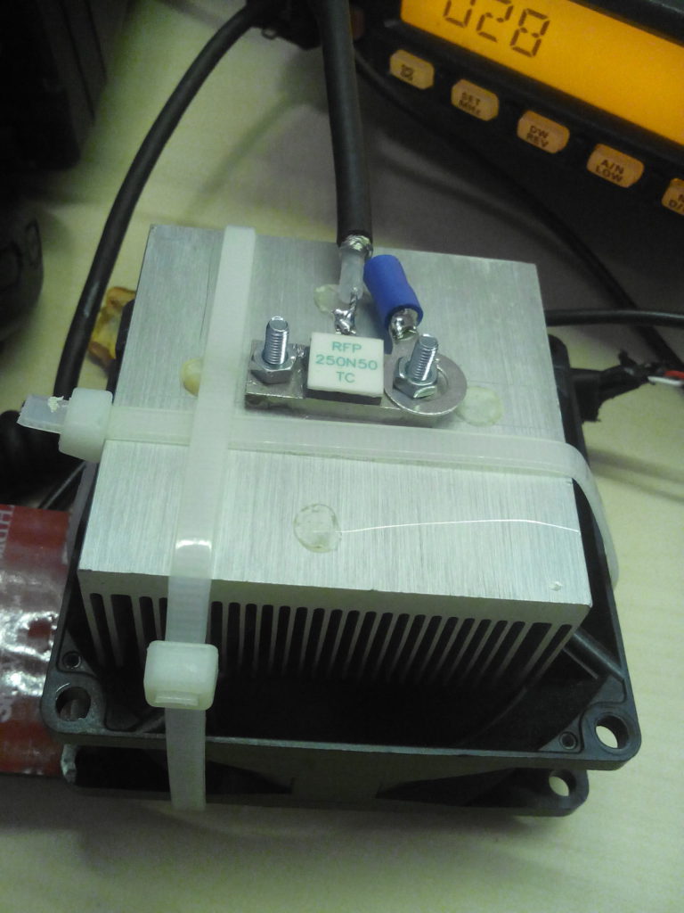

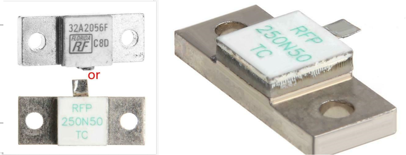

I like the last option. Using several dozen low power resistors means you need to keep the lead lengths as short as possible to avoid stray capacitance and/or inductance which will make the load worse as you go higher in frequency. I have a pair of 100 ohm 800 watt Florida RF Labs ceramic chip resistors wired in parallel to provide 50 ohms at 1600 watts. They are mounted on a huge heatsink that measures about 10 x 15 x 2 inches. With 100 watts continuous into it I can hardly raise the temperature of the heatsink unless I lock the key down and walk away to watch a movie.

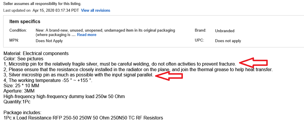

https://www.ebay.com/itm/383339481383
Might want to read the fine print near the bottom of the page - its' a little too delicate for many applications unless it's nailed down somehow - not suspended in a fluid...uses a Silver Strip - be gentle...for its part of the technology that gives it it's ability to be a low inductance resistive path. Even into the UHF which many of the larger Carbon Compositions cannot be due to size and substrate.

For simplicity, I built one like this quite a few years ago.
https://www.qsl.net/kf8od/load.html
