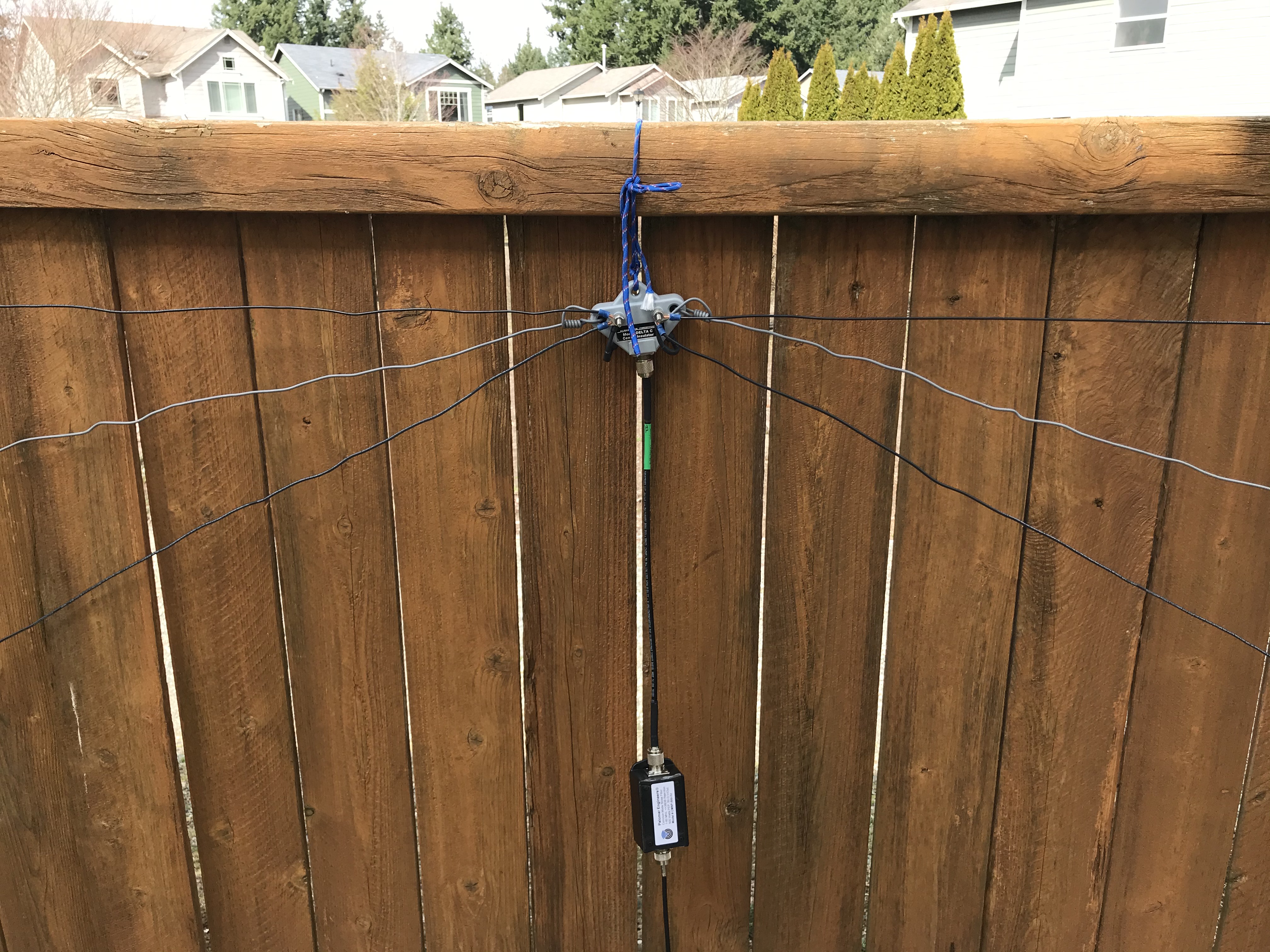

I am using NVIS with a 40,20,10 meter dipole on my privacy fence. The antenna is about 5 feet off the ground at the apex. I work people from 10 - 1000 miles away quite easily. I have also been able to work Alaska, Hawaii & Japan when the conditions are favorable. Experiment. The antennas don't cost much money and give great satisfaction when you get them right.
there is no NVIS @ 10 and 20 meters, and very little @ 40.
At higher solar flux values NVIS works on 40 quite well. It all depends on the value of the Critical Frequency.
To answer the OP's question, NVIS will probably be the most reliable between the two of you on 75/80m with antennas at about the 25-50 foot range at the apex and sloping down to anything above 15 feet at the ends. In all but the deepest days of winter depending on your latitude and the solar flux values, you'll have almost 100% reliable communications.
