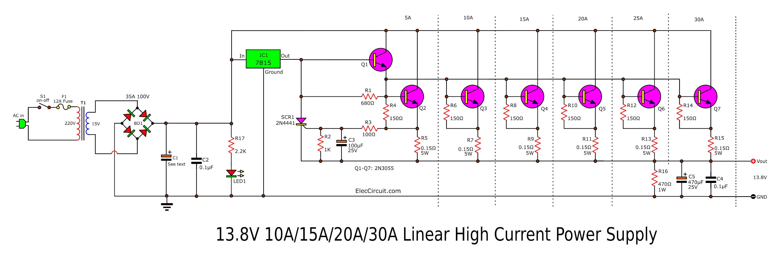

One of the locals I talk to every morning purchased a 150 amp transformer power supply to run his linear amplifiers.
The problem is this power supply puts out 20 volts and we need to get it regulated down to around 15 volts.
What is the best way to do this?
Show us schematic of that PS
If it is like the majority of unregulated CB style of supply it will be a big transformer, several bridge rectifiers on a heat sink and a couple large caps to filter out some of the ac ripple.
And no schematic included.
It will require building a regulator circuit with pass transistors to handle the current.
Most of them float about 19-20 volts unloaded and " pull down" to 15 or 16 volts under load.
I have seen these in class c base amps like x-force and the like.
This is why they are cheap compared to regulated supplies.
Here is a 30 amp circuit for reference.
Jeff
20 volts DC, no-load doesn't give enough headroom to regulate to 15 volts. You would need a transformer that floats (rectified and filtered) around at least 25 volts DC with no load. (transformer that delivers 18 volts AC, RMS)

And you do not want the unregulated voltage to be any higher than necessary because the pass transistors in the regulator circuit must dissipate heat based on voltage drop across them and total current thru them. My Tripp-Lite PR-40 is rated at 32 amps continuous and 40 amps peak. The pre-regulator voltage is about 22 volts. It is set at 13.8 volts output and runs quite cool. The upgraded filter capacitor I installed is 100,000 microfarads so it helps with voltage sag on the pre-regulated side as well.

2N3055 pass transistors are a LOT cheaper than a pair of finals for a 100 watt amateur radio.
I would never use an unregulated supply on a radio especially!!! 13.8 has been the standard on most supplies that are not server power supplies for decades.
Back in the old days like when I was in H.S. and you could buy Toshiba 2SC2879's for $9 to about $12 in bulk knowing that they could stand up to "volting" it was forgivable. Not true today!
You will definitely want to build a regulating circuit.
