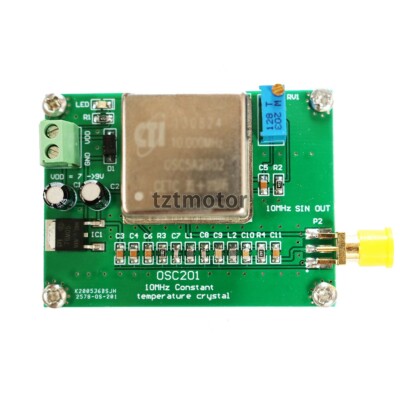

i bought one of these years ago:
I checked it against a known calibrated lab counter we had at work and the damn thing was dead on to .1hz.
Ive been using it since then to check calibration on my counters and i can say that it is still accurate to at least 1hz and none of my counters have needed calibration in the last five years.

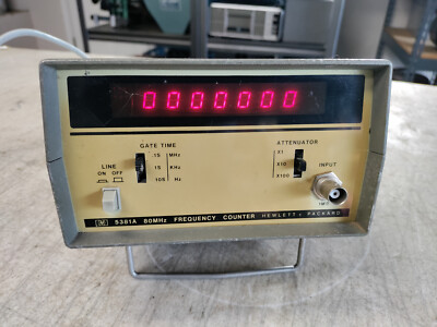

Here's a little known "secret".
This counter will do 1hz resolution with a 1 second gate time.
it will also do .1hz resolution with a 10 second gate time.
yes it's only 80mhz but for those who only really work on HF stuff it will work just fine.
they are old.
however, there are only two electrolytics in there to replace, and with a fresh calibration you are off to the races!
I have one of these given to me by a friend and i absolutely love it.
just find one with all the LEDs working!
LC

With only 7 digits, how does it display 27MHz to 1 Hz resolution? Does it drop off the most significant digit?
