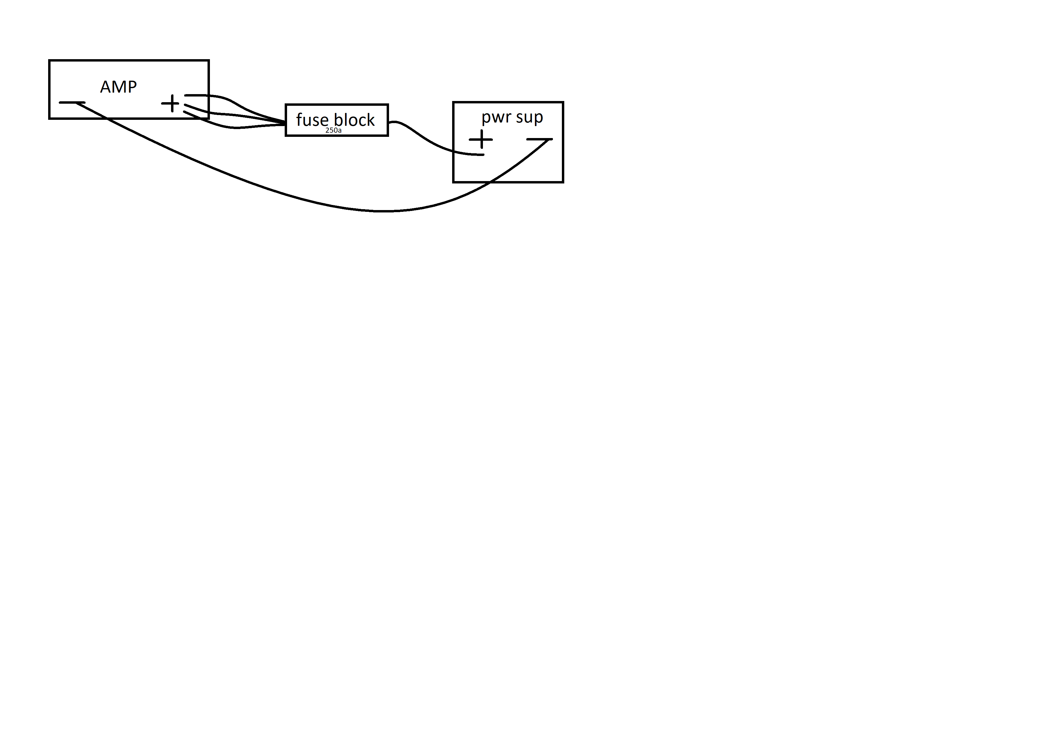

Hi shockwave, thx for the input, this 1 is going to be setup as base unit so i was thinking something like this ?

The diagram you have drawn, is an acceptable way to place a fuse between your amplifier and power supply. If there is any length in the wire, keep the fuse closer to the power supply.

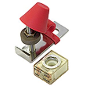

Another source for these large fuses is a marine supply store. They are often used as the main fuse on a big boat. If you don't live near marina, order online.
I use WEST MARINE as available. Markup isn’t friendly, but as a national chain they’re reliable.
Was just in there recently for some ANCOR 6-AWG and BUSSMANN BATT Termination fuse.
No splice. Attach at BATT terminal.
