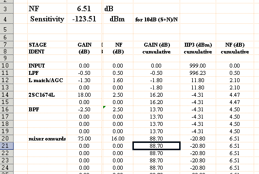

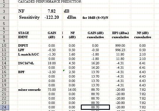

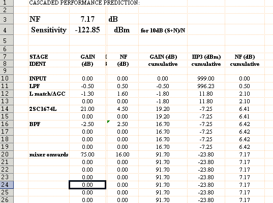

In terms of white noise there's two main issues at work here.
There is the obvious 'noise above thermal noise' due to the system noise figure and this limits sensitivity. However, with today's noisier bands I think an 8dB system noise figure should be fine.
But there is another issue with the Uniden radios and that is how they do the AGC.
On most Uniden radios the AGC acts in two places. At the first IF amplifier and also at the AGC diodes at the front end.
On radios that are dual conversion on AM (like my mk2 148GTL-DX) the AGC acts at the second mixer as well as the AGC diodes.
The basic idea is the early part of the AGC range acts on the IF amp (or mixer) stage and then for bigger signals the AGC diodes start to come into play as well.
It's arranged like this to try and preserve the larger signal to noise ratio of bigger signals and make the radio sound cleaner as signals get deeper into the AGC range.
However, for these radios it doesn't actually preserve signal to noise as much as hoped. This means that on AM/FM the radio will sound hissier than it should as the signals get bigger and the AGC acts more and more.
Changing the front end amp will do little for this because it's the falling gain vs rising noise characteristic of the variable gain IF stage (or mixer) that is causing the radio to 'stay noisy' as the AGC starts to level the gain as the input level gets bigger and bigger. This is all tied in with the way the radio is designed and to do something about this would involve a fair few mods.
One thing that is annoying about the newer radios is that they have copied the crude AGC system from these early Uniden CBs and stuck with it. This means even the newer radios will show this noise problem.
I could come up with ways to improve the AGC characteristic but it would mean quite a few changes and there is the risk of making the AGC loop go unstable unless a specific set of mods are done for each model of radio.
The easiest way to prove this point on my mk2 Cobra 148GTL-DX is to disable the AGC and look at the S/N ratio on FM mode for signals across the equivalent of the first 20-25dB of AGC range.
On the standard radio (with AGC still active) the radio remains quite hissy as the generator is cranked up.
But with AGC removed the hiss falls away steadily as the signal gets bigger. A marked difference.
I've seen people blame this problem on the PLL (they say it's noisy?), on the CPU in radios with CPU and on the audio stages and also on the receiver front end noise figure.
In reality, the noise is a byproduct of the AGC system as it isn't designed to preserve S/N ratio very well.
