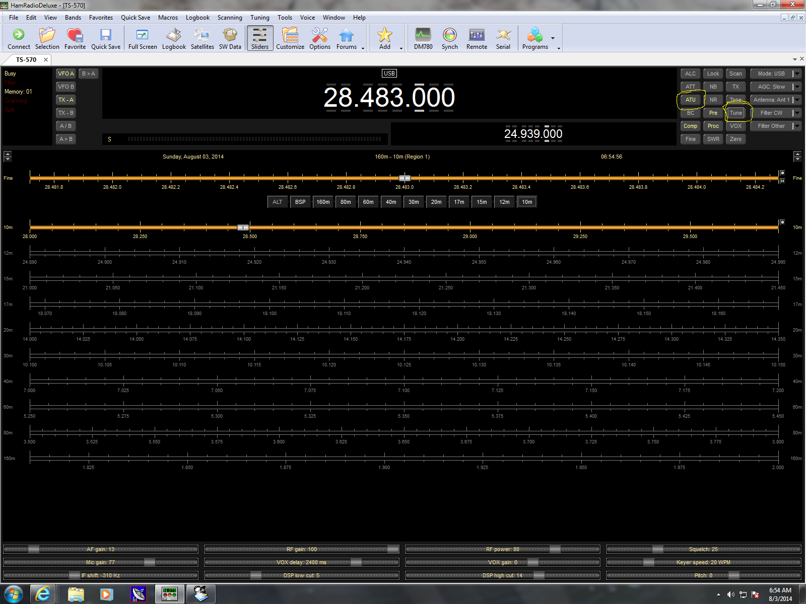

I also Use HRD the free eval.. vers 5.24.0.38, The rig is a TS 570D(G) (Older vers of TS590).. I can use the ATU in HRD to tune the rig.. See if you have same controls in upper right of Radio view as I do Circled in yellow.. My problem is connecting to radio Have to do it manual everytime WILL NOT connect on its own (auto connect) Never a problem with my TS 690
Hope this helped

I have the buttons that you have circled, but clicking tune does nothing.
I sent an email about this issue. Here's the response:
Thank you for contacting us.
Speaking directly with the programmers, here is how it should work:
There are two buttons associated with the auto tuner. One labeled "Tune" (to be called Tuner in a future update) toggles the Auto Tuner on and off. The TX Tune button activates the auto tuner and initiates the tuning sequence.
If you do not see the "TX Tune" button on the rig control, let me know and I will explain how to add it.
73.
When I click "TX Tune" it just induces a carrier until you click it again. Does not trigger internal tuner.
