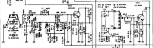

Touching an electrical component with your finger (usually) adds capacitance and or resistance to the circuit so you may want to check the caps and resistors related to the selector.
If the channel selector is "lobbing" - bent shaft, even ever so slightly - the pressure from the rotary indents and the fingers to the wafer of both can force the finger to wafer contact to drop out due to lack of spring action / tension.
The problem becomes worse as age of where this pressure from the seating occurs - if the wafer is corroded or pitted - there may not be much someone can do except take it apart and do more cleaning to it - one wafer or its wiper arm could be pitted beyond repair, causing the drop and you have to place pressure on it.
This does happen in radios that have sat in a condition prone for moisture or excessively dry - this can make the wafers copper foil "stick" to the finger that bends down to it to make contact as the wafer rotates. So if it's developed such a "pitting" condition - it can cause this missing channel condition.
The above may not be correct to the "Table" for your radio -
but the concept here is to show that the pins to wafer / slide
repeat in a certain way.​
  • as @144inBama has suggested, check your main board and all the easy access stuff you can get at first.
  • The condition appears to repeat on the 4-5th "detent" so it may be the shaft is still got dirt between it and the housing and the debris rolls right along with it.
  • This can also occur from radios that have been "face planted" where the radio fell and landed on the channel knob - bending the shaft and your result is a repeating pattern of no-lock on specific groups of channels.

Don't give out accolades just yet, this may be more of an underlying condition of broken wire conductor inside when the strands inside the wire are corroded from excessive heat/reheat of a soldering iron and the flux from the solder carboned up and now has slid under the wires' sheath and literally plugged the wire up.
Not all stranded wire 50 feet long on a spool contains strands of 50ft of continuous wire strands. A few (hundred) might overlay one or two (hundred) others... :eek:
The 139 - was not specific in details but the 139 is a xtal-based unit while the 139XLR uses the LSI (PLL) so to the casual observer to say crystal - might not be as far off as you think - but replace the wire or if it's in a ribbon - just use a small gauge wire and jumper the one that's affected - see if it goes away. Then you KNOW you have a bad wire in the Harness - just as bad as no receiver from a botched CB/PA switch or broken busted squelch wire....

I tried the jumper and still no joy. When i soldered on a piece of wire about six inches long and as before the only way the channels worked was to touch the end of the wire? This is driving me crazy
