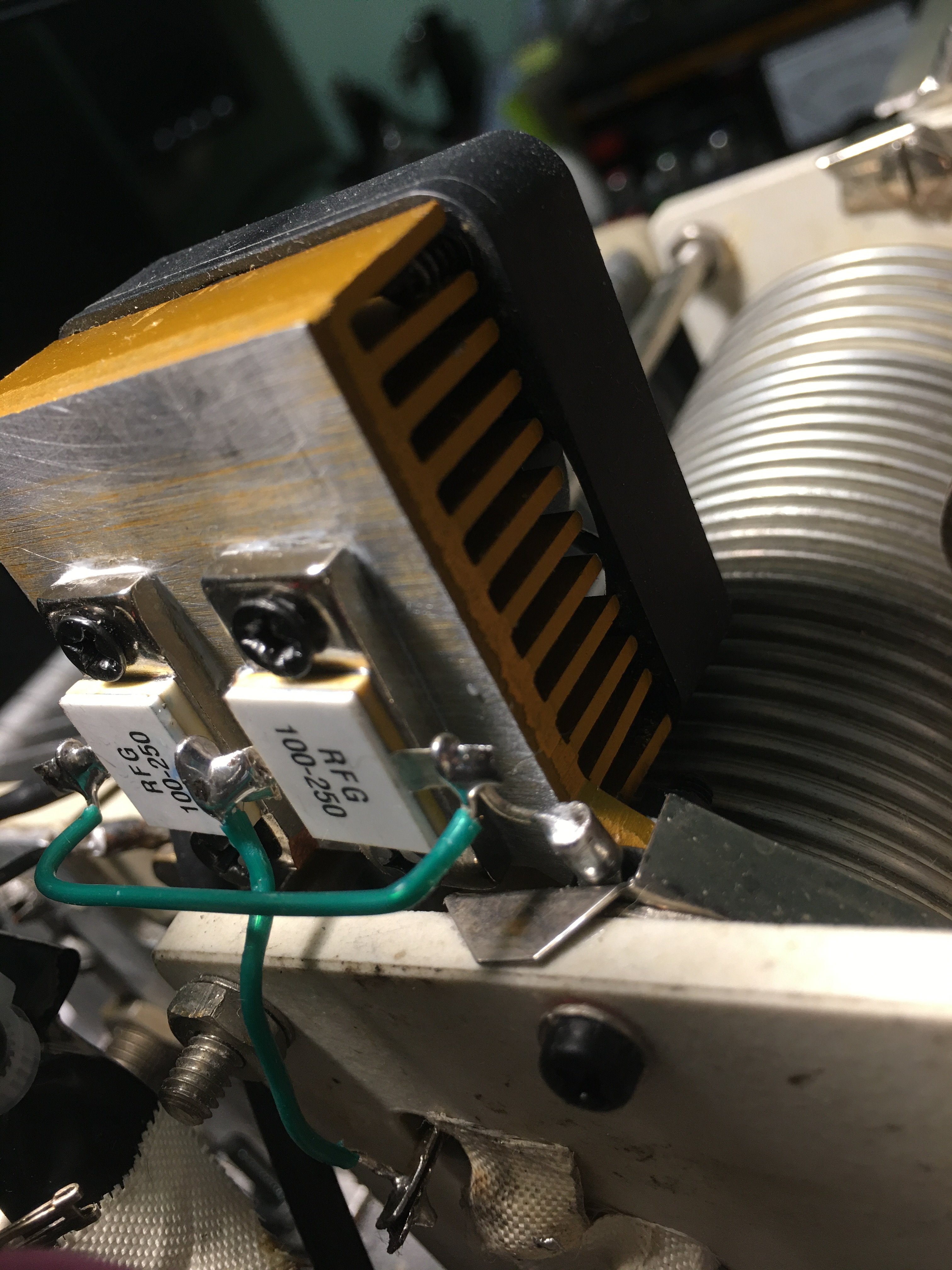

Brondon 7861 suggested decreasing the Termination resistance and I'll try that next if the 6A10 diode doesn't survive. Nomad HVPS board surviving the stress and I needed awhile to realize the B minus diode going open is from shorting the unused turns of the roller. I ordered another 100 ohm 250w RF Termination resistor to bring down total to 33R. Heatsink/resistor combo pic attached.
I had to reorder the Term resistors because the first R's used the flange as a terminal placing heatsink in circuit. The new ones (pic) have terminals for each end of resistor. Heatsink & fan decreased the temp a lot so maybe I'm good to proceed.
I remain surprised that I all meter readings stayed the same despite the RF Term R's getting so hot from shorting the unused turns. I guess it puts more stress on the HVPS and the B minus diode to ground was 1st to open from the added current. ZSAC unaffected too.
