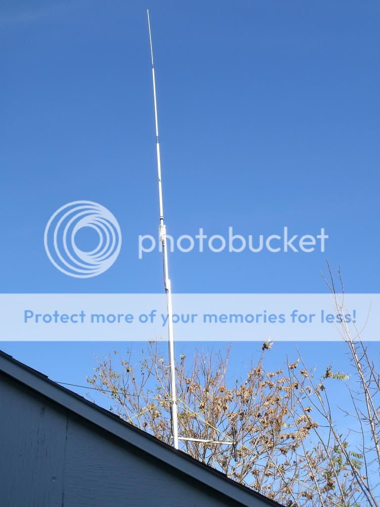

I need a new base antenna
here is a pic of my antenna

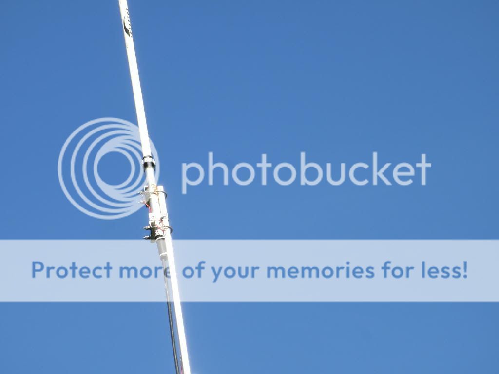

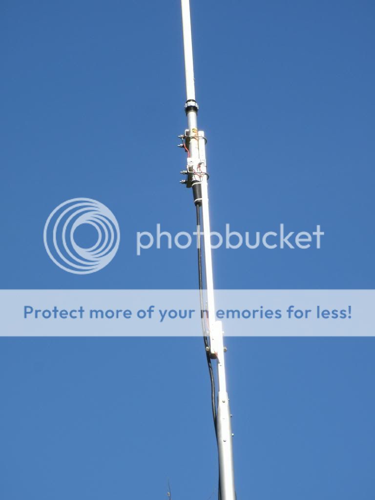

the rubber sleeve is not in the way of the drain hole I even installed ground straps on all the joints..

Well, I think the problem is the mast, and length.
I would sort reins pulling three insulators at 10 feet from the anchors and mounting the antenna.(first ground strap)
These three reins, both would work as a ground plane.
He always did so to my monopoles and the result was 100 x 100 good.
