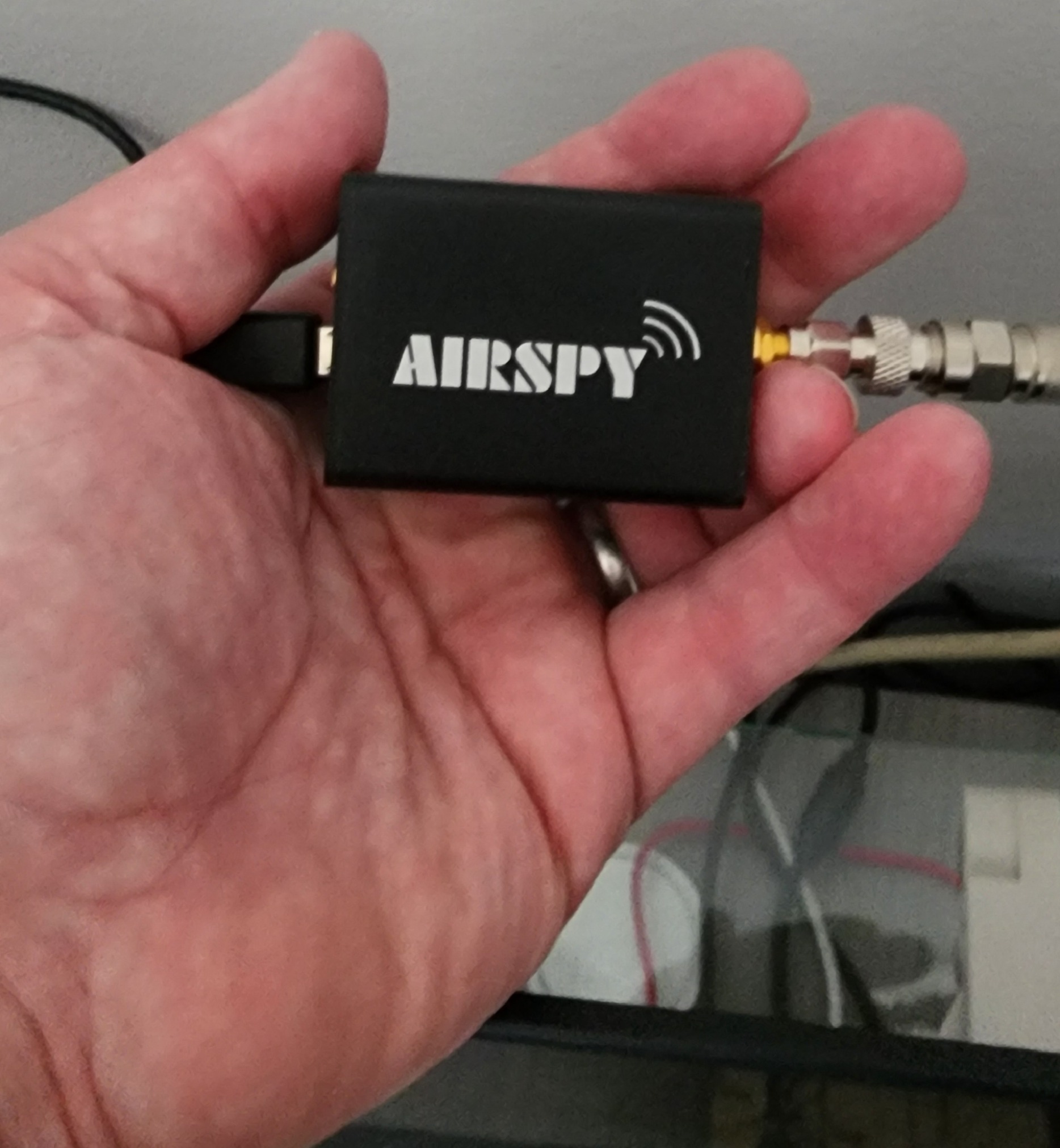

I also had existing TV coax run into the den where I had a DirectTV receiver which was ditched. This coax was used for the Airspy R2, which covers 24-1700 Mhz. This device is more than an inexpensive RTL-SDR, but the performance specs are amazing, including 8Mhz RX bandwidth. The device is really small.

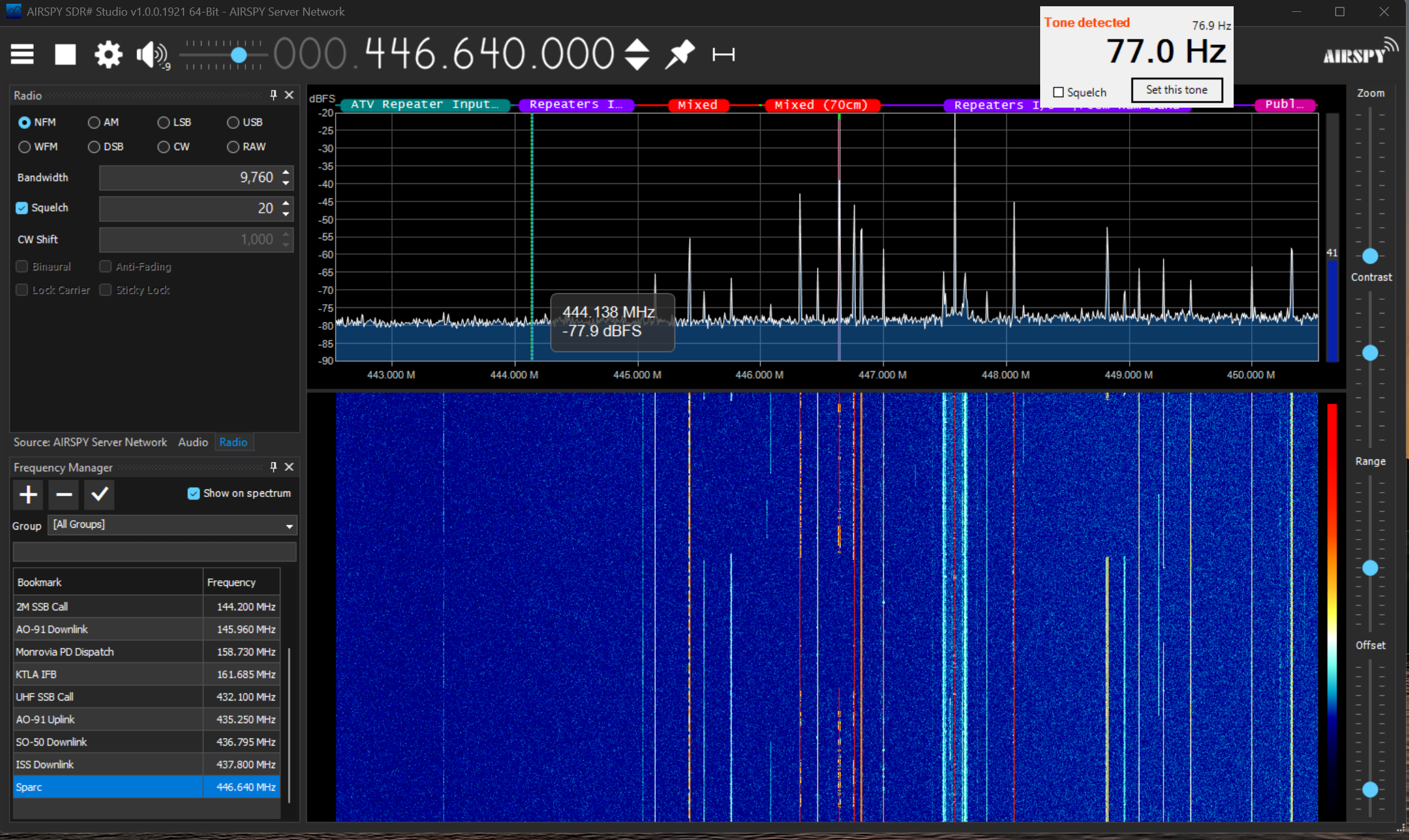

You can run Airspy SDR# on just about any platform that can support the hardware specs, but since I had a Raspberry PI400 just sitting in the drawer, I decided to use it to run a Spy Server with the Linux ARM64 app which is free. The installation instructions were straight forward, and in a few minutes I had SDR# 64 bit on my Windows 11 laptop connected to the server over the wireless network. I've installed several SDR# plugins, including Frequency Manager, the CTCSS and DCS decoder.
If desired, you can use a public DNS with either port-forwarding or a VPN to make this setup available over the internet. There are security settings to make it publicly available, if desired. I like this setup because I can take my laptop anywhere on the property and monitor anything in the frequency range.
