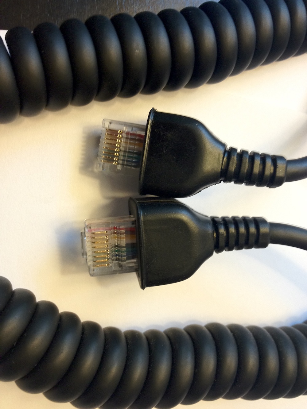

Here is an extra cord I have from a Yaesu FT-817
If you look, the colors are the same left to right so it is not a crossover cord. If the Icom is the same, non crossover, then any non crossover cord will work, even a short ethernet cable.

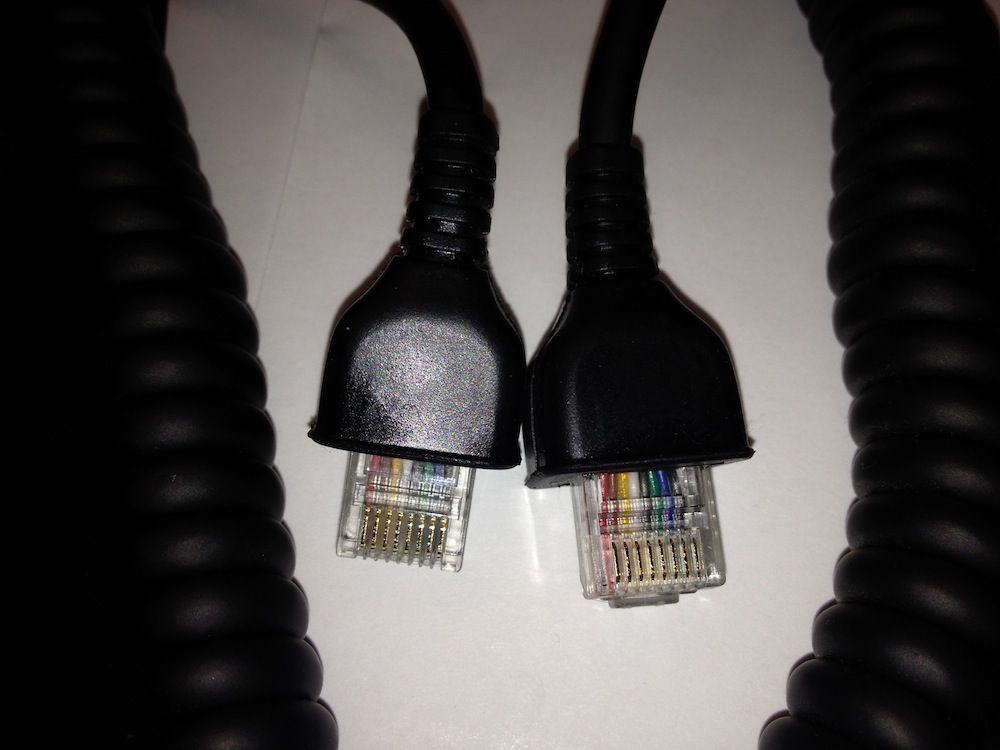

Well the mic linked above showed up from China today...
Not only is it a double RJ45, but they're wired the same at each end as mentioned above, AND it came with a genuine (I think) "Made in Japan" Icom HM-133 mic.
:thumbup:
Problem solved...
