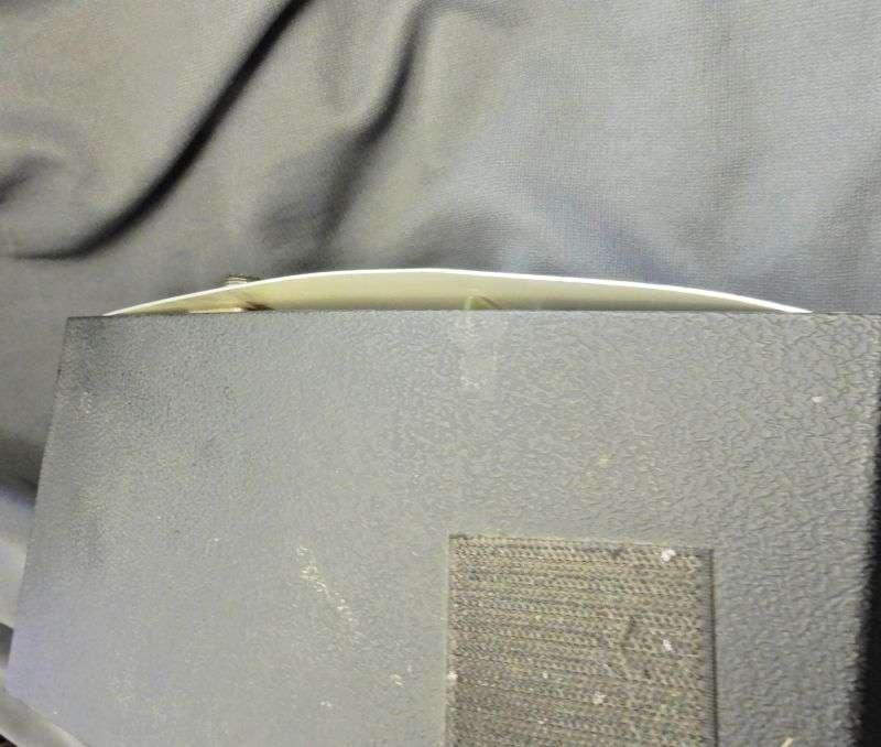

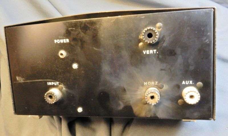

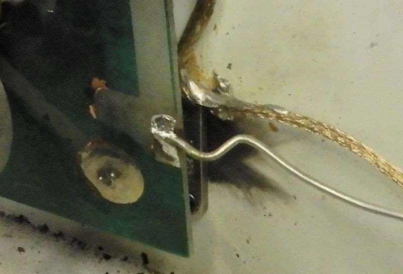

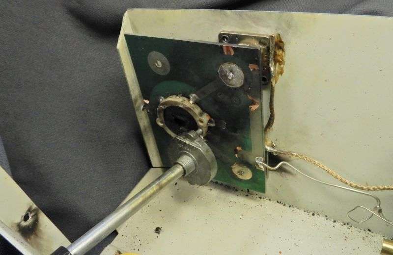

Adopted the habit of recommending you plug all the station equipment into one outlet strip. That way you only need to pull one plug out of the wall when you disconnect the coax. I've seen my share of kabooms that came down the coax.
Like this one.
The rear panel was bowed outwards visibly from this angle. The top cover was bowed upwards to boot.
Arc-flash scorch marks on the rear.
The connection from connector flange to the chassis metal got pretty hot.
