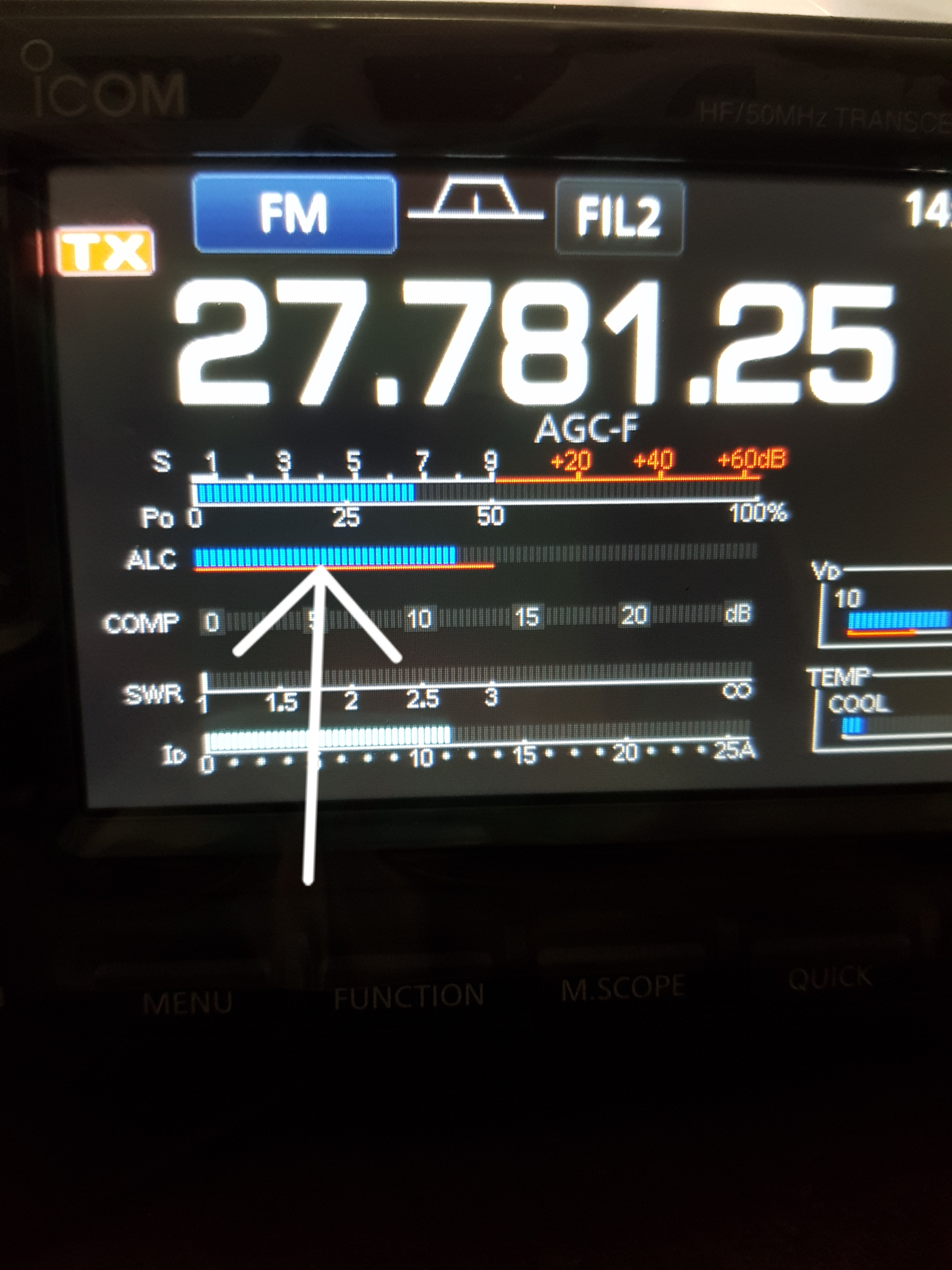

I've only recently bought a 7300, & I'm curious as to whether or not the ALC (blue bar) should be lit up when transmitting in FM mode.
As far as I'm aware, ALC is only used in SSB mode - but on mine, the blue bar lights up when keying in FM mode.
Is this normal behaviour, please?
Also, when modulating on SSB - is the general consensus to totally avoid going into the red with the ALC, or will it be OK if the odd peak goes into it?
Many thanks.

ALC: really has no purpose on FM...audio on FM is thru the "deviation" control circuit.
However depending on rig, your "mic gain" still has some control.
SSB: best to keep the level where it runs about 75% of scale. Tickling the "Red" ok in most cases, but should not be "habit" forming.
When using compression:(prostrasher) keep about 50-60% ALC and run about 5 db compression...seems to work well for most...
Set ALC without compression...then add prostrasher do not change mic gain level.
My 2 cents worth
My audio settings for other bands total big difference than 6m...(10 meter setting very close)
I use narrow bandwidth (2.4kc) and very sharp high end audio on 6 meters...cut off low end audio at like 700 cycles ...increasing mid-range and high's

The 7300 has a reputation for being overly aggressive with the ALC on SSB, limiting the overall average power as a result. Rumor is that Icom did this on purpose for "cleanliness". Follow the procedure that BJ outlined but try to keep the ALC meter reading around 50% scale. On FM, just ignore it.
