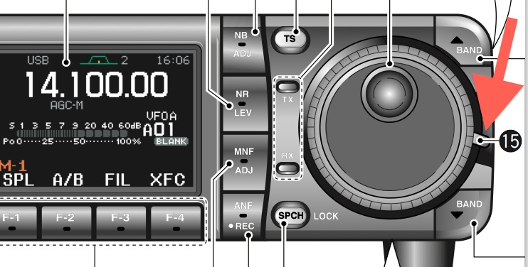

Did you slide the VFO tension adjustment to click mode?
Look at the little black tab to the right of the VFO knob that slides to adjust the tension, it has a click mode as well.
Page i-2 and i-3 of the manual
I know about that. No its coming from the speaker.... I'll make a video of it this afternoon. Its really bad on AM & FM.

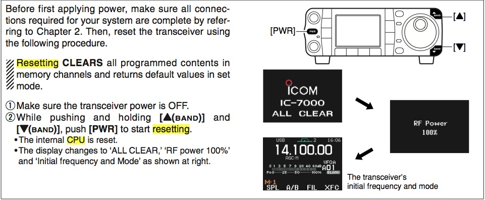

Have you considered trying a full reset?
Page 25 of the manual
Before I do that, I have a cable since I use the radio via H.R.D. Can I back up my programmed frequency's some how ? I don't have any software and it would really help to get freeware....cause I have a feeling im going to be slapped in the face by icom with a huge repair bill.
do you have it hooked up to a computer for CAT control ? if so that is where my money is. crap i just read you above post.. disconnect your CI-V control line.
Woa the reply woke me up. Let me try it right now. I did forget to unplug that cable.
