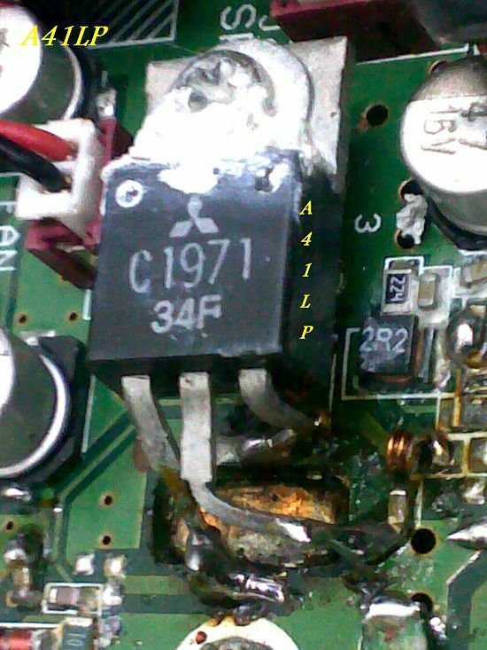

After the power transistor 2SC1971 blow up I have replace it with another 2SK3075. This transistor is more availability and easier to get, and at the same time it also get a little more power, from 68 to 71 watt.

Never understood why ICOM & Yaesu used these finals when they are only rated at 70 watts output & they sell the radios as being 75 watts output? Pure stupidity on their part & scamming the consumers who don't know any better.
