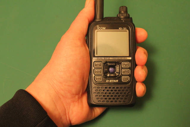

The radio seems to be a solidly built, rugged little radio. It's got an IPX7 rating, which means that it can withstand being submersed in 1 meter of water for 30 minutes. Does anyone want to see me do a dunk test? :)
The radio really has a nice overall feel in your hand; it's not too big or too small.

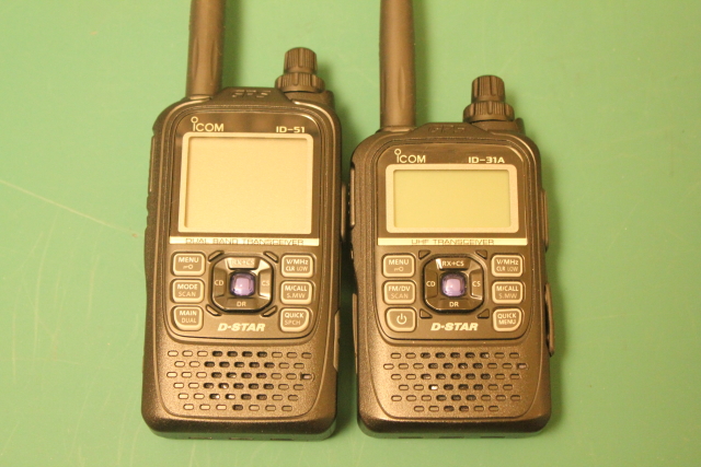

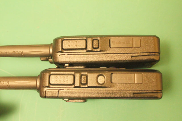

Here are a few pictures of the ID-51 next to the ID-31 for size comparison:
As you can tell, the main reason for the difference in size is the larger screen to accommodate dual VFOs.

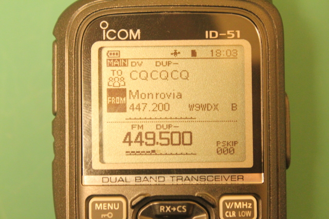

The screen really is very nice, crisp and clear. The backlight is off in these pictures and my photos don't do it justice:
Here's what it looks like with the AM/FM broadcast receive enabled while monitoring VHF/UHF, which is a feature the ID-31 did not have:
The extra height on the new screen is really helpful while using the GPS since it can now display a little more info without scrolling. Here it is display the bearing and distance to a waypoint, which just happens to be Icom's headquarters:

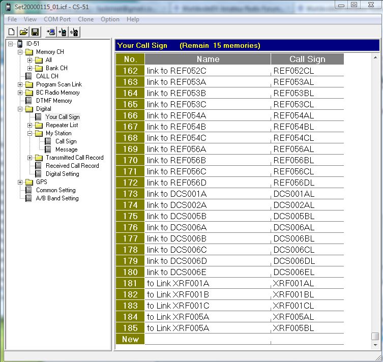

Like the ID-31A, the ID-51A comes with programming software to help you manage the radio. The software lets you configure every aspect of the radio including basic settings, memory groups (more on this feature later), reflectors, and digital repeater settings.
Here is an example of the software navigation, showing the various settings groups on the navigation tree to the left with a list of reflectors that you can maintain to the right. In this example, you can see that I've added a few DCS and Xreflectors.

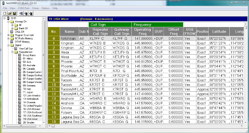

In this example, I've pulled up the list of D-Star repeaters to edit. You can add your own and edit the built-in list:
The software makes it very easy to edit the various settings stored on your memory card, but it also lets you read the values directly from the radio using a programming cable and clone to another radio. As a whole, the software is terrific. However, there is one thing I don't like - there is no way to read in common settings from an Icom ID-31A radio or file and apply them to an ID-51. I tried to figure out a way to import my D-Star settings and also my custom reflector lists to no avail. It would be really nice if some updates to the software were released that would allow some import/export features between the two similar radios.
