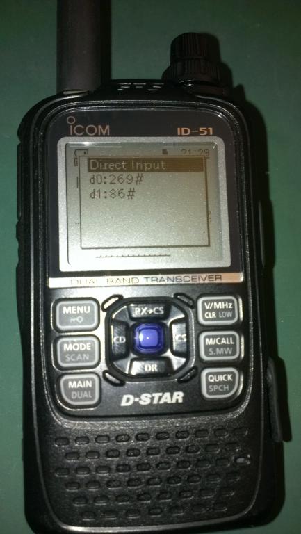

DTMF Capabilities
While it's not obvious by looking at this radio, it does feature full DTMF capabilities even though there is no keypad. You can store up to 15 DTMF memory strings or enter DTMF strings on the fly. Here's how:
The first way to key the radio with a DTMF string is by using the Quick Menu. While on the desired frequency, Hit Quick>Scroll to DTMF TX, then "Direct Input". Hit the center button on the 4 way control and then use the dial to select the tone and the right keypad to perform the sequence. While using this menu, you can also select from one of the 15 stored DTMF memories. Either way, use the center blue button on the keypad to trigger PTT and the DTMF sequence.
To store DTMF memories, hit MENU>DTMF/T-CALL>DTMF Memory>Desired memory. The memory locations are stored as D0, D1, D2, etc. Scroll to the desired memory using the frequency dial, hit the QUICK button and then EDIT. You enter DTMF strings in the same manner as the on-the-fly method
You send stored DTMF memories, you simply select QUICK>DTMF TX> and then scroll down to the DTMF memory (which also shows the string on the screen at the same time) and hit the blue center button. The radio keys and sends the string.
