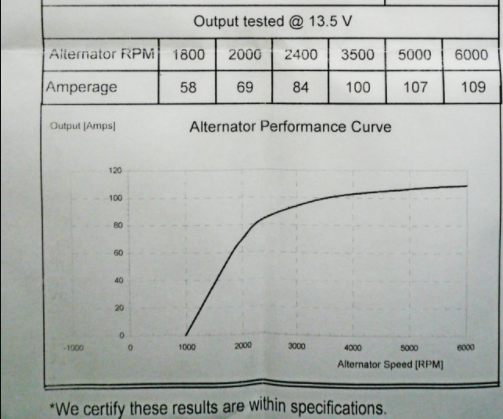

Who made the alternator? Did they give you a dyno sheet with it?

Well like 999 said that 110 alt isn't 110 until higher RPM. It may be a lot less at idle and with the heat and everything else it may be right at the limit. If you kick the idle up a few hundred RPM and the problem goes away then you might be able to swap on a smaller pulley to shift that number down. Aeromotive and Powermaster make them for common types. But this again is after you rule out bad connections, cables, batttery etc etc.

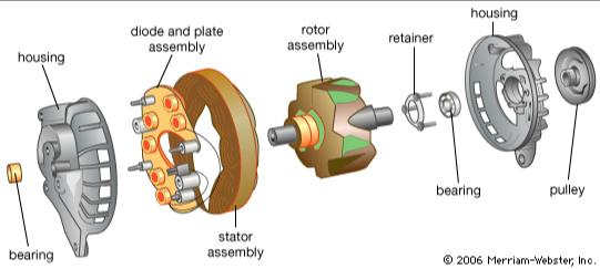

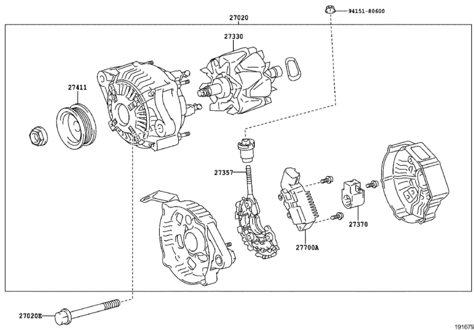

Most alternators use a Diode Trio - two of them, one for the Rotor / Stator regulation circuit, another for the Stators output direct to the output terminal - which is a heavy amp unit and can fail in a myriad of ways.
It is obvious that when you watch the lights dim and hear the blower motor noise drop every time you key up - it should tell you that; at that speed of Idle; the alternator pulley - is not making enough field strength at the ROTOR to get picked up by the STATOR - this gets into a grey area for as some already suggested, you can change the pulley to a smaller size, which doesn't change the pulley belt or the size of the harmonic balancer and pulley - you're changing - shrinking, the size of the Rotor's pulley - so the belt will make the Rotor spin faster - and may bring up the Rotor field to a speed that the stator can see more capture in it's windings to make the diodes see a higher frequency.
Putting on a bigger alternator - you have several ways they do this, more windings in the Stator, Rotor or both and offer a larger Diode Trio to handle the output and even change the charger regulation system to be more sensitive to regulation voltage drops. In any of these cases - you suffer the torque and power losses and dangers associated with them.
