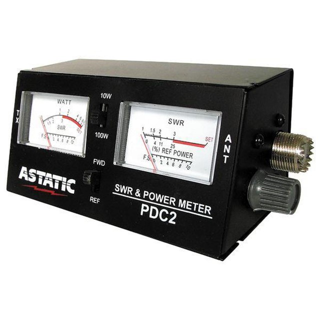

As for a "real watt meter" - I was planning to grab one from a local truck stop. They are about the same price on Amazon / E-bay.
Would this do?
Sorry if I am dumping too many questions at once. I just want to do it right the first time. ;-)
Turning the power down to keep from heating up the amp too quickly is the biggest thing. You could also turn up the AM modulation a little, but you would need a modulation meter or an oscilloscope to keep from turning it up too far.

When you "adjust" AM power? You affect the S/RF meter and AMC - doesn't do much else - if you turn down the radio's output power - your AM power - The radio will not always display your output power correctly - if that doesn't bother you, then proceed.
AMC works off of AM power - if you turn down the power AMC tends to go up a little - not much but a little - best not to adjust that until you've had a chance to put the amp thru its paces working with the 980 then decide...
ALC? That's for SSB, you might want to look on those meters while you check the SSB output into a dummy load on the ANT jack of that meter. This way, when you adjust ALC - 8 watts is MORE than enough power for that little amp. Then connect the amp - and again, using SSB mode, see if heating will be a problem for you and it. If it gets Too hot, back off ALC a little more to help the amp "breathe".
In any case, to prolong the life of your radio, your amp and pretty much any and all of YOUR equipment - keep it conservative as much as you can. There's always a bigger fish, and another day to catch it.
