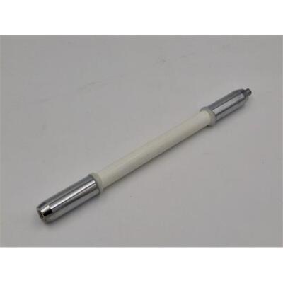

Just wonder what the thoughts are on the ground plane kit for the Imax 2000 antenna. I am just wondering if it made all that much an improvement for you. Looks like the radials are 6ft fiberglass so are a bit shorter than expected so they are wound I suppose. I am used to the older CB antennas like a Super Magnum or the Hygain CLR-2 that had full length metal radials so I am a bit skeptical about any shortened radials. I suppose any radials are better than none but since the add on kit is a bit pricey I thought I'd ask about anyone's experiences with it.

You can get rid of the common mode currents associated to an A-99 or Imax antenna by just hanging 4 108 inch wires down from the grounded base of the antenna. It creates a simple coaxial sleeve to null CMC's. No need to spend money on the so-called groundplane kit.
I initially put up an IMAX 2000 without the ground plane kit and I was getting into the neighbors garage stereo. This is on a 10ft mast, (about 23 feet to the base of the antenna) on top of the garage with a good ground system under the entire area. After installing the ground plane kit, I am no longer heard on the neighbors stereo and the locals say I'm louder. This is a sample size of one and I put the ground plane kit on to try solving a problem and it did.
I ran an original Antron 99 with a GPK when we lived in SoCal back in the 80s. 36' to the base of the antenna. When we moved to Georgia in '95, I put up the A99 w/o the GPK, but with a CMC coax choke. Added the GPK at a later date, but never heard any difference. I imagine the IMAX2000 would be the same.
