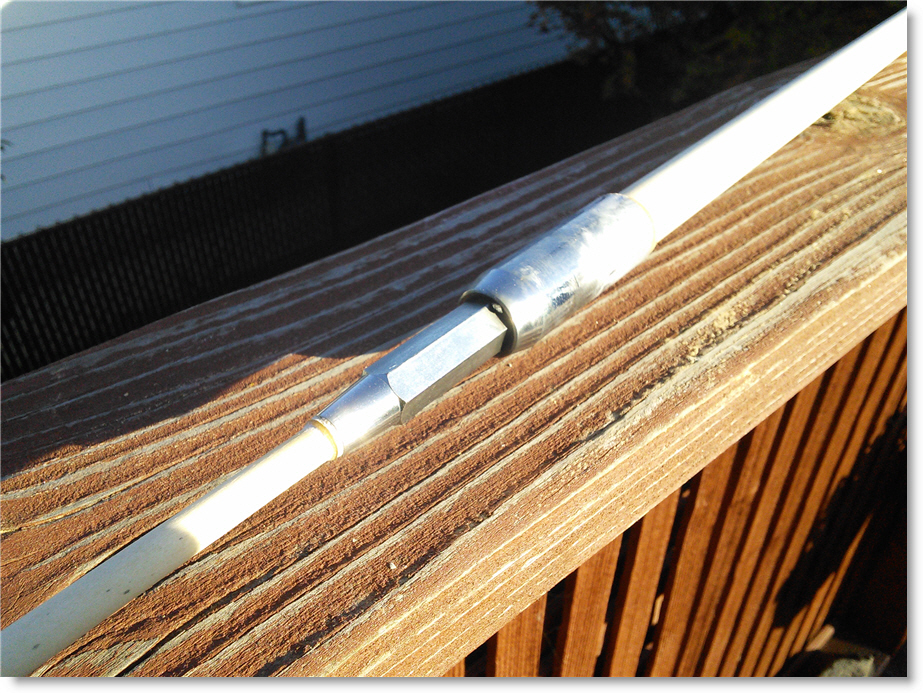

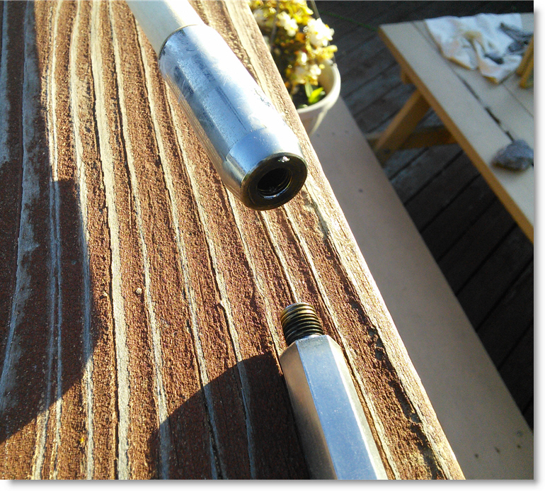

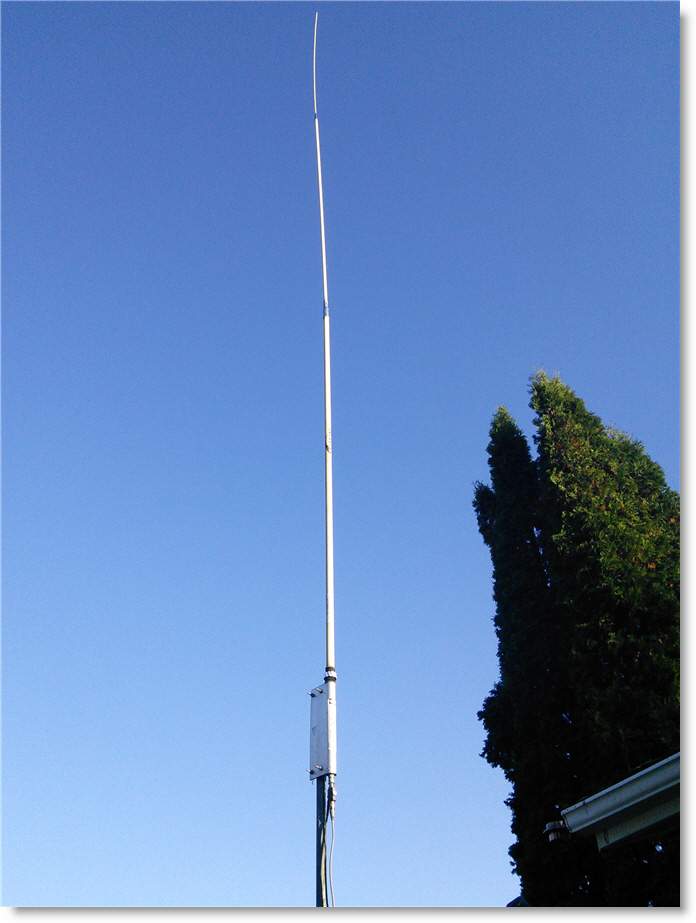

I was forced to do some maintenance on my IMAX 2000 installation. Earlier high winds had unscrewed the top section and threw it to the ground. It was stuck in the ground like a javelin. Fortunately and amazingly no damage was done.
I cleaned up the threads and reattached. I have a bottle of Loctite that I wanted to apply to the threads but go figure, I couldn't find it.
While the antenna was down, I used some automotive cleaners and wax on the fiberglass portions. This antenna has been up for 10 years and in good shape.
Hopefully, I'll get another 10 years out of her.
I've always gone the opposite direction and used no ox id, and torqued her tight. My A99 was up for a few years and I barely got one of the sections loose when I took it down. I dont recall the details but I swore it was going to break.
I wouldn't be able to sleep knowing I put a teflon insulator at an antenna joint, even though I'm sure it would still make contact.
