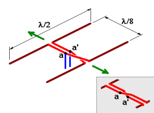

I use a PAIR of "Phased" 80-10 meter Doublets (the W8JK)
They are 124 ft overall (62.5 feet either side of center) 34 ft spacing it is feed with 300 Ohm KW+ rated Ladder line.
I use it on 80 thru 15 meters... @45 foot to center...IT ROCKS!
I have worked MANY members here on this forum.
I have two different tuners...1. a Homebrew version (Double L) I made from an old Dentron MT2000A I bought for $125...the other is the PALSTAR BT1500A (built like a TANK!!!!)
Many other tuners will work...JOHNSON MATCHBOX is a dandy!
Google: Link Coupled Tuner
Any tuner rated at 600 watts or more with a 4:1 balun will perform well
