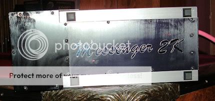

Inside a messenger 2KW (2) drving 16 pills

dont get me wrong it s neat looking coversation piece
and not a bad deal for 1,000.00

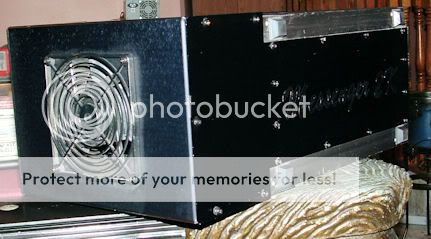

what looks to me it is 2 boxes
one box had all 2290s
then converted to the 2879s.
then the guy bought another box with all 2879s
like taking steps in the upward direction
then he had them combined.
seen it done plenty of times
the plug hanging out the front is the face plate plug
all the switches on the original faceplate has the on and off switch
and the am/ssb switch
and the other switches
then all them tied into a circuit board
then when the front can be removed and just unplug

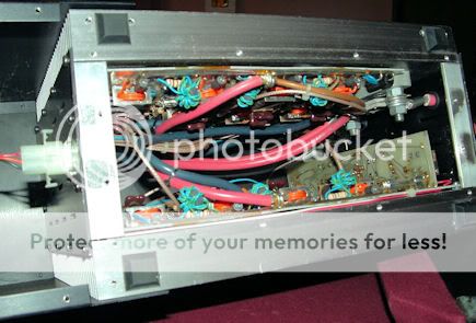

I know I am bringing an old thread but this amplifier was built this way by messenger. i have worked on a few of them like this. The bias design needs a little work. If a pill shorts out and send the voltage from the collector to the base it will back feed to the base of every pill in the amplifier, some of them had a 1n4001 from the input xfmr to ground and some did not. This helped in the case of a short from collector to base.

I still have this amp. It was rebuilt by Justin back in 2005. He said he redid the bias to lean more along the lines of class B. I will take some closeup pics and maybe you can see if the abovemention problem was fixed.
Edit: let me know what areas you would like to see close up that is not shown in the pictures on the first page of this thread.

The original bias scheme that was in the amplifier would drift into class B after few seconds of keying anyway. At east the couple I have worked on did.

You can get a rough idea of the class of operation using an ammeter in series with the amp's power lead. A clamp on type would work too.

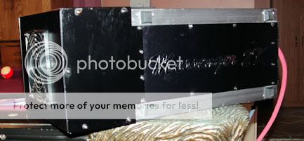

That looks pretty close to the Messenger 2K I have. That is a true Messenger as I believe there were only like 100 of the 2K's built or something close to that anyways. There is a lot of time in building a box like this one. I paid I think $1200.00 for the one I have and purchased it through Messenger back in the 80's. I have never had to do anything to mine yet and it still cracks a lot of Heads and Zips a lot of Lips when you need to.

Yeah they were decent amplifiers. They even have a decent output filter also. I think I have actually worked on 3 of them and seen maybe 4. One of them I worked on the guy had completely disassembled and brought all of the parts to me in a box. He wanted me to rebuild it with what he call "copper boards" I talked him out of it and put it back together using his parts and mounted the heatsinks side by side with a fan cooled case. I will tell you this. They are a bitch to just simply work on, you have to take all kinds of shit loose just to get to the inside.
Yes they are a bitch to disassemble. You gotta actually unsolder the coax going to the so239S before you can open it. Also, I retapped ALL the sheet metal screw threads on my messenger 2kw and converted to metric. That way, i wouldnt worry about wearing out the threads or the screw coming loose with the sheet metal type screws.
Just to think that some "amp builders" would use sheet metal screws to secure the pills.....Damn!
