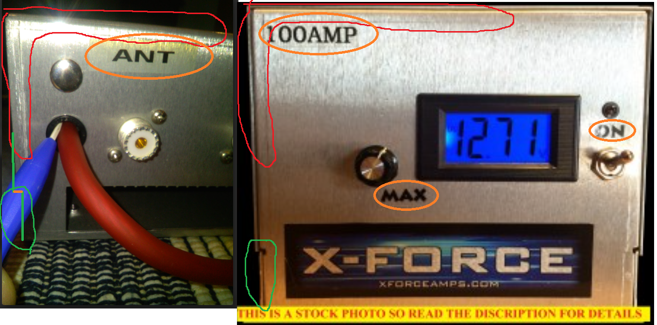

At the very least put a zip tie on that wire until you can get a proper strain relief.
That power wire is not soldered down well.

I would add that if the amp is installed properly and bolted down and the wires are ran properly there should be a very low chance of a strain guage being needed even if it is clearly best practice. Anyone that has worked in car audio, 2-way-radio, or as a mechanic have seen how poorly people install electrical and electronic gear in car's and trucks! Bad construction methods and installation practices have burnt peoples trucks to the ground!
strain guage?
I agree it looks pretty typical for a lot of CB amps like this going back many years.
With a decent install, I doubt the cable will move around to cause any problems. Now, if you just toss the amp in the back of your SUV / car / truck and floor it at every stop light with this thing sliding around then it may be a problem, eventually, but if the amp is secure and wiring ran decently and also secured, should be fine.
The ferrite could have been secured with a zip tie, I would have at least done that, but probably not much of an issue here.
If you run it as a base amplifier, no worries whatsoever.
Could it be better, absolutely, but can’t expect the world from CB amps like this. I don't see anything surprising that I haven't seen over the last 20 years with this style amp, looks pretty normal actually.
