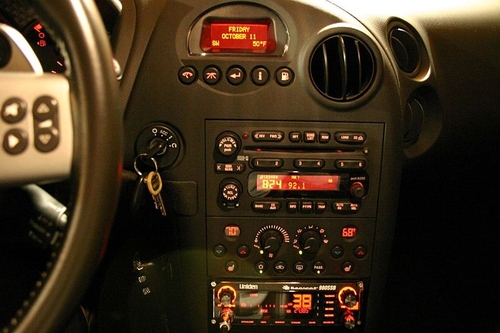

You might like one of the new bearcats. The color can be set to match your Kenwood. They are a great choice for in dash factory look. Here is a pic of mine with Pontiac's red lighting in my GXP. It should fit nicely in your space. May need a slight modification as they are not designed for in dash, but are very close to a din size unit.
Really cool install and looks great in your dash, but I think he's already said he's happy with the 510.

I actually originally wanted a bear cat. I thought they were a lot smaller than they are. I would have returned it before cutting my dash. A replaceable aftermarket din pocket is one thing, but im sure the fake wood grain is a pretty penny. The 510 actually matches my factory controls a lot better than my kenwood too, as they are all green.
