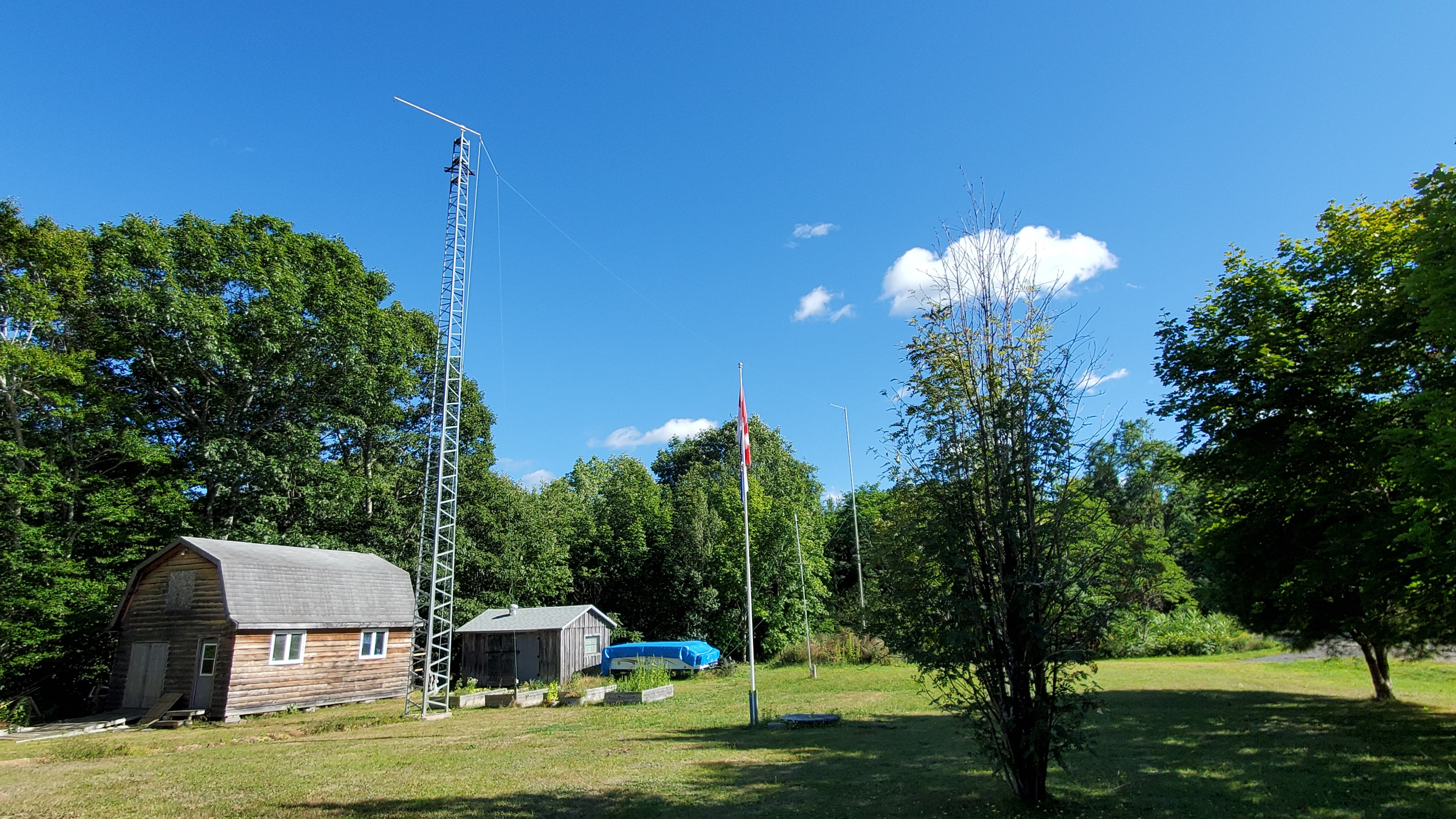

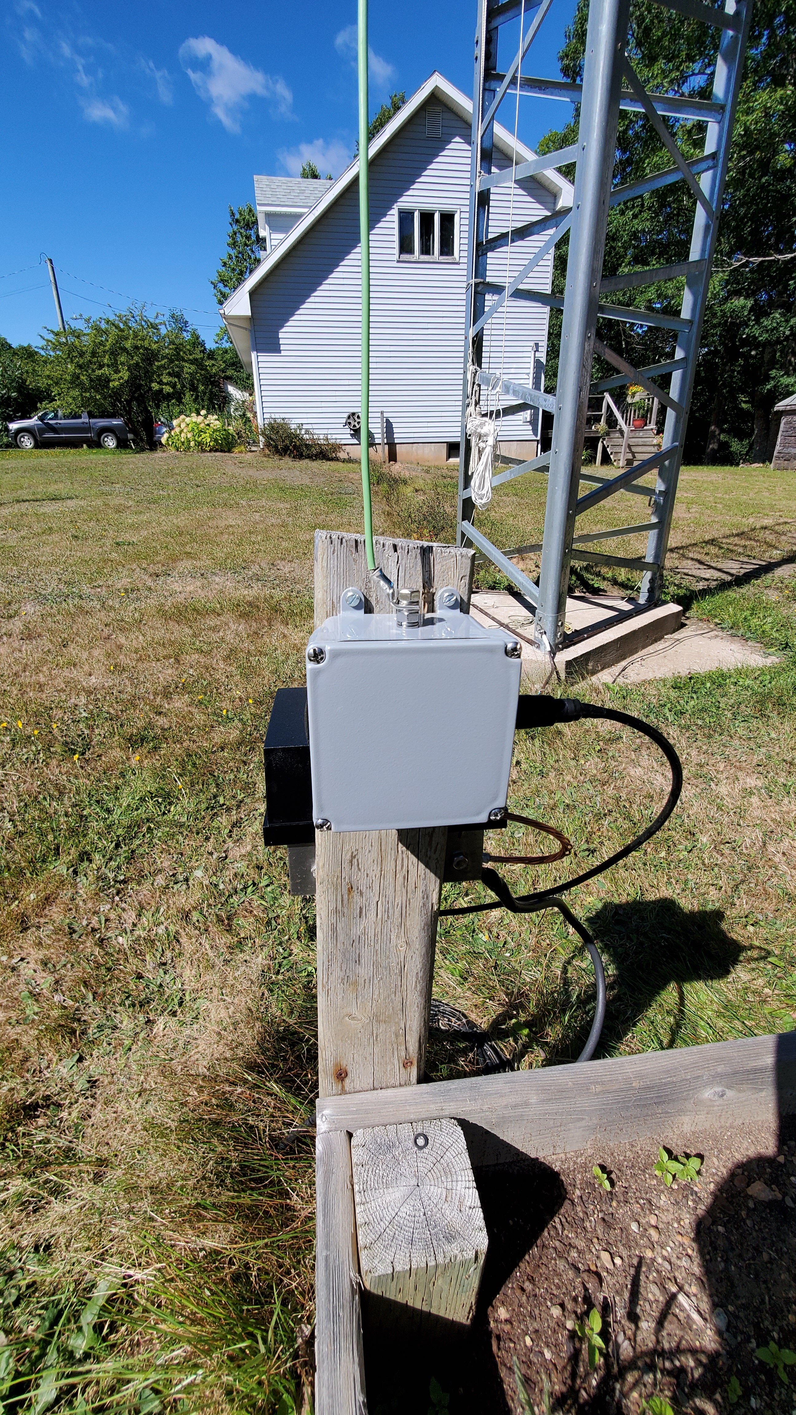

Hunh?? Protect the wire? What are you talking about? My wire is insulated now, but my previous one was not. Makes no difference anyway. My wire goes basically straight up from the transformer to an egg insulator where it is free to slide inside of and then continues horizontally to the far end. I have a halyard off my tower about 8 feet away connected to the other end of that egg insulator.
j
You can see the wire in the bottom image as it goes up and over to the mast at the far end. Total length was somewhere around 135 feet, maybe a little less. Basically a half wave at 80m. You can play with length slightly to move your resonance points.
